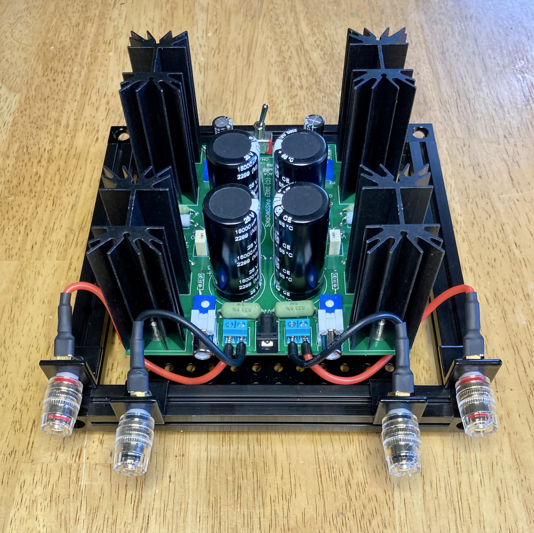

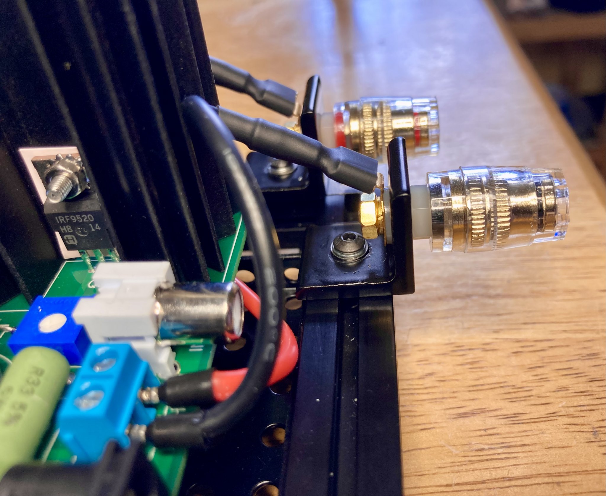

I added binding posts to the ACA Mini I built as a gift for someone. I like this a lot.

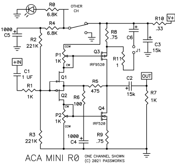

resistor going from input gate up, in parallel with resistor going from input gate down
if you post/point to schematic at which you're looking at, I can give you parts by nomenclature 🙂
Thank you for the help! It's very nice of you to help me learn to fish, rather than just throwing me a trout. ;-)
My guess is that you're referring to R2 and R3, and that they're in parallel, so it would be ~110k ohms. (except R4 adds a bit to R2, I would think.
Am I on the right track?
Thanks again!
Pete
Rin=R1+(R2//R3)
R4 doesn't play, nulled with C5 action
Okay, I will need to learn more about R4 being nulled, and I see that I forgot to add in R1, but I'm somewhat heartened to see that my uneducated guess was close.
This is an unusually high input impedance for a transistor amp, isn't it? I'm not complaining - it will make it easier to play with different passive volume controls, like TVC, LDR, and the 10k pot suggested above.
Thank you again.
