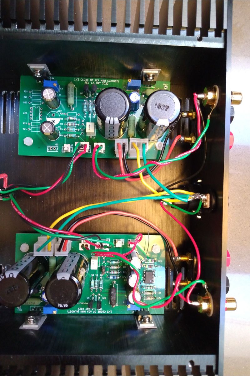

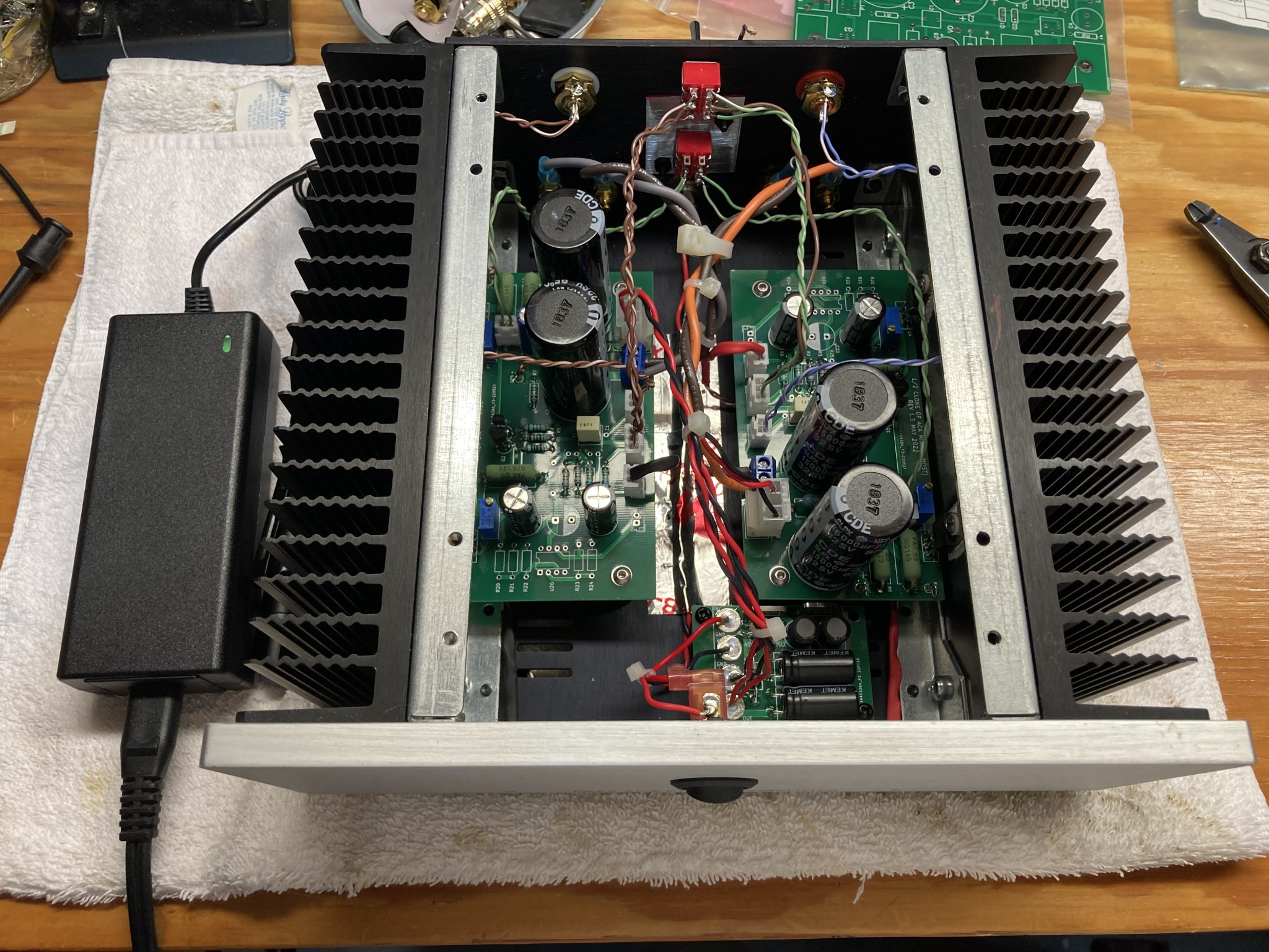

A tale of two mini‘s elegant papa design and a steampunk version.

You do realize those are wildly different circuit designs? You do realize they MUST be different circuit designs, else the same amount of heatsinking would be required on both. Which clearly, from your photos, is not so. Conclusion: they aren't the same circuit.
Nope, it is the same circuit, but cut in half and layed out to mono boards, obviously requiring different heat sinks. But it is the same schematic as Papa created.....with one optional unused addition in this case and multi turn pots instead of the single turn pots. I have one, too.
Wow, thanks for the explanation. Take the design that needs extremely little heatsinking, enabling extremely inexpensive enclosure/chassis, . . . . but put it into a not inexpensive enclosure with wild excess gobs of heatsinking. Okay.
Not completely unlike installing a cool running class-AB amplifier into a Modushop Deluxe 4U chassis with ginormous bohunker heatsinks, to be fair.

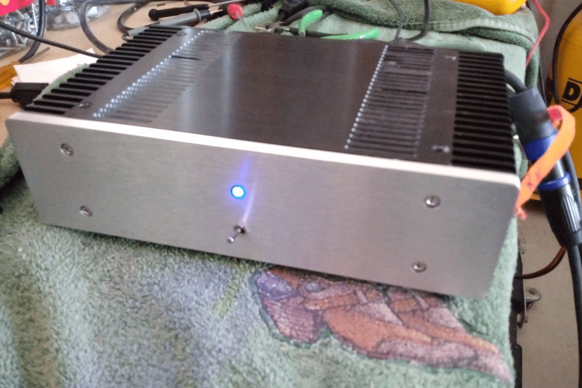

Yeah. It costs more.. but.. it looks cool and is easier and safer to handle... and still costs a good amount less than a standard ACA. FYI, Bubba177 used a chassis bought cheap as part of a non functional ACA. My chassis cost about $60 including shipping. It's DIY. We make what we like, not what's the cheapest. 🙂 I could not see putting a less than good looking amp or some kind of chassis kludge on my office shelf!
I like the case. It is still small and very nice looking. Also, it's going to be hard to keep the cost under $60 if you are actually using a chassis.
Well, things have changed in a month. It now runs about $100 with shipping. I bought two when I got mine so I could run a pair in bridged mode. Shipping was $75 for two. It is now more than that for 1. :-( But still less than a 2U Mini Dissipante used in the ACA. One important caveat. You need to mill or drill your own vent holes. This unit has none as is. https://www.aliexpress.com/item/2251832837354663.html?spm=a2g0o.order_list.0.0.29e11802OWBDJA
Still not terrible. I was looking into a Chinese chassis for a project that I want to do. Shipping has gotten so expensive that it now ends up making some items cost-prohibitive. Thank you for sharing your project 🙂
Yeah, even at $100 it's $50 less than an ACA case, a bit smaller (64x150x180 internal vs 80x150x200 internal) but plenty big! You can build an ACA Mini in a nice case for $75 ish less than a regular ACA.

I'm gonna post my own thread on the build as soon as I get the time. I'm on rev 3 of the boards right now. Pictures are rev 2 which work great but rev 3 is improved for ease of build and also fixes a problem in the bridge inverter that required a workaround in r2.

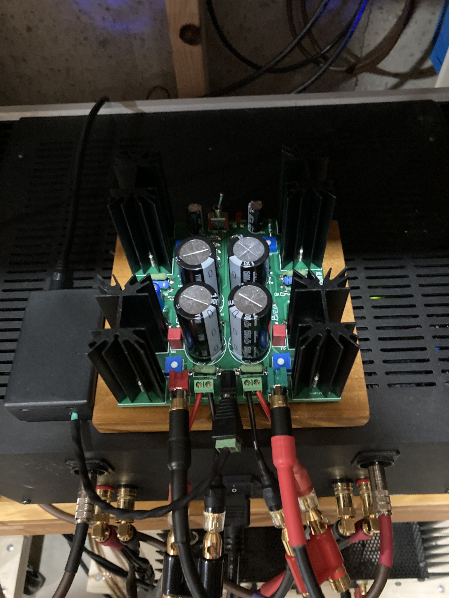

I could use some troubleshooting assistance. I got the kit from the store (both parts) and put it together last weekend. It was working well, sounded great. I turned it on tonight and it plays distorted for a second, then okay, with the led dimming in the same rhythm - as though the power supply is pulsing. I actually got two sets of kits so I tried out the unused power supply, but got the same result. Any troubleshooting suggestions will be much appreciated. Thanks in advance.
