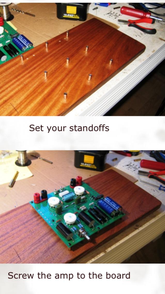

Codyt, any possibility you might make some single chanel boards ? I asked earlier if this amp would work with laterals and Nelson said go for it so I was thinking of building this amp in a gutted Halfler DH220 case. I figure having a negative temperature coeficent I wouldn't even need the source reistors if I used laterals.
The old DH-220 case is a perfect size for this amp. If you have a set of the Hafler matched lateral Mosfets, you can leave them installed in the heatsink flanges. (Clean and apply fresh thermal grease.) The laterals will need a lower Vds to turn on, and can certainly get by with less source resistance.
Put one of these inside the chassis and you’re off to the races. Should work perfectly and sound fantastic.
I hadn’t really considered doing a layout for the circuit itself, but who knows. That said, Jim’s suggestion is a good one.

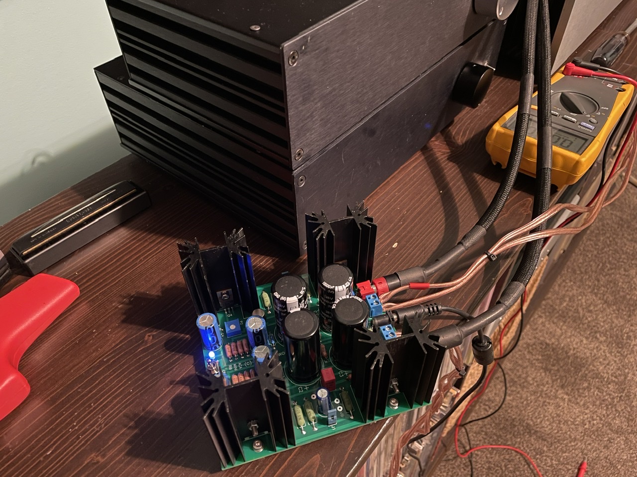

Got mine today. Unfortunately, I’m off to travel to Albuquerque to see the ballet this weekend, so no time to build. Work still interrupts my days, so this little project will have to wait until next weekend (or some evening this week if I can muster the focus).
Looks like it will be fun!
Dang, this thing sounds good! Thanks again to Nelson and BAF for the opportunity to win and build one of these.
So far I’m preferring the jumper in. Really fun to change on the fly! Hope to makes some measurements soon.
