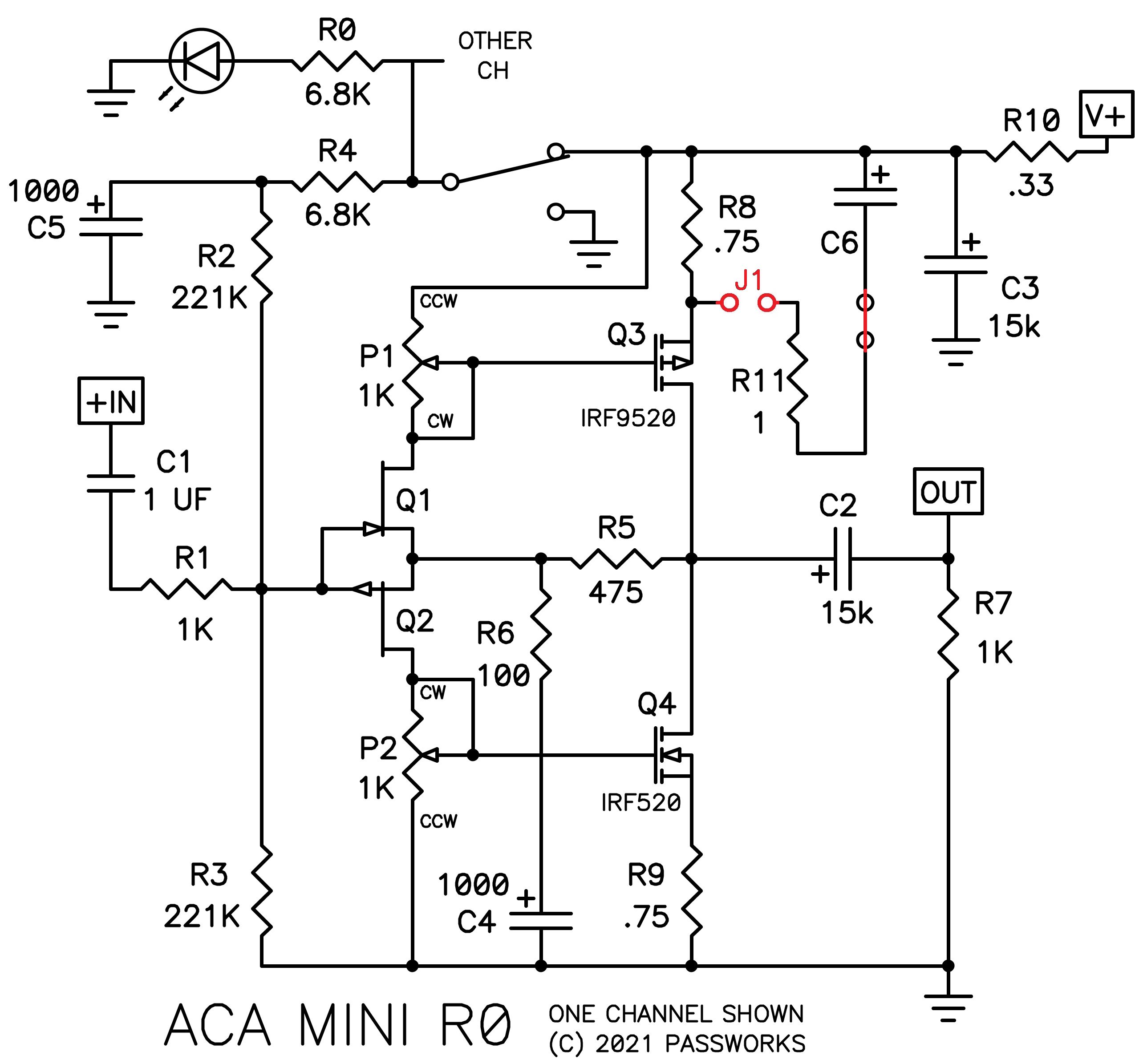

That sounds again like a fabulous little project... and Jim's guide is top, as ever!
I have been trough the doc but couldn't find the precise total power consumption / ampere draw. OK, following the SMPS, it will obviously be "quite less than 90W and 3.75A", but what is it precisely? The next SMPS down the same product line is 2.5A...

If I follow Nelson's writing, each of the four sinks sinks about 5 watts, there will be a consumption of slightly above 20 watts. Even if there are a few watts being lost by resistors, it should be well below 30 watts.
Thanks for your kind reply... yep, based on the heatsinks and resistors I came aswell to 30W.

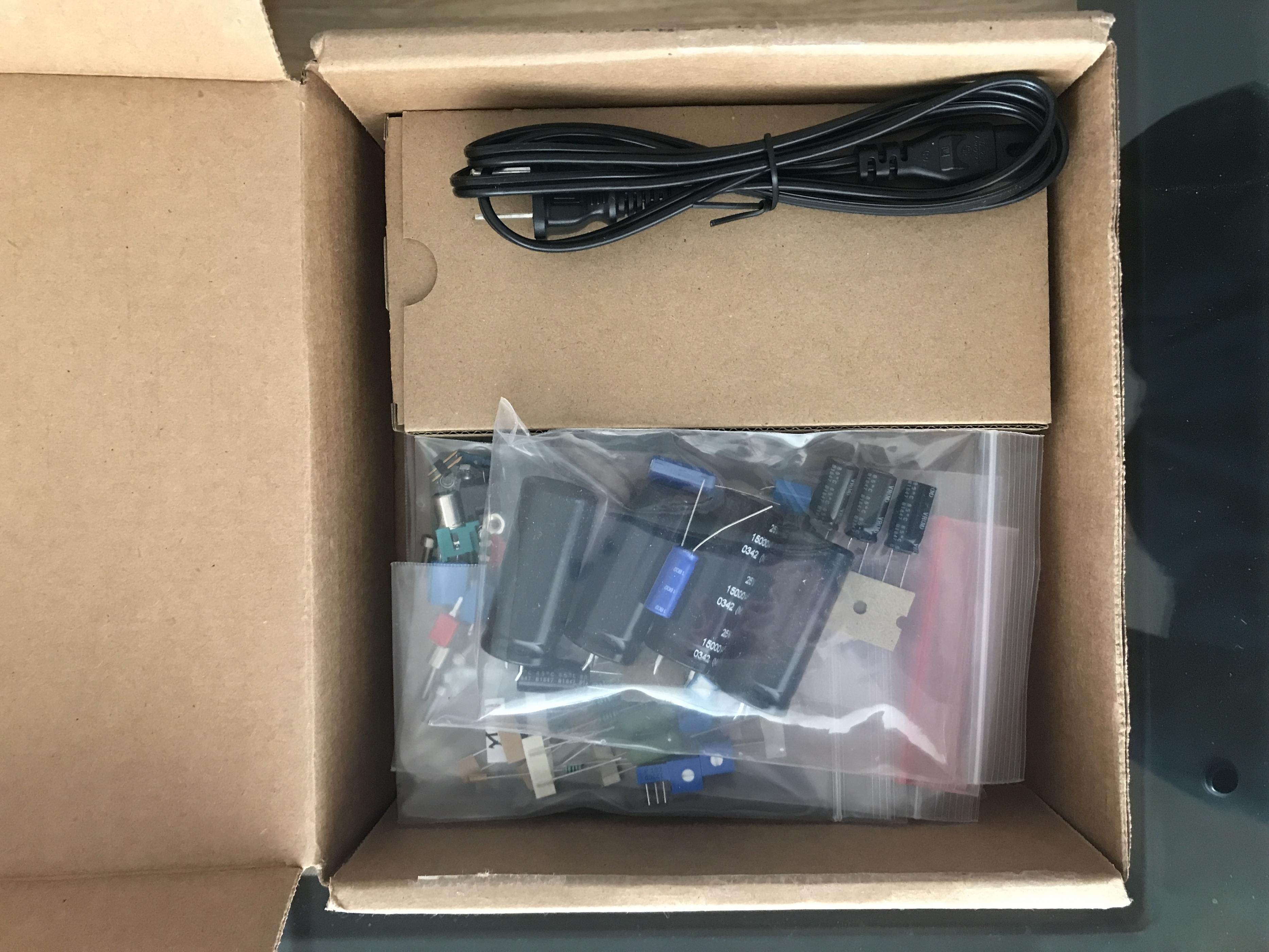

That’s not the guide, just some photos that I took when building. I can get some work done on the guide in a week or so when I return from my trip.
With 0.31v bias my meter is showing 26w current draw from the wall (N. American mains, 120V 60Hz)
Yes, this is a great candidate to try Mark Johnson’s PO89ZB inline SMPS filter, it seems to always be beneficial, even with the excellent Mean Well bricks.
estimated
24V (psu) x 0,4A (bias) = 9,6W x 2 channel gives around 20W.........
You can reasonably bias it to .5 amps, if you are adventurous.
