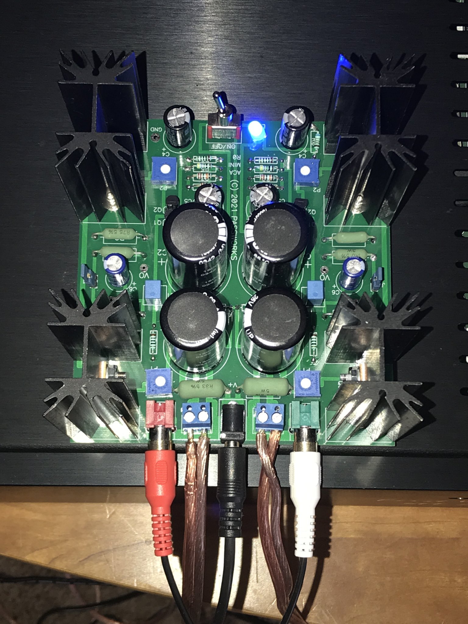

They will be available to the first 100 people who purchase them. I've been playing with mine for the last week. It's currently powering my 15" TAD woofers. I'm amazed by the control this little 5W amp exhibits! and it looks pretty cool all undressed. Haha!
I subsituted a blue LED in keeping with the First Watt decor of my listening room. And yes, I know. I installed my SPDT switch backwards...View attachment 1074075
Yep! glad you noticed. Same deal here, I have altec 416-8b and the bass is amazing. For 5w? WOW!

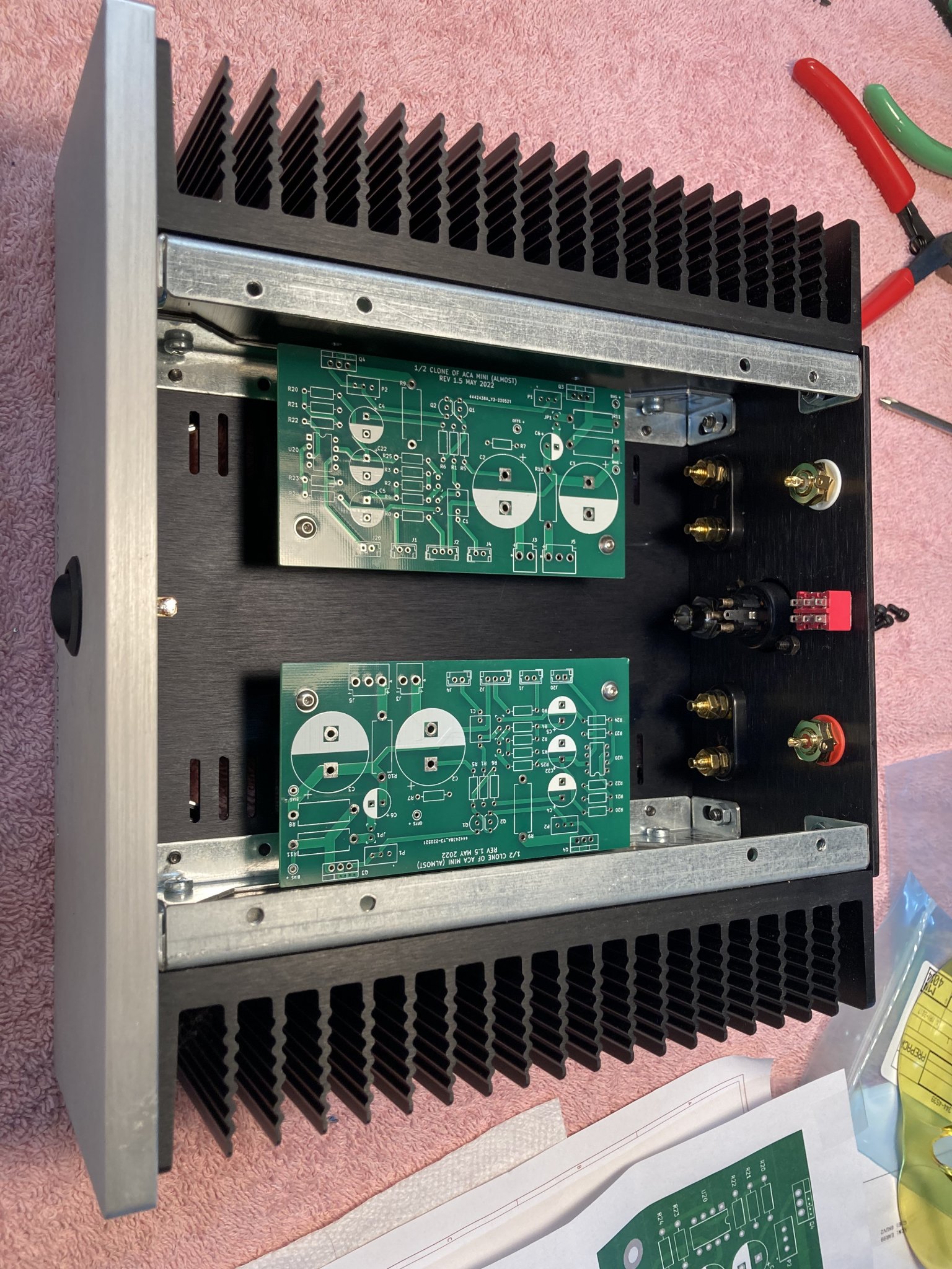

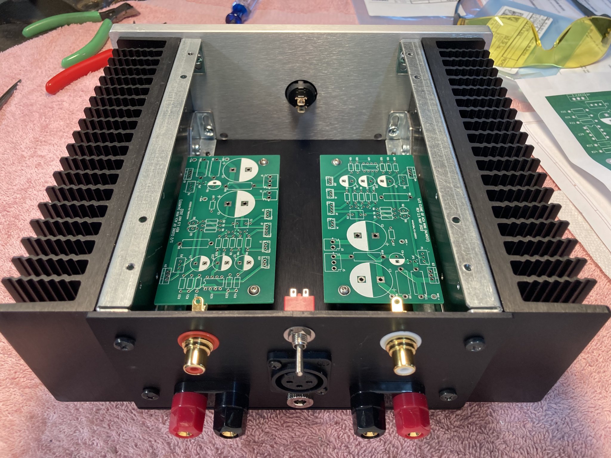

I bought a non working aca amp from eBay for the chassis. I am putting a mono aca mini in it and have a question about the power switch. I wish to use the original switch for aesthetics, but that means I have to turn the amp completely on and off, no “stand by mode”. Will the humps,bumps,and thumps be intolerable? I plan on using the dpdt switch on back for switching the jumpers in and out. Anyone have a clever solution that I can’t see? Thanks for any help!

The latest switching supplies we have from SL Power work great, but they occasionally have issues with power-up into the ACA mini power filter if the AC power is applied when the front stand-by switch is in the ON position. This is because the circuits of the switching supply test for the load value before committing to full power, and between the current draw of charging the big capacitors plus the bias on the amp the power supply might decide that there is a fault in the load.
This does not occur if the stand-by switch is in the "off" position when you apply AC power to the power supply. To avoid confusion, the switch is "off" when the toggle is to the left (as seen front the front). If the LED lights up continuously, you're fine. If it is pulsing, then the supply is not turning on properly.
Intended normal operation would have the switching supply always on (very little draw) and the front panel switch is used as the on/off switch.
If you give the supply a few seconds of AC before throwing the switch it works fine. If you fire it up the AC with the switch on and the light is pulsing, then you can turn the switch off, wait a few seconds and turn it on again, and it should be fine.
None of this affects the sonic performance. If you find this annoying, I will deliver a fix which involves changing a resistor value...
Use the nice looking power switch to control a DPDT relay to mimic the normal bias supply switch(es). DPDT because you're actually switching two different bias supplies with the two mono boards. Or.. if you want to custom wire that setup as well you could share the bias supply sourced from one channel as is done in the stereo ACA Mini and only need an SPDT relay.
Thanks for the information Mr. Pass. I will use front switch to turn on power to unit and leave it on, delete the xlr, mount a small plate, drill it and add another dpdt switch for the bias. Came to me last night during a fitful nights sleep. Just now ordered the kit from the store. Thank you very much!

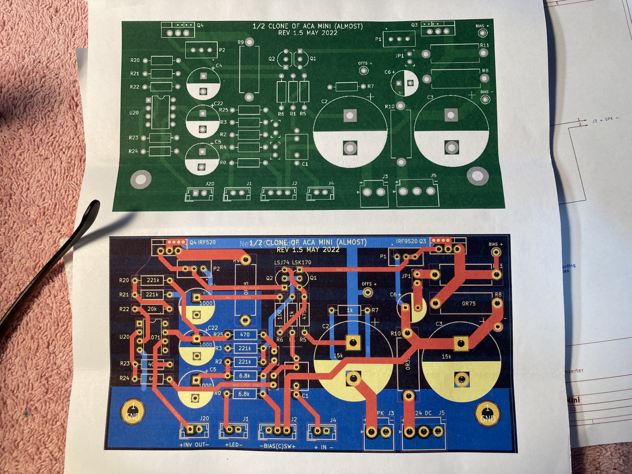

Check the BOM vs the schematic against the completion kit if that is what you ordered. The mono boards use different trim pots and could need an extra 6,.8k Ohm depending on how you choose to wire the bias and LED(s).
