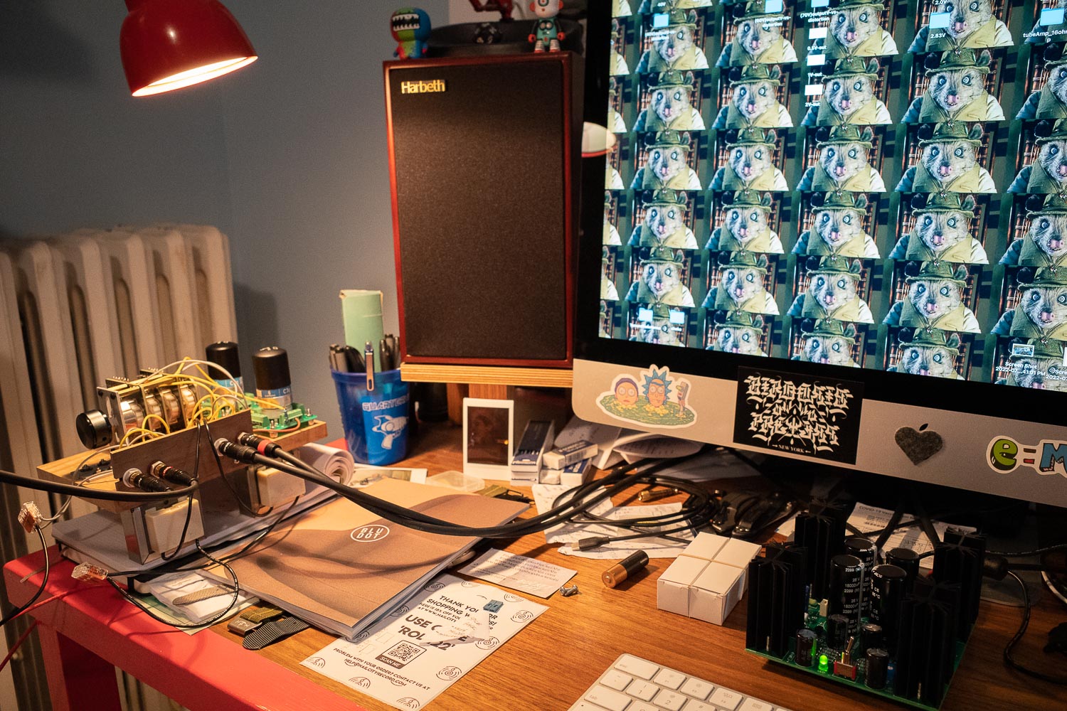

Here it is nude making some music. Matches my bread-boarded preamp. I'll probably knock up a case some day, but for now this is a great little setup. Matches my clutter 🙂
Thanks for the advice about warm up. So just like other solid state amps.
I only have a couple of hours listening to this thing. And that is through a pair of Advent OLAs, not exactly efficient. But this little amp doesn't care, it is playing beautifully. What strikes me is not what is there, but what is not. There is just music. The music seems so pure that it feels enshrouded in a quiet majesty and dignity. It lifts my heart. Thank you, Mr. Pass.

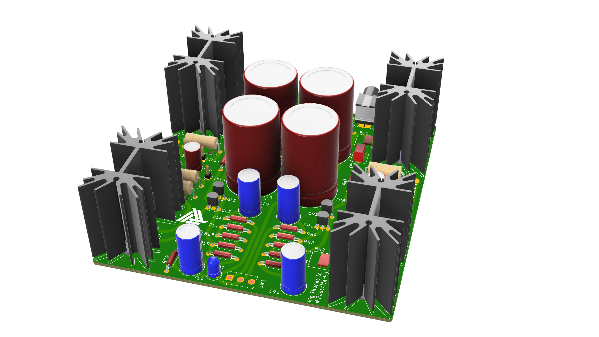

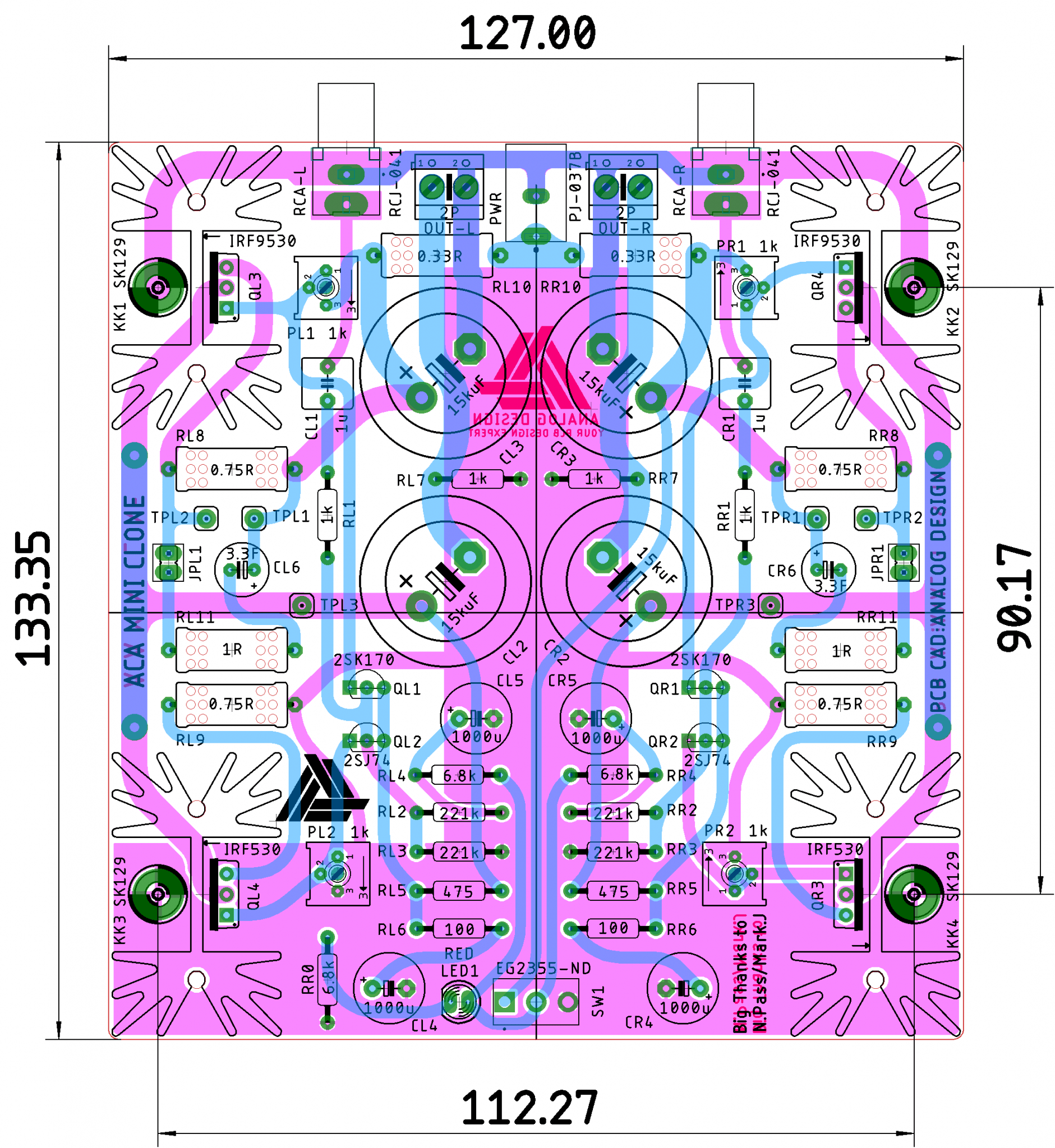

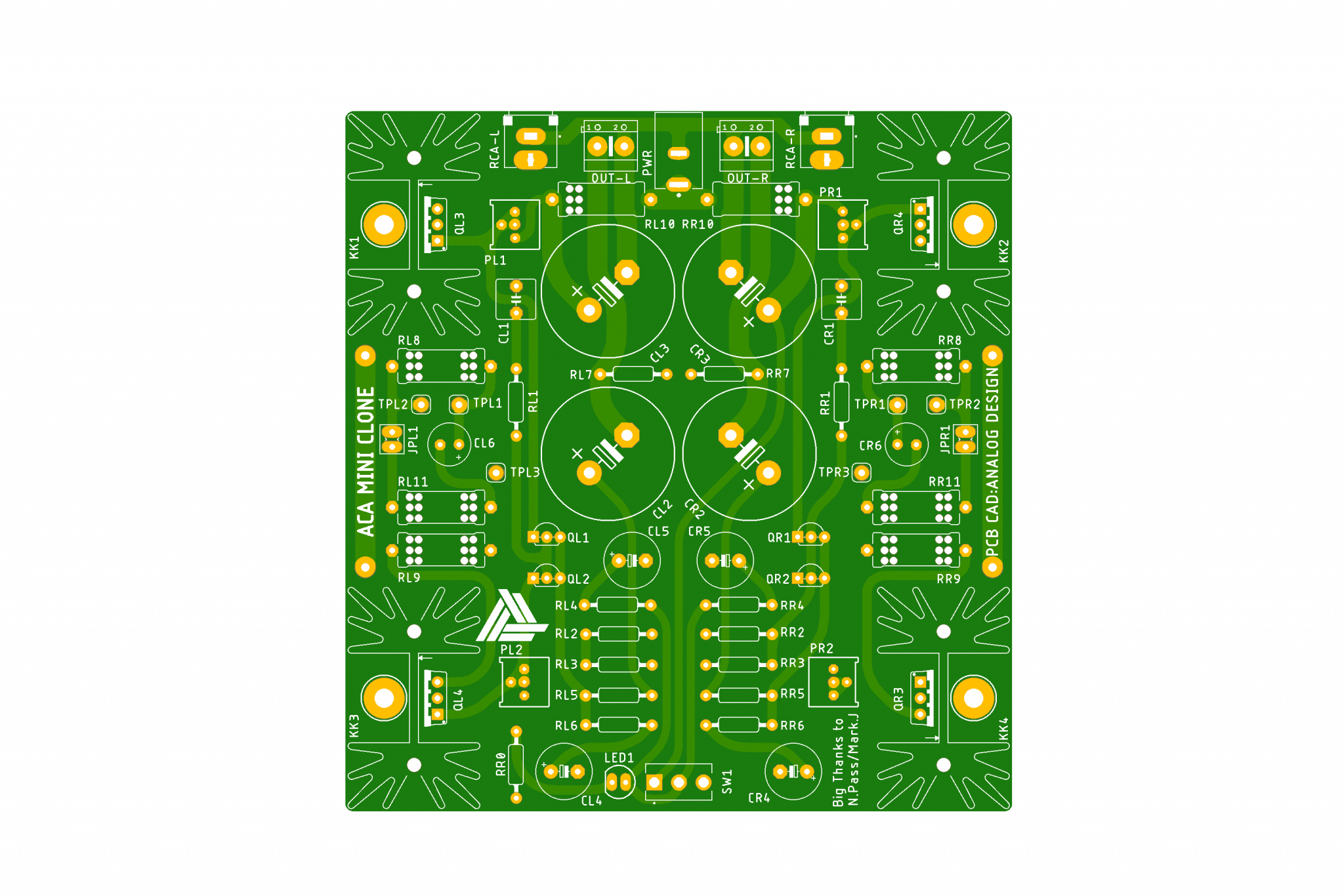

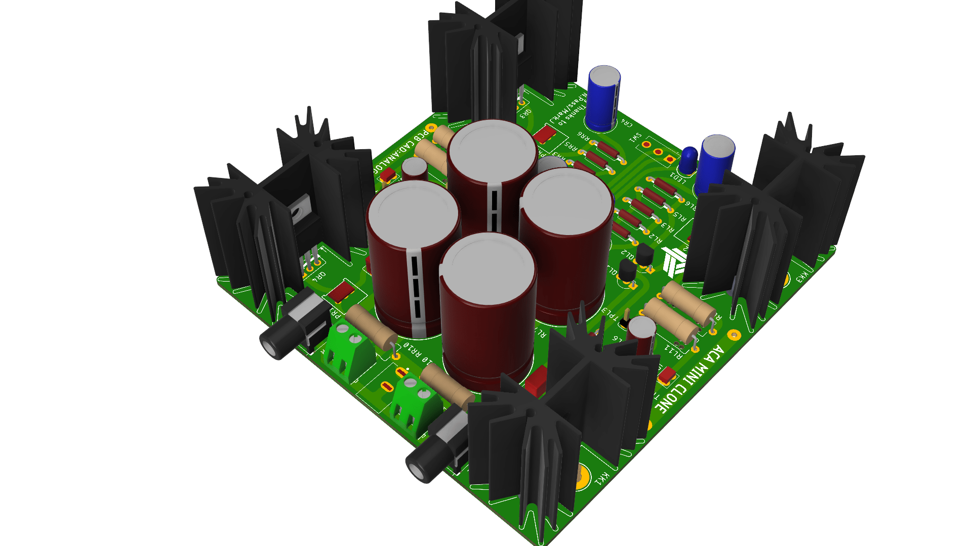

Taking some inspiration from Mark and his words of encouragement, I went ahead and instigated a board layout of my own .
I like how Mark Johnson tries to give us confidence to go the extra mile in this hobby; by getting boards made using gerbers, or indeed getting one of the very talented layout designers available to us on the forum to set out a PCB.
So I approached @prasi if he would be interested in a little project for me and he kindly obliged and at a very reasonable cost.
Here is what we(he!) came up with . I have sent the files to JLCPCB and am having a small run made, in black! Once I have them and have made one up and tested I shall offer the rest for sale, at a price only to cover my costs. I am not wanting to make money on this.
I have some Harris devices and the input Toshiba's are on their way from punkydawgs.
Thanks to NP and MJ and of course Prasi for getting me this far with my ACA Mini.

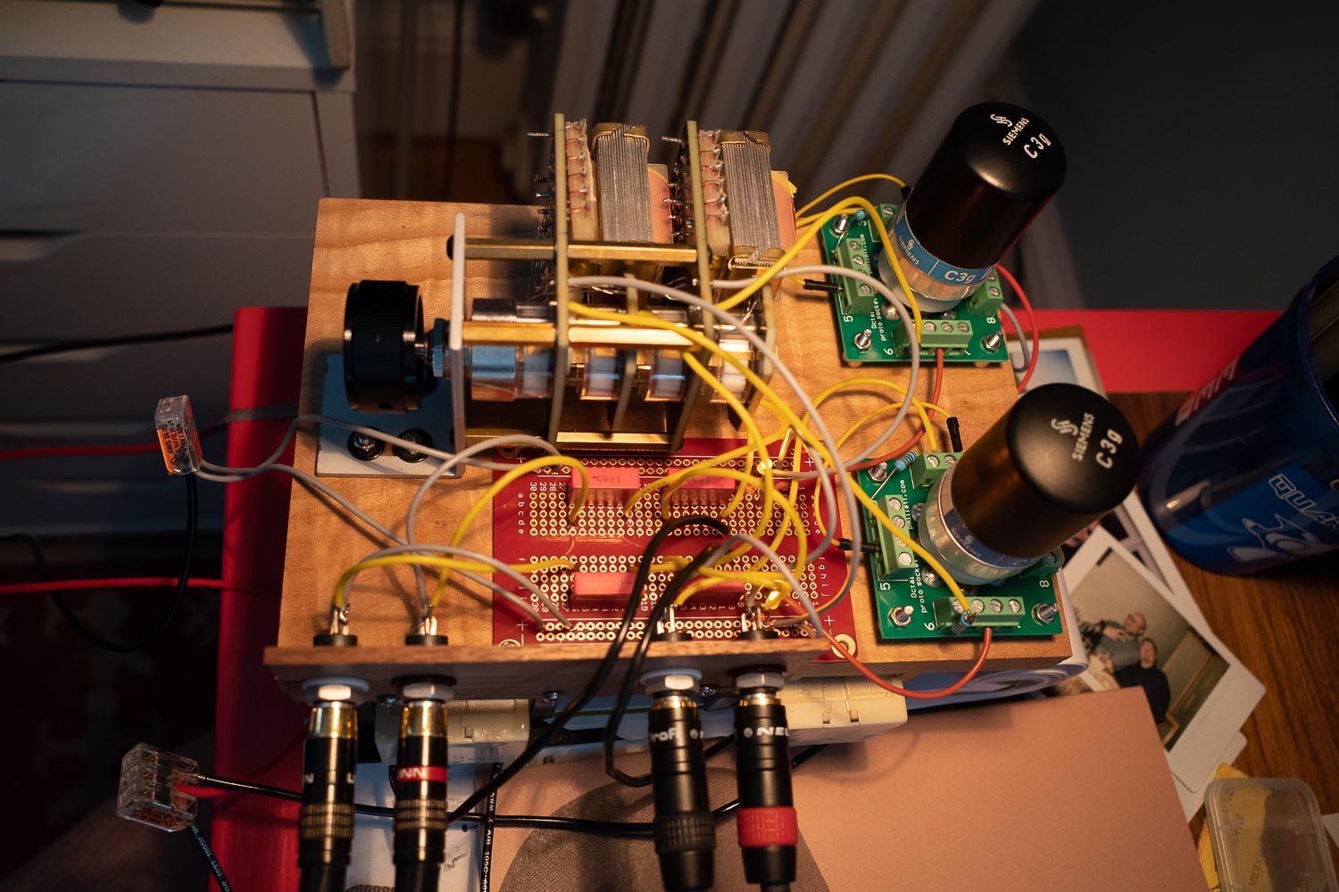

Triode connected. 140V B+ and -2V bias (yellow LED). Around 10ma or so. Played with a bunch of operating points, and honestly more current didn't really lower the distortion too much. It's around .02% all 2nd. I've had these tubes for like 20+ years and finally got around to playing with them! Crazy how simple it is to slap something like this together. Was doing the same thing w/ 2sk79s as well (same setup). Was going to post a thread for that eventually. Very similar sound between them. Difference being that the 2sk79s had negative phase 2nd where these tubes have positive phase.
Reactions: nicoch58
Thanks! I was going to ask. When using transformers (which I also was testing), it was as simple as flipping the phase on the output so that it was negative. I didn't know if I needed to change anything else. I didn't notice any load lines that resulted in negative phase, but with the tubes I didn't try many options. I'll have to experiment more. The 2sk79s were negative phase in all voltages and operating points I tried (probably 10-12 different permutations).
