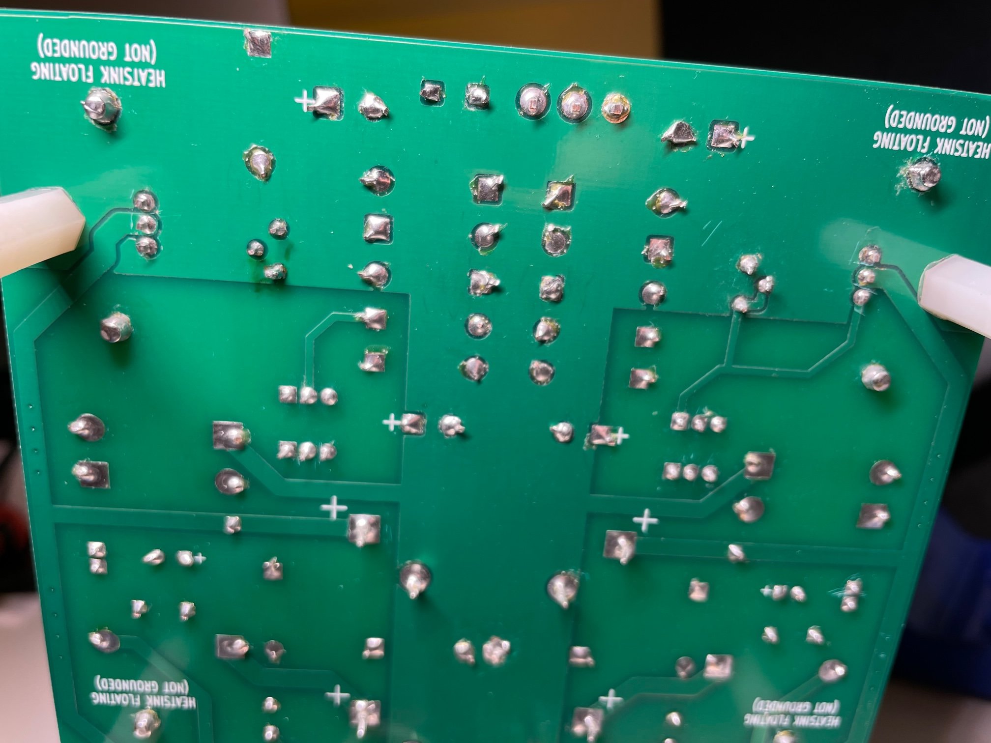

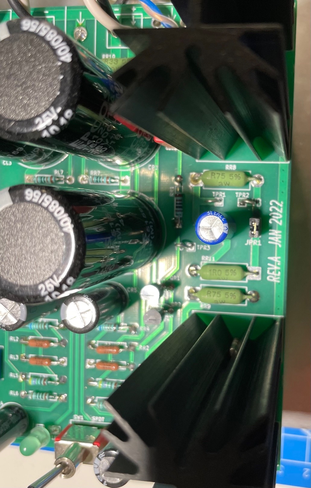

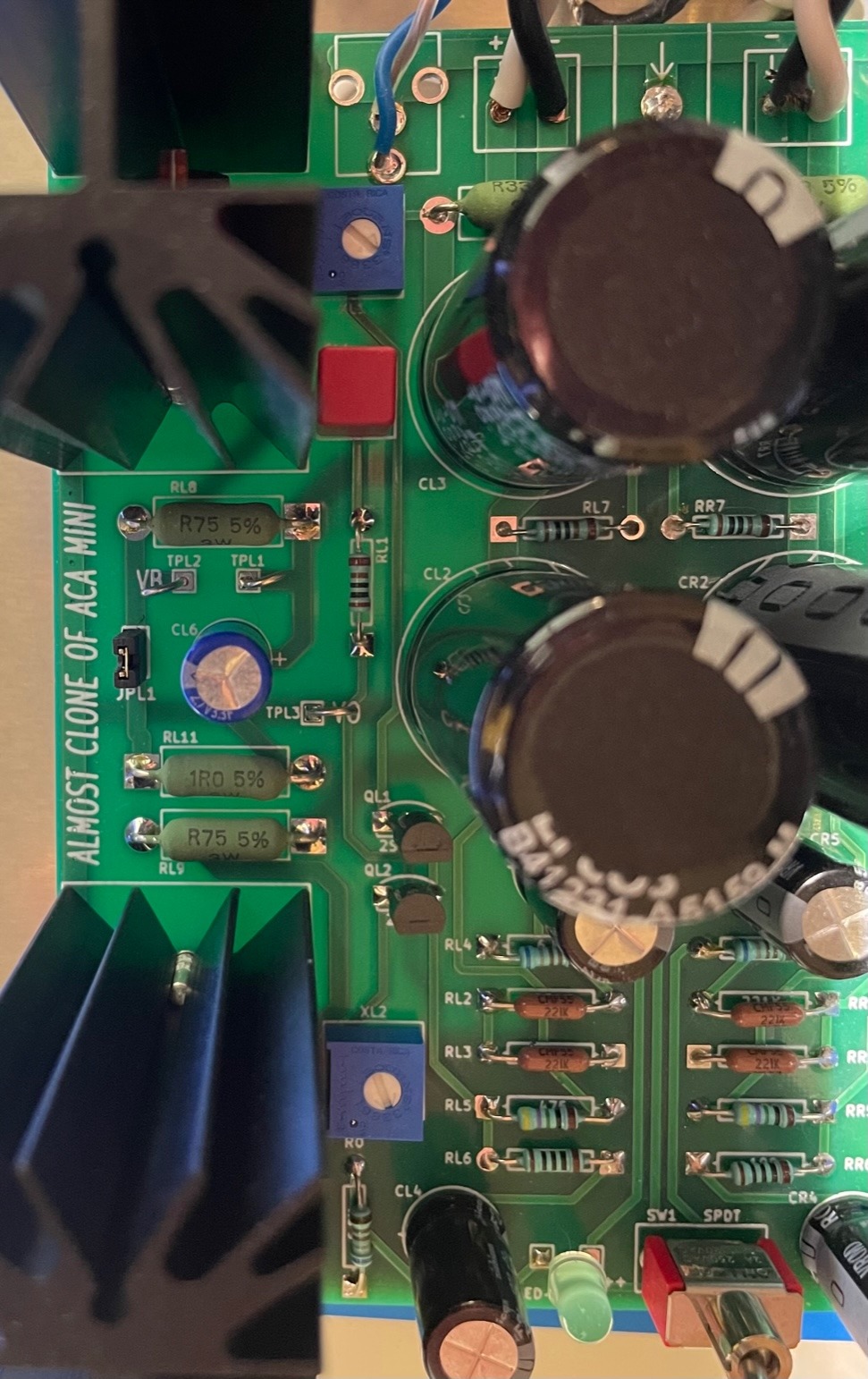

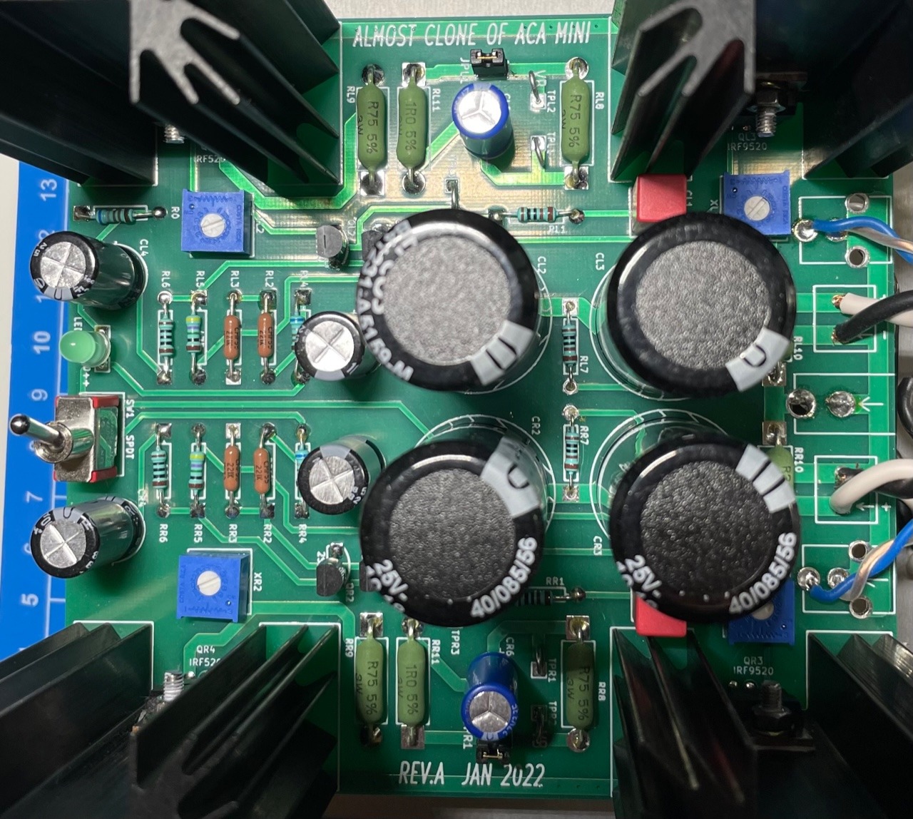

DC offset question.
On my unit (almost ACA clone board), when I turn the bias switch on, DC offset jumps to 5.6V and then slowly falls down to about 20mV over the next few minutes. When I turn the bias switch off, offset jumps again (to just over -5V) before again settling down over the next few minutes.
Are these jumps expected? If not, what should I look at? Thanks!
That doesn’t seem right to me. I have never heard any turn on or off thumps with my Almost Clone ACA mini. I think you might have an uncommon situation. What is your source? Maybe it has DC on the outputs?

That's a shame. 5V spike seems like a lot, and slowly dissipating, too. I don't know enough to say look one place or another. :scratch: Did you get the fairchild outputs? Any substitutions in your order deviating from the BOM?
Other more knowledgeable members could likely help you troubleshoot. This amp is art in simplicity and quality, it would be unfortunate to have to add a delay circuit to it.
Harris, right. Friday brain... 😀
Good point about the BOM.
I have an external speaker switch I've used for projects I knew were offset bombs for power on and off transients.
The P089ZB is your only known variable to me. I have some of those but don't use one with my ACA Mini. That may be the culprit. Did you use the amp without it at all?

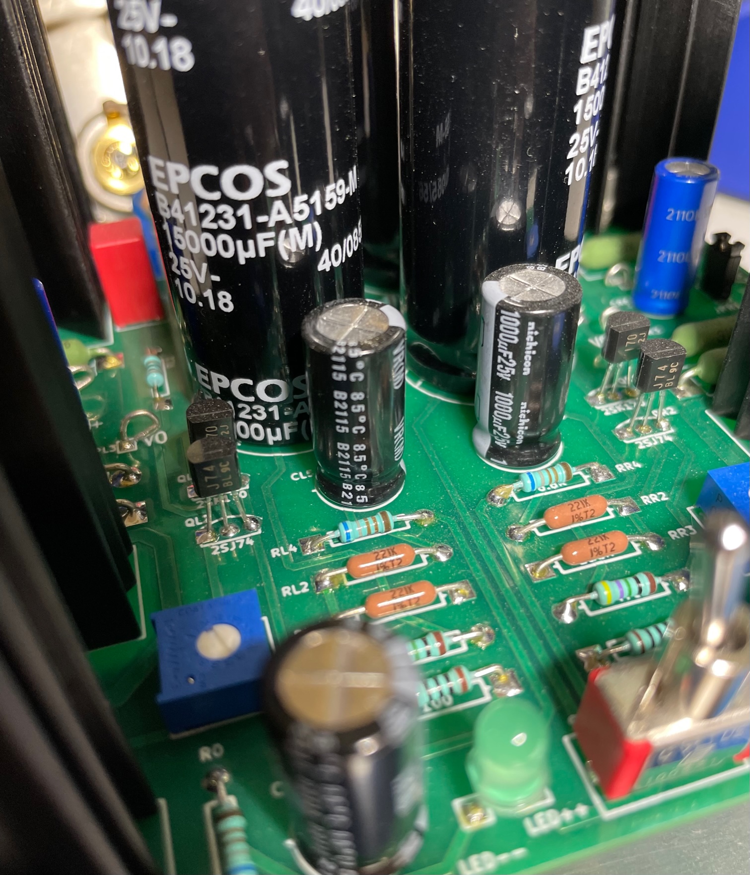

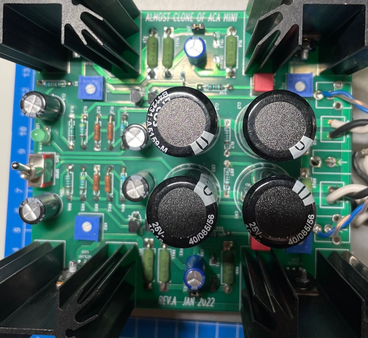

Please check CL5, CR5 they should each be 1000uF, are they on your pcb and well soldered ?
Yup, they're 1000uF. I looked over the solder joints and see nothing questionable - and since the behavior is the same on both channels it's unlikely the exact same bad solder was done twice. But I dunno, maybe I'm missing something?

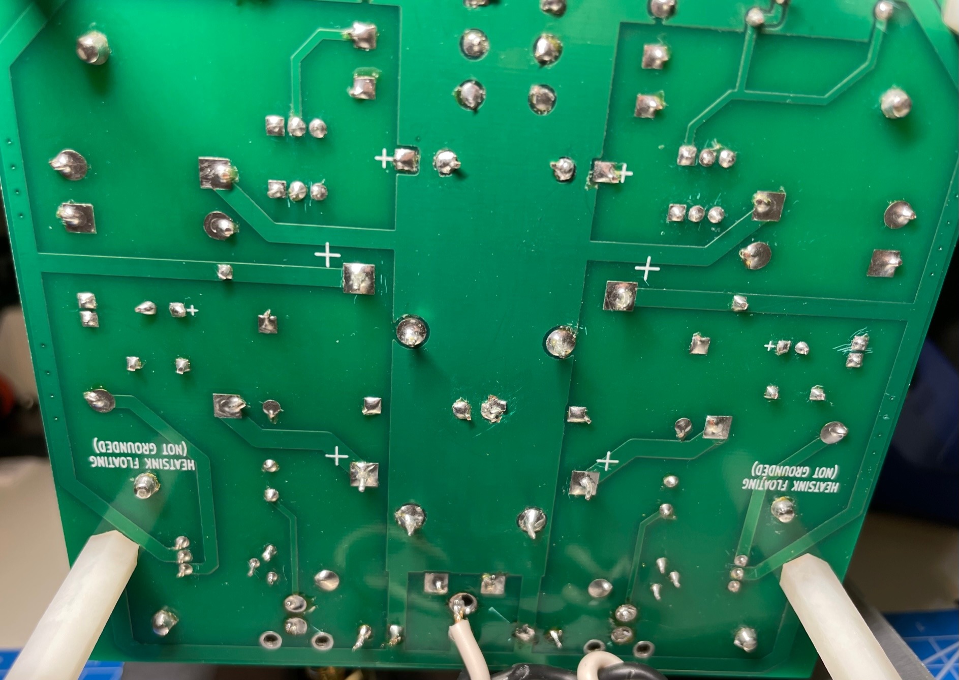

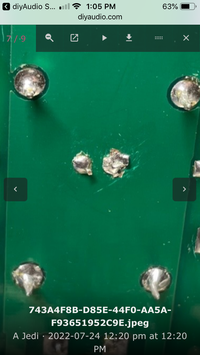

Thanks for the pictures
Check the solders for R7, these one in the middle are for RL7 and RR7 and kinda look odd. It might not be that since the issue is on both channels but it’s worth trying. Redo the solder then verify with a multimeter that each RL7 and RR7 make contact to ground
