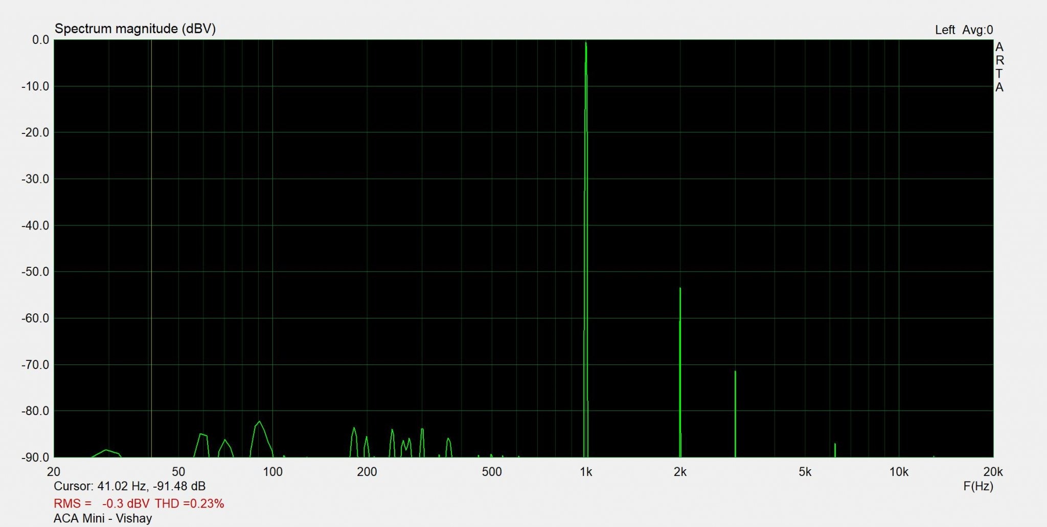

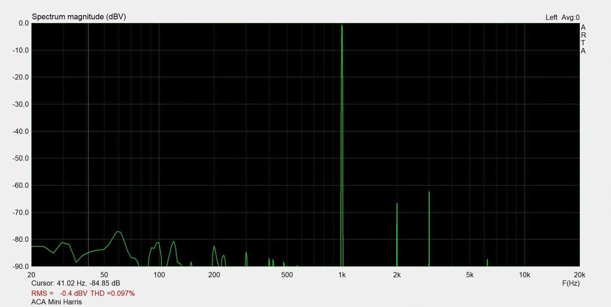

Below are measurements of two ACA mini's. One has a match pair of Harris MOSFETs, the other matched Vishay MOSFETs. The spectrum with the Harris transistors is about what I anticipated, but the Vishays are not what I was expecting. Why the big difference, even though all transistors have been matched?
Both measurements are with jumper in.
I wonder if the results would of been the same if you had use only one ACA mini and you had swapped the output devices.
Would be interesting to have a single ACA Mini equipped with the Vishay MOSFET on 1 channel and the Harris MOSFET on the other channel.

So... how do you match the MOSFETs? Can you share the technique? That's something I should probably do.Below are measurements of two ACA mini's. One has a match pair of Harris MOSFETs, the other matched Vishay MOSFETs. The spectrum with the Harris transistors is about what I anticipated, but the Vishays are not what I was expecting. Why the big difference, even though all transistors have been matched?
I just found this... Is this the way you use? https://www.firstwatt.com/pdf/art_matching.pdfSo... how do you match the MOSFETs? Can you share the technique? That's something I should probably do.
Thank you!
I don’t know what the phase of the 2nd harmonic is on the Vishays, but I will hazard a guess that they suffer from the classic "p channel IR issue" documented in my old article on testing mosfets, where the transconductance shelves down about 3 dB from the mid-band up. This is why we usually prefer the Harris parts. Try a test at 100 Hz.
