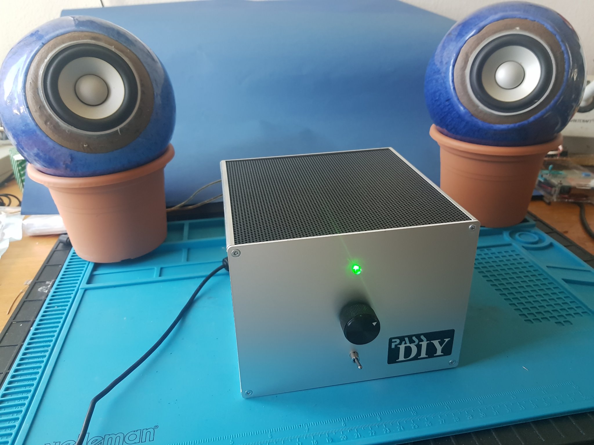

If I ever do a rev.2 PCB layout of the Almost Clone board (link 1) , (link 2) ...
I'm thinking I might add a jumper wire in series between the power supply input barrel jack and the rest of the circuit. It's quite a small change and won't increase the PCB size at all.
This gives builders the option to connect a Murata 1433428C inductor (330 uH // series R=0.15 // S.R.F.=2.5 MHz // 2.8 amps // $2.49) in series between the SMPS brick and the Mini ACA Almost Clone board. The connection would use flying-leads (hookup wires) and the Murata inductor wouldn't be PCB mounted -- just glued or zip tied or otherwise affixed to the chassis. Notice that the flying leads actually increase the inductance and thus are Not Necessarily Bad.
Don't want the inductor? Solder in a jumper wire. Yes want the inductor? Omit the jumper wire, solder flywires to its pads, connect inductor to flywires. Easy either way. Also easy to conduct Before / After listening tests.
Mess around with the idea in simulation; check whether it has any effect upon high frequency SMPS noise and hash produced by the Mean Well PSU brick. Be sure to include some nonidealities when modeling real components -- these are what ultimately sets (limits) circuit performance. Equivalent Series Inductance ("ESL"), Equivalent Series Resistance ("ESR"), Self Resonant Frequency, and so on.
Or -- if you're ambitions -- do a brand new, ground up PCB layout including an on-PCB footprint for such an inductor. You might even make the PCB footprint flexible, to accept one or two or even three other inductor part-numbers from different manufacturers. Just in case DigiKey and Mouser sell out of the Murata inductor.
My suggestions:
  • three connection points per channel and jumpers to connect an optional input potentiometer (look my latest ACA mini)
  • some more space and distance of the holes for 35VDC 15'000uF caps for the PSU part (C3) for people who dont want to use 25V caps
