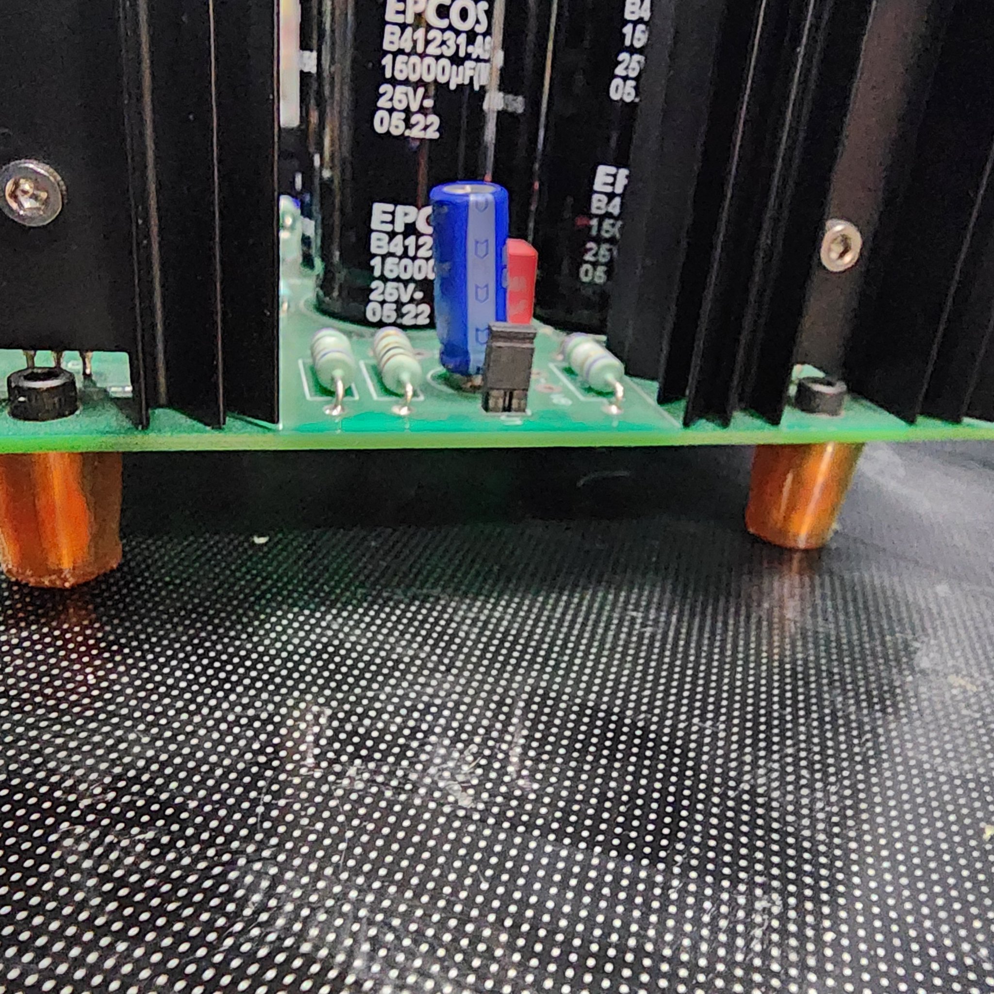

My solution was not quite as snazzy -- I used the red caps from a package of assorted vacuum caps I had lying around. (Auto parts for capping vacuum lines, not capacitors!)

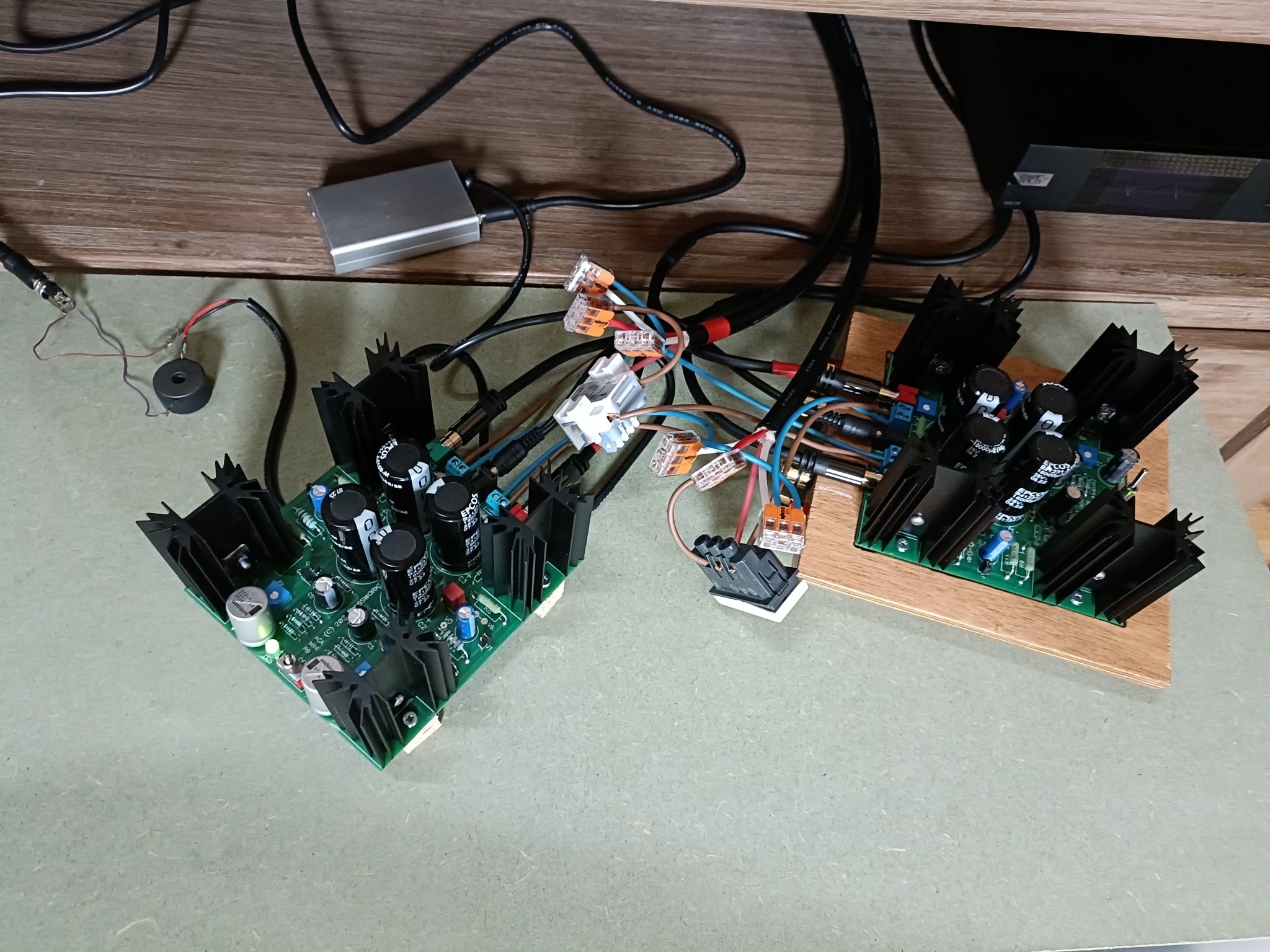

Attached pic: starting bi-amp listening test sessions… The night is likely to be long 😉

So glad you are happy!
Can't wait to read your report re horizontal, vertical and Vertical 2 bi-amping with these Minis.
Your cabling and switches to enable switching "on the" fly across various configuartions is indeed impressive and priceless when it comes to comparisons!

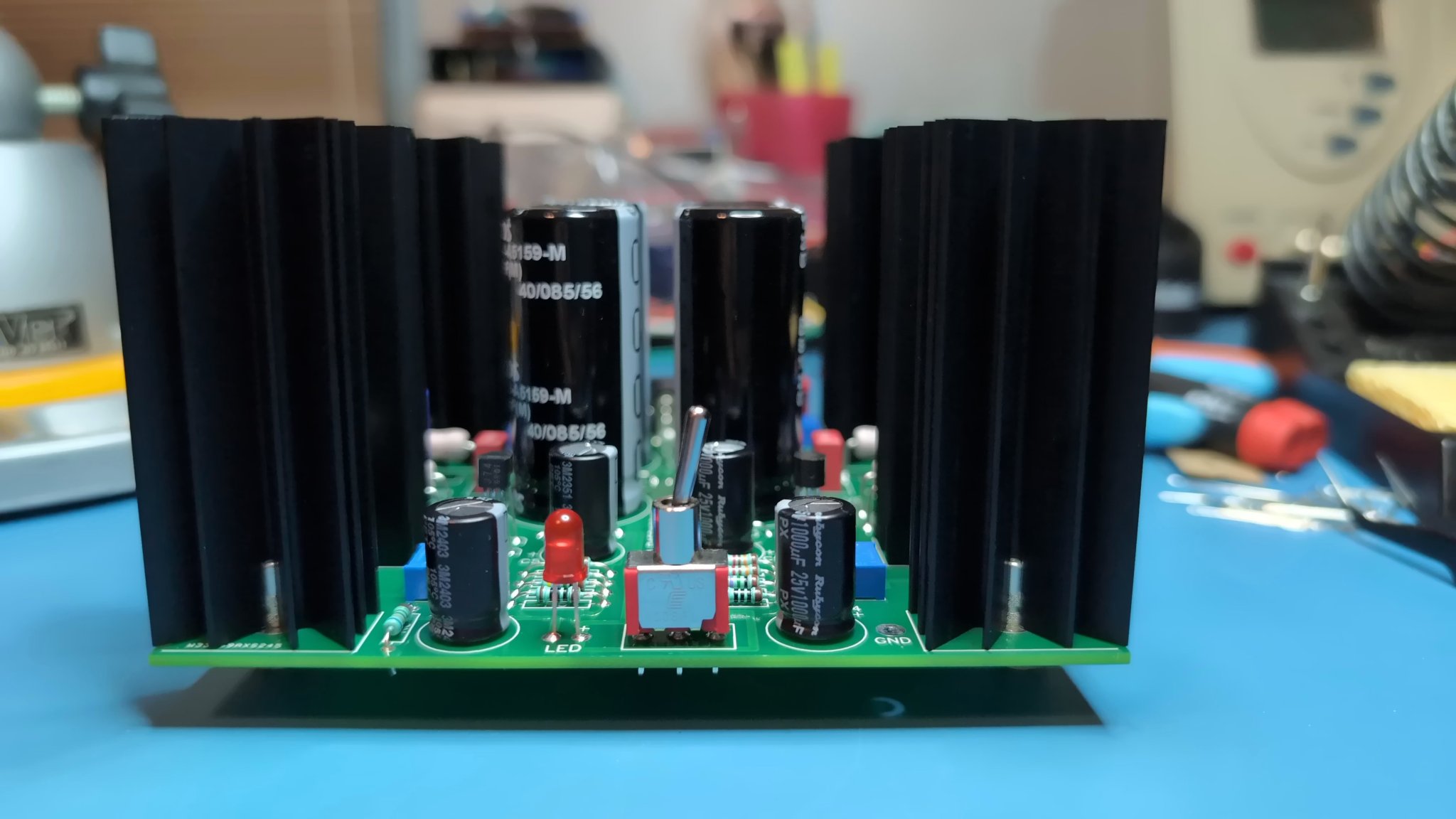

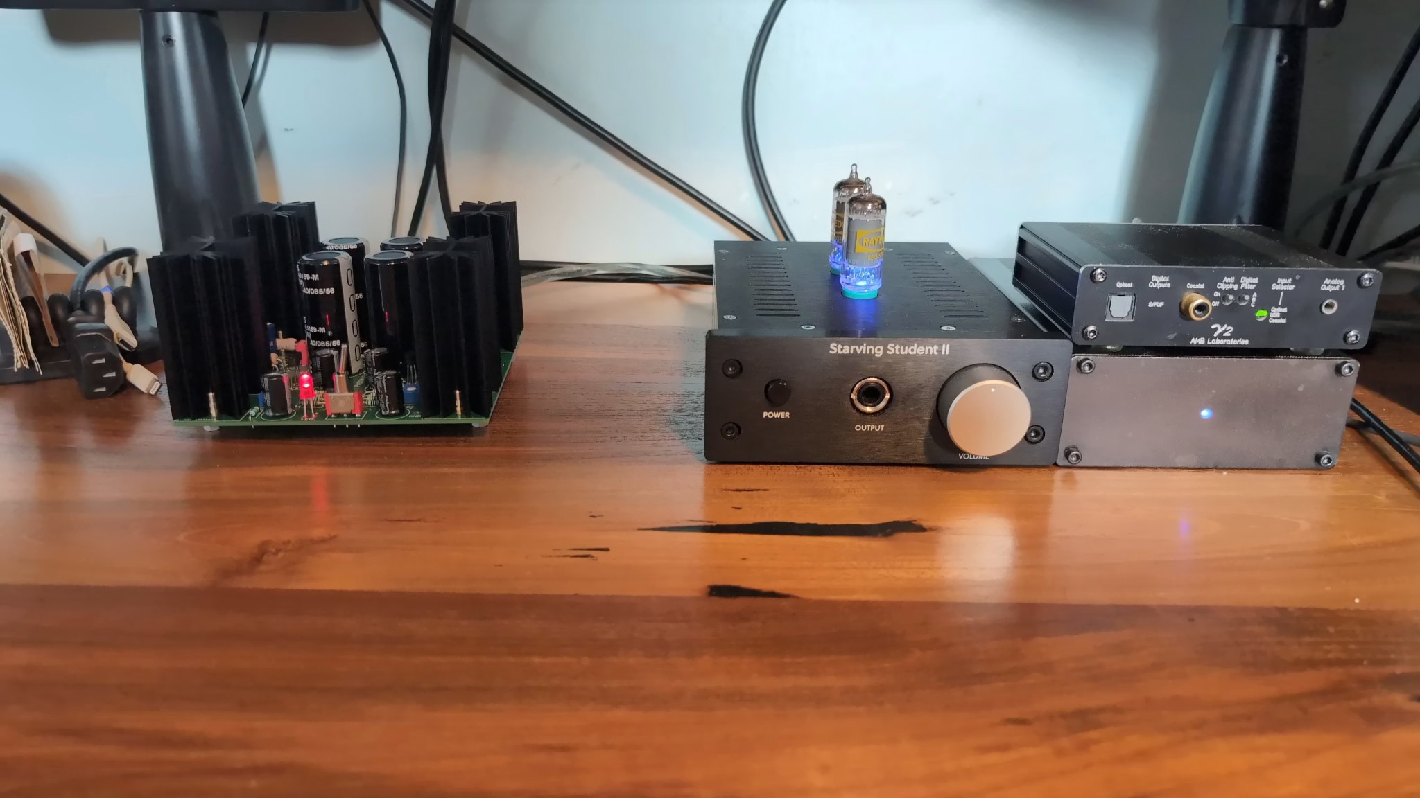

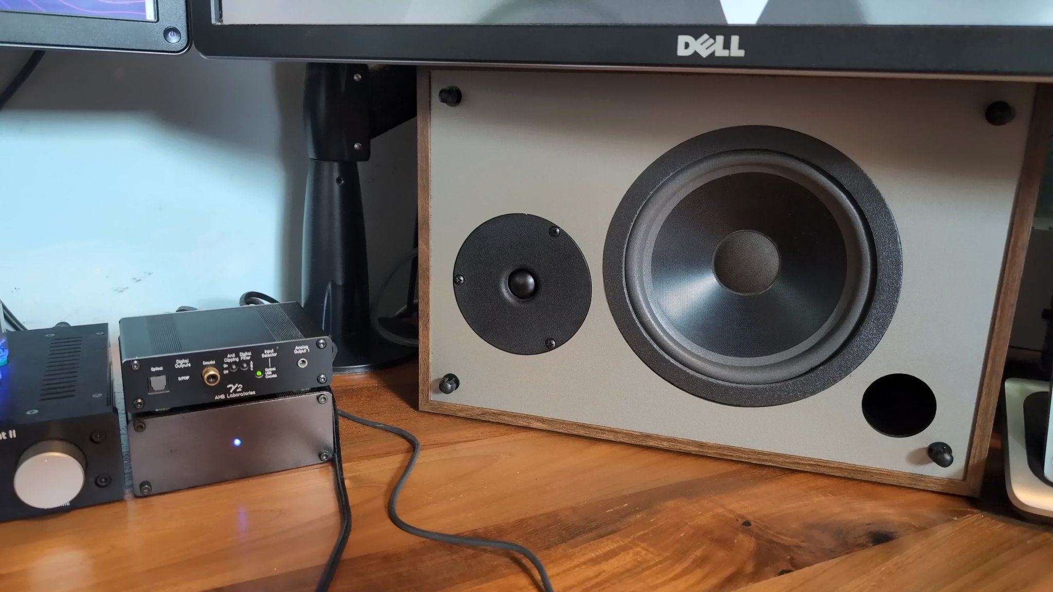

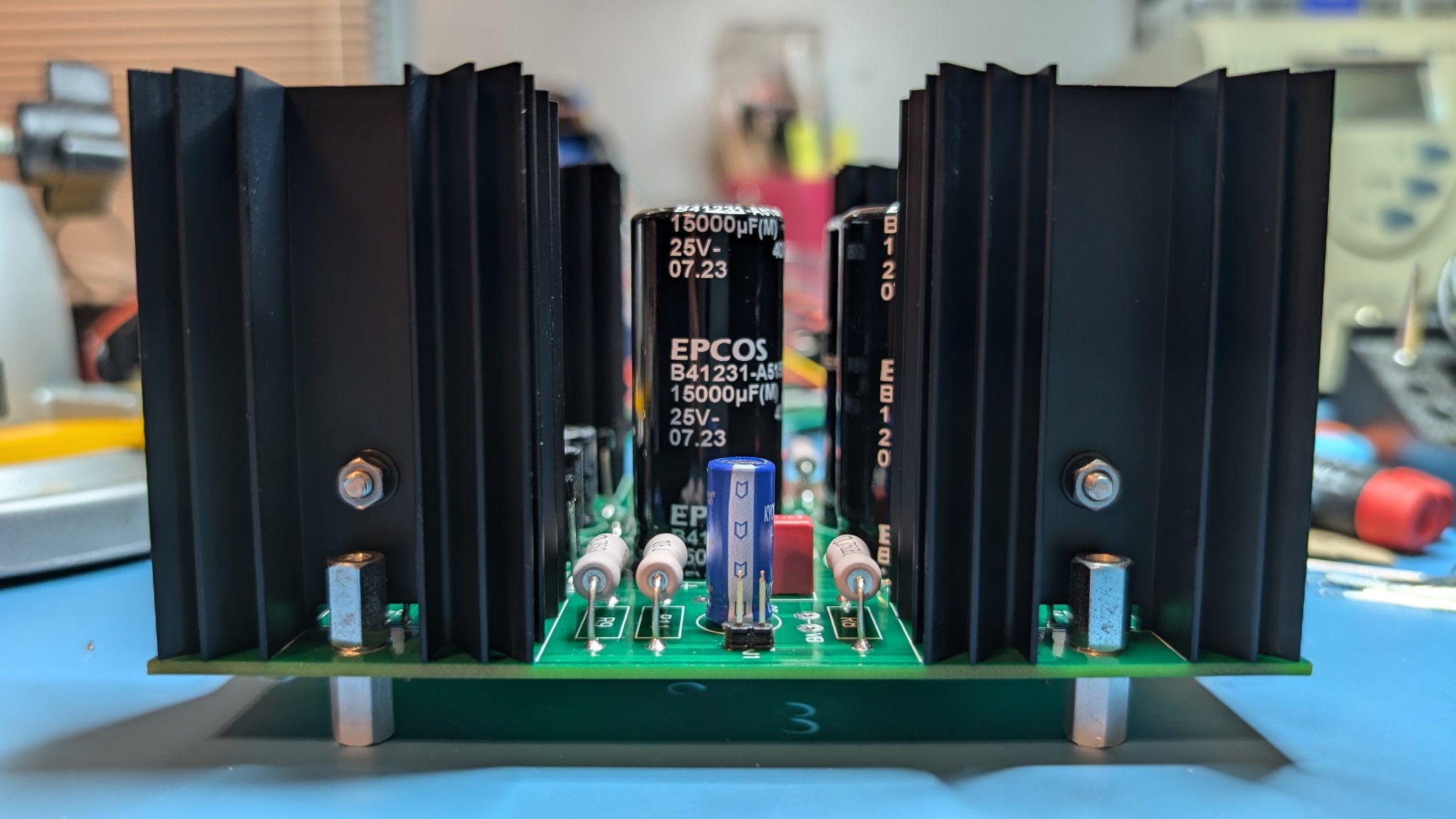

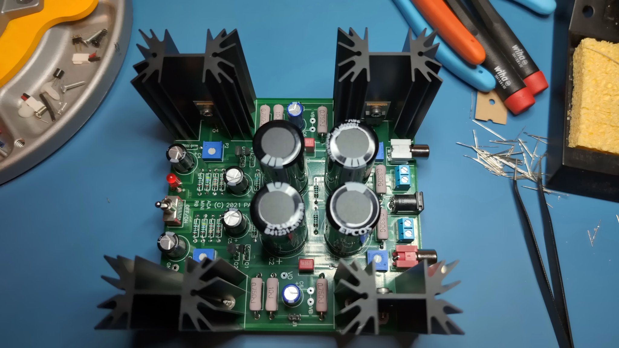

I got around to building mine over the weekend. I used the v1.1 BOM when ordering my parts, yet somehow didn't get 200k or 22.1k resistors so I used the original 221k and 6.8k values for R2 & R4. I'll be picking those up with my next parts order.
The biggest issue I ran into were the 1 turn pots. It felt like blowing on them was enough to turn them too far. I should have listened to prior comments and gone with multi-turn like I have in my other projects. It took somewhere around 8 hours to dial it in because of how touchy the pots were, but I eventually got it to 11.5V and 305-310mV on both channels.
Until today I only had headphones so the first test was with a pair of Beyerdynamic Tesla T1 2nd gen fed straight from an AMB Gamma 3 DAC. That sounded good but isn't why I built it, so next up was a pair of Energy ESM-4 bookshelf speakers fed from a Starving Student II and AMB Gamma 2 DAC. Now starts the fun of trying it with all my other gear to see what the best combo is.
An ACA or ACA MinMax seemed like a good next project, but for the price I might do a second ACA Mini then my F5m. You really can't beat the price & performance of the mini. After a day of use it's made me reconsider adding binding posts to a balanced headphone amp I'm working on, I didn't think something this small could work this good with speakers but I was happily proven wrong.

Congrats for your build!
The Mini is an amazing amp as standard and such a great VFM! It is even a fantastic amp slightly modified or in bi-amping mode.
So yes, build 2 Mini... that's Gilles conclusion of the night - it sounded that great vs just one and it wasn't power related as he just needs max 2W!
Indeed, the next stop would probably be the F5m, at least for those needing more power.... I would be really delighted to read how that one does vs 2 Mini, it looks fantastic on the paper...
