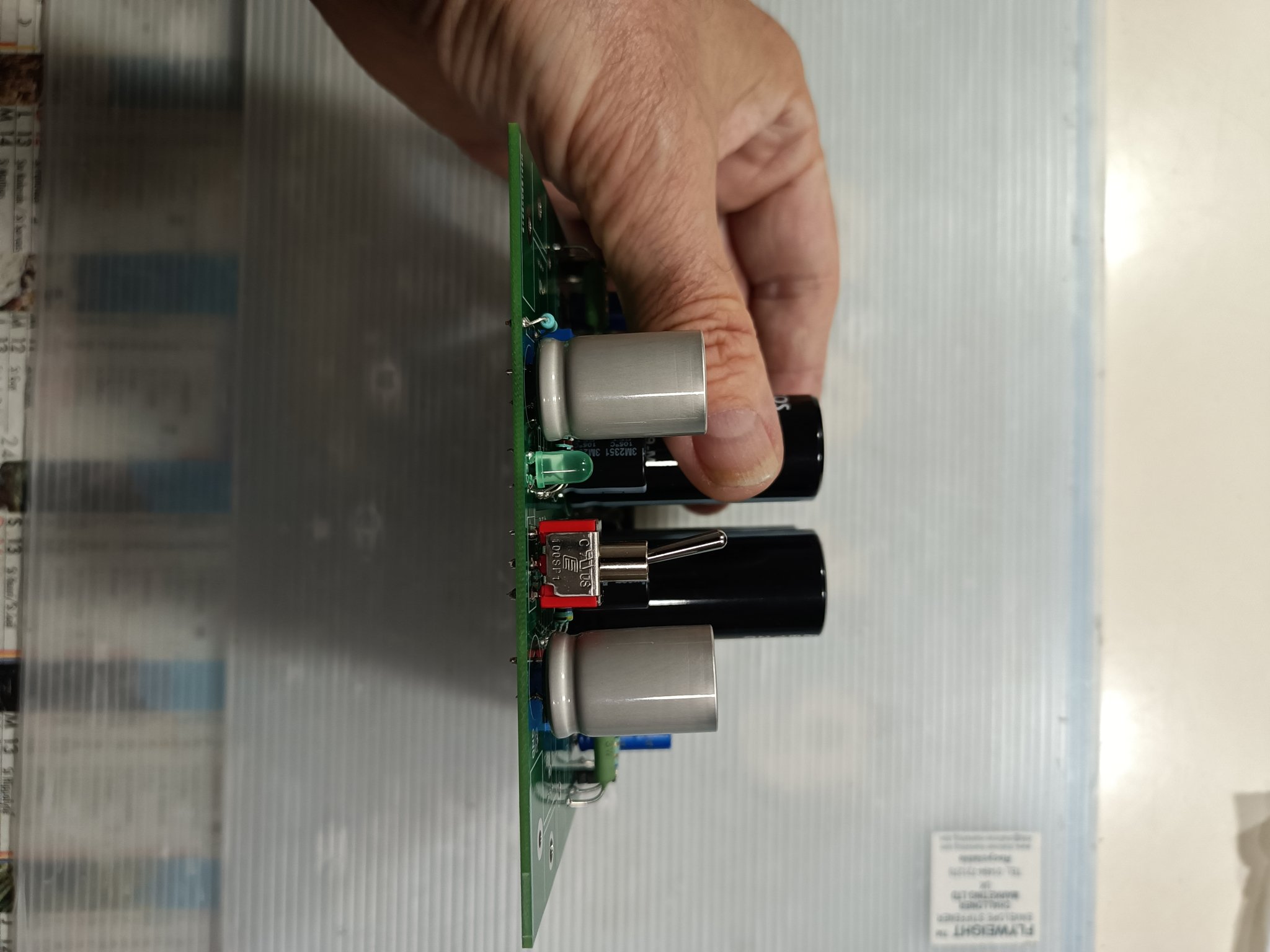

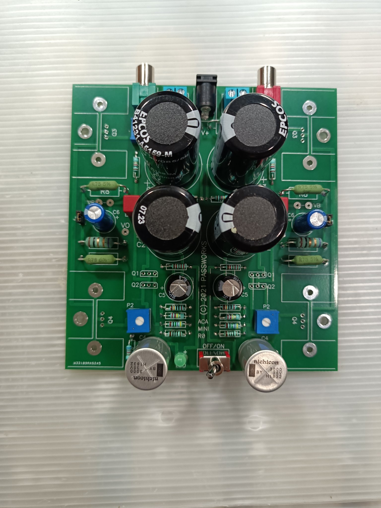

I wanted to build 2 identical Minis for Gilles to try them in bi-amping mode... well, that won't happen.
When I purchased the parts ages ago to build my first Mini, I knew there was a mistake in the BOM (C4 & C5 showing quantity 3 instead of 4).
I knew it... and I sadly completely forgot about it, stupid me. Confident, I just followed the shop's link to the excellent build guide which led me to the Mini's updated BOM (V1.1)... which I assumed would be correct(ed). I expect most beginners just to do the same and not to read all the post's pages. Well, the updated BOM sadly still displays the same mistake: quantity 3 instead of 4.
Too late for me (I just put last week 2 orders at Mouser and Digi and won't just order 1 single cap), but I would say it might be useful to have a corrected BOM V1.2 for future builders. Just recommending, not commanding of course, and again my mistake to go too quickly on such a simple build.
As of me, I decided to take whatever I had handy. I had just a couple of hours at lunch time to assemble the passive section of the Mini. So I went for C4 = 3000uF / 35V instead of 1000uF/25V. It just fits (no contact etc.)
I don't expect any sonic change / benefits due to the uprated RC filtering function, nor ESR change (due to the 6.8k R in front). Nor do I expect anything else to go seriously wrong or this change to create a functional problem... BUT please let me know if I am wrong.
I do believe the only change will be that the time constant at start up will be 3x higher, That is from 7s to 21s, so a slow start up... and that's it hopefully.
PLEASE tell me if I am mistaken, the caps are in place and this Mini isn't in fact for me but for a friend, so it will go out and needs to be tip top... it is even better built than my own LOL

Oh bloody hell! Mistook C4 and C5 in the schematic... when things start to go wrong and you are working too fast... things get even worst LOL
So... Ignore my comments re time constant and RC etc.
I better leave the experts here comment than me guessing...
QUESTION
Is there any problem me using 3000uF at C4 instead of 1000uF???
I guess no but have no clue what effect that cap has other than decoupling... does this affect sound (impact on feedback resistors perhaps?)... or even worst re function (oscillations or whatever)?
Need expert advice here, please
Many thanks in advance
Claude

Let me see if I can be useful Claude.
C4 is in the NF network and will determine the LF cut-off:
when C4 is 1000uF F3 is 1.6Hz, when it's 3000uF it's 0.5Hz.
The overall LF cut-off depends on C2 and R7, when R7 is in parallel with the load, either 8 Ohm or 4 Ohm.
So I think with C4 you are safe.
C5 is even easier as it forms a LPF with R4 and both determine how long it takes for the circuit to become operational:
When R4 is 6.8kOhm the time constant is 6.8 seconds (with 1000uF).
Later Mr. Pass changed it to 22kOhm so time constant becomes 22 seconds.
With C5 3000uF the time constant varies between 20 sec and 66 sec, depending on R4.
So if you want to stay with 3000uF maybe consider this.
You might want to go back to 6.8kOhm for R4 to be within 20 sec. of charging C5.
It sounds cumbersome and convoluted but it's not.
This calculator might help:
https://sengpielaudio.com/calculator-RCpad.htm
P.S. Just saw that your C5 is 1000uF so ignore the above about it. Still positive you are safe with C4 @ 3000uF.

Second Mini alive and kicking since a couple of hours.
Special thanks to Stanislav and WBS, who encouraged me to carry on with the "wrong" C4 caps, and Franz for correcting me. Nothing blew up so far, all OK guys ;-)
It is trully a remarkable unit, and consistant: this very late kit sounds very similar (perhaps even identical once ran-in) to my first batch kit.
Two very general remarks for future builders:
1- I believe correcting the BOM on the number of parts required for C4 & C5 would be a good thing. Eg from 3 to 4.
2- Today's kit require four 2k trip pots instead of the initial 1k ones. It makes adjusting twice as sensitive. No prob, you eventualy get there precisely despite the 'play' once you learned how to use the second trim pot for fine adjustements... but it takes twice the time. More an issue for perfectionists, or non patient /non experiment builders. These might want to consider multiturns alternatives.
Other than that, very straight forward, very robust, very easy and quick to assemble, non expensive and fabulous sound, so don't hesitate, this is tremendous VFM.
