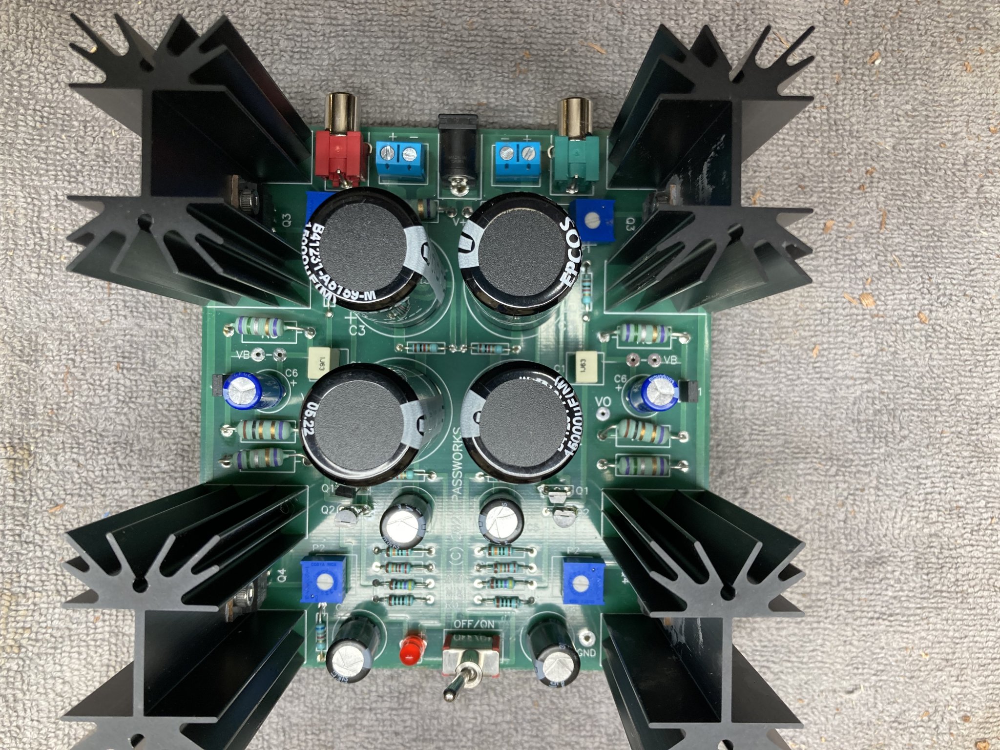

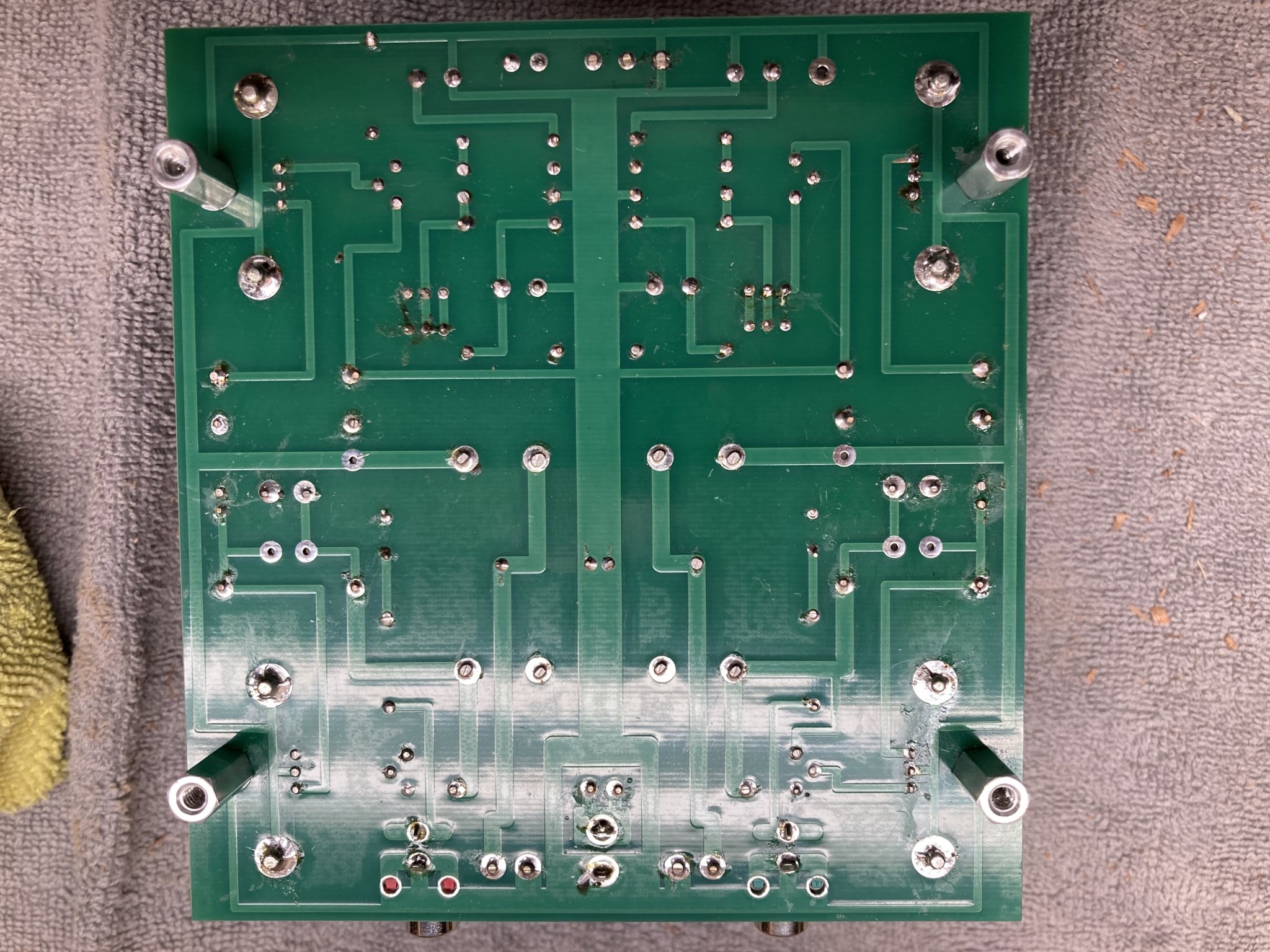

Just finished the ACA mini and need some help/suggestions. When I hook it up to my system I get nothing but dead silence. I measured the values of every resistor, double checked capacitor orientation and orientations of all transistors. Discovered and reoriented a one backward Q1 and one Q2. It adjusted properly: VO= 11.508 or so volts in each channel; VB adjusted to .303 volts in each channel. Pictures below. What should my next diagnostic steps be?
Reactions: lastnamenelson
Thanks 6L6 for your reply. That was my suspicion as well-- something up stream from the ACA mini. I'm using a DAC as input from another system that works . The cables, etc. all from a known good system. This doesn't mean that I haven't done something wrong somewhere but I think I've tried the usual suspects. Maybe re-do it all again???
Mystery solved. I had two different DACs that both worked in other systems. Neither worked with the ACA mini. Tried a few more things and discovered that both my phone and tablet (tried both of them, too) had the volume turned all the way down. They feed a digital signal to the DAC. Turned it up and the ACA mini works like a charm. I'm playing it through horn based speakers and to me they sound noticeably honky compared to my previous amp. Would adjusting VO/VB make a difference on this front? I removed the jumpers and I think that may have helped but I'd have to A/B them some more to be sure.
Thanks you for your kind responses.
