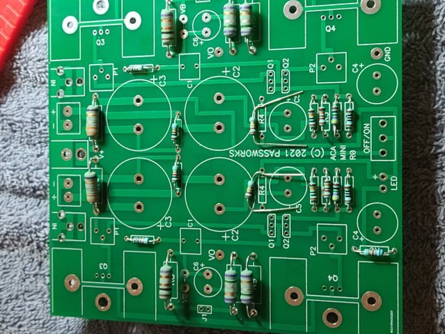

I'm feeling kind of humbled, trying to assemble an ACAMini and am getting beat up by the resistors. Everything seems fine except R4, which should be 6.8K, but what I have is 22K, red red orange gold.
Reactions: lastnamenelson
The value is not critical as when the amplifier is up to operating voltage, the current through the resistor is miniscule. The main purposes of the resistor is to provide power supply filtering in conjunction with the capacitors before and after the resistor, and also to slow the charging of the last capacitor for slow turn-on and thump avoidance. In both cases the larger resistance is advantageous.

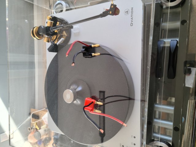

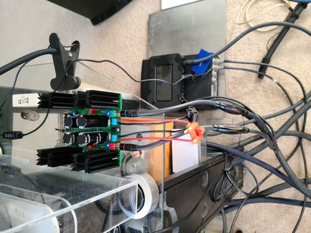

Banana adapters just arrived, who could wait that long! For the time being I am running Revel F226Be, so not the best match but that's a tale for another time., or perhaps a F5M 😉. The Mini is taking the place of my Supernait 3 w/ outboard PS, being driven from a Bluesound Node power thru AQ Niagara 3000.
First up was Blind Faith I Can't Find My Way Home, MoFi, not the best recording but enjoyable as the amp warms up.
Next Boz Scaggs w/ Duanne Allman, Buddy Can You Loan Me A Dime, Wonderful. The organ, Boz's voice and of course Duane!
Followed by The Persuasions, We Came To Play, Don't It Make You Want To Go Home, the LP is much better, but wonderful
Muddy Waters Folk Singer My Home Is On The Delta MQA, here is where it starts to really shine!
One of my favorite tracks was up next, Nils Lofgren Acoustic Live Keith Don't Go, absolutely beautiful!
All in all most impressive indeed!!
I am curious as to what input level would overload the amp, and if it isn't too much to ask perhaps some explanation as to how one determines that.
