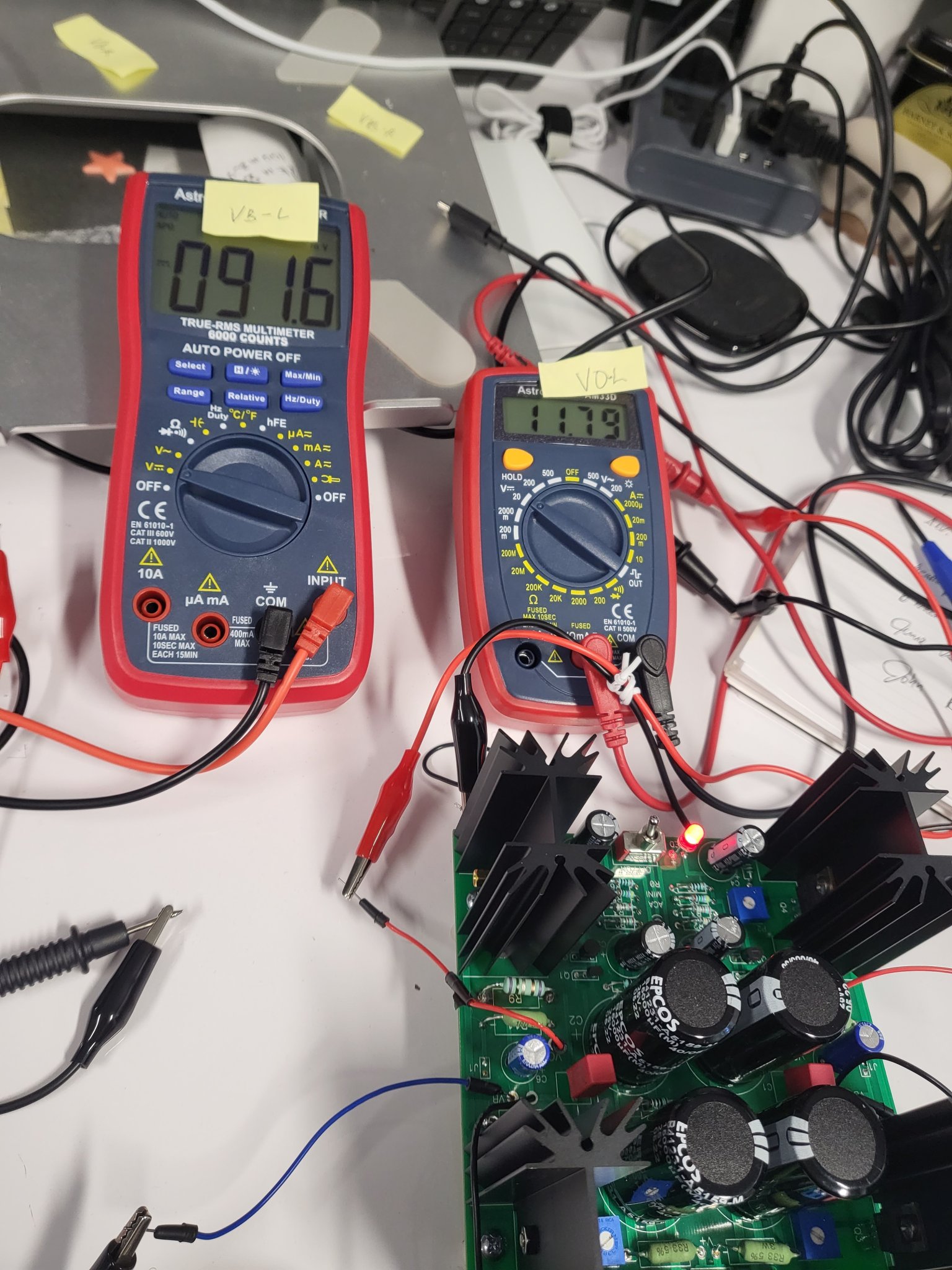

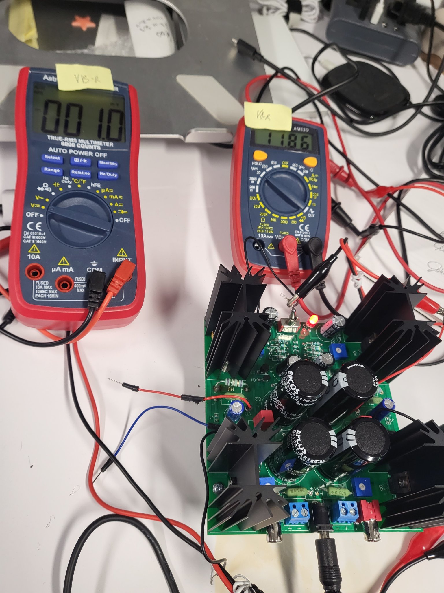

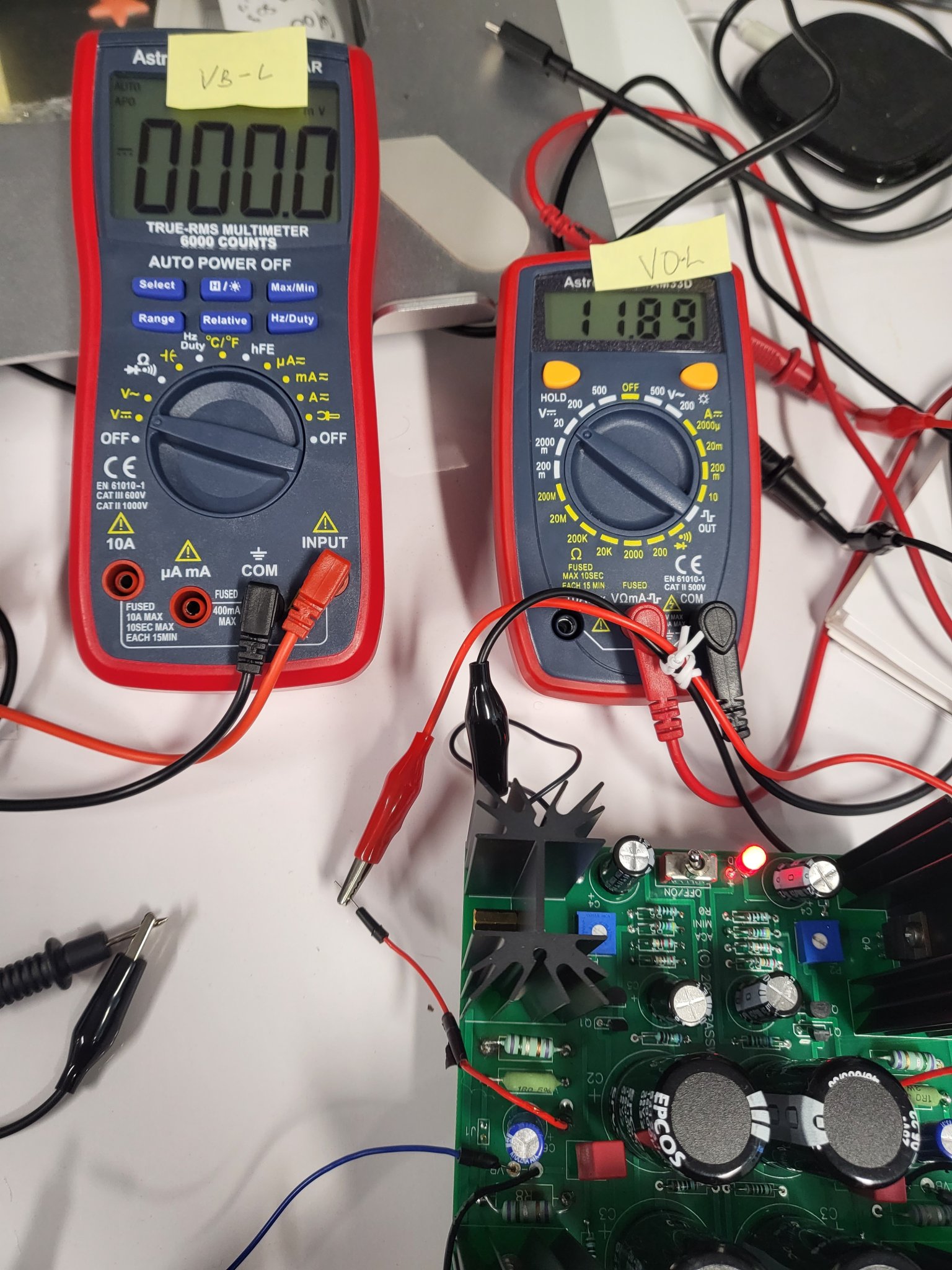

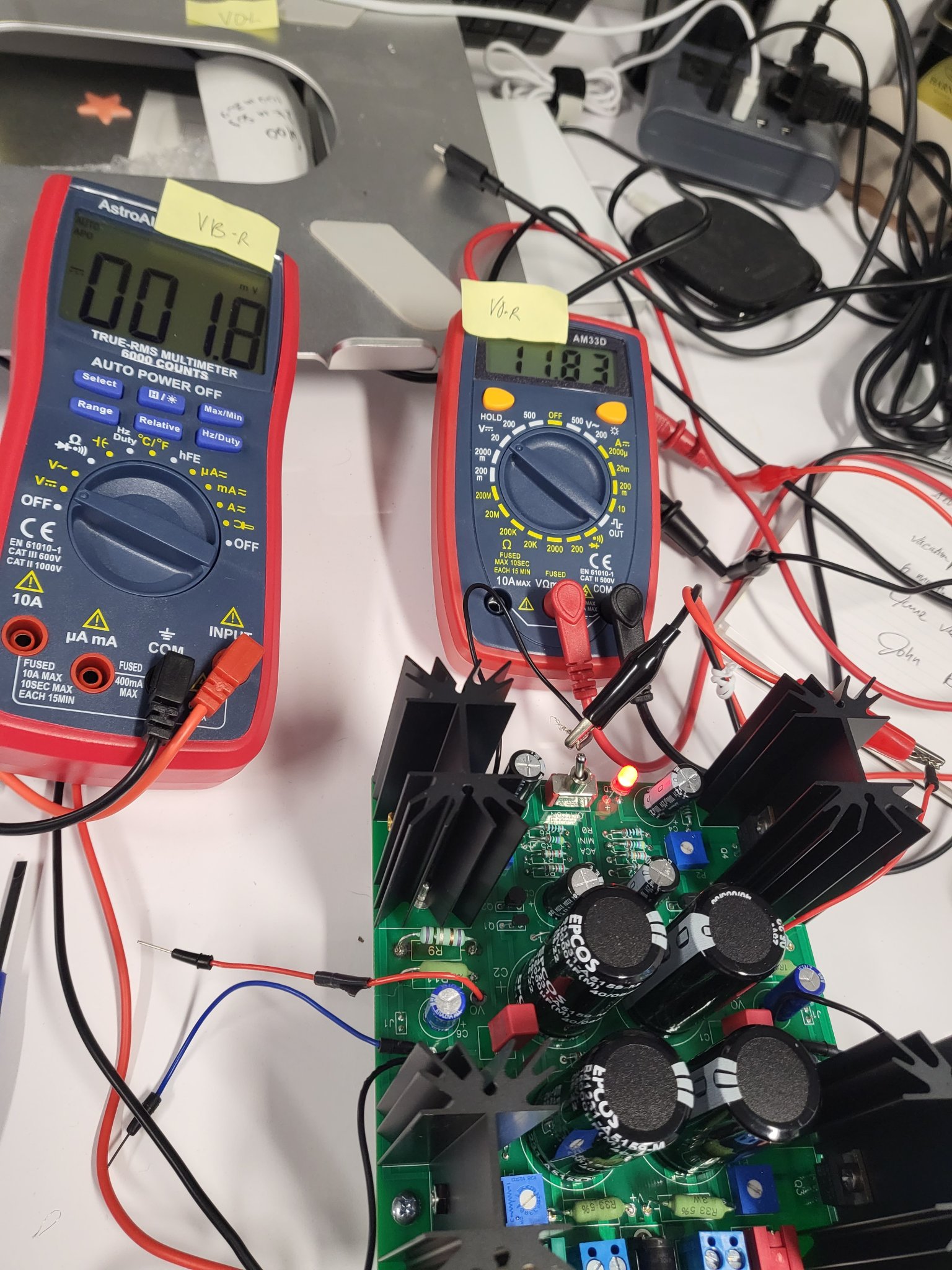

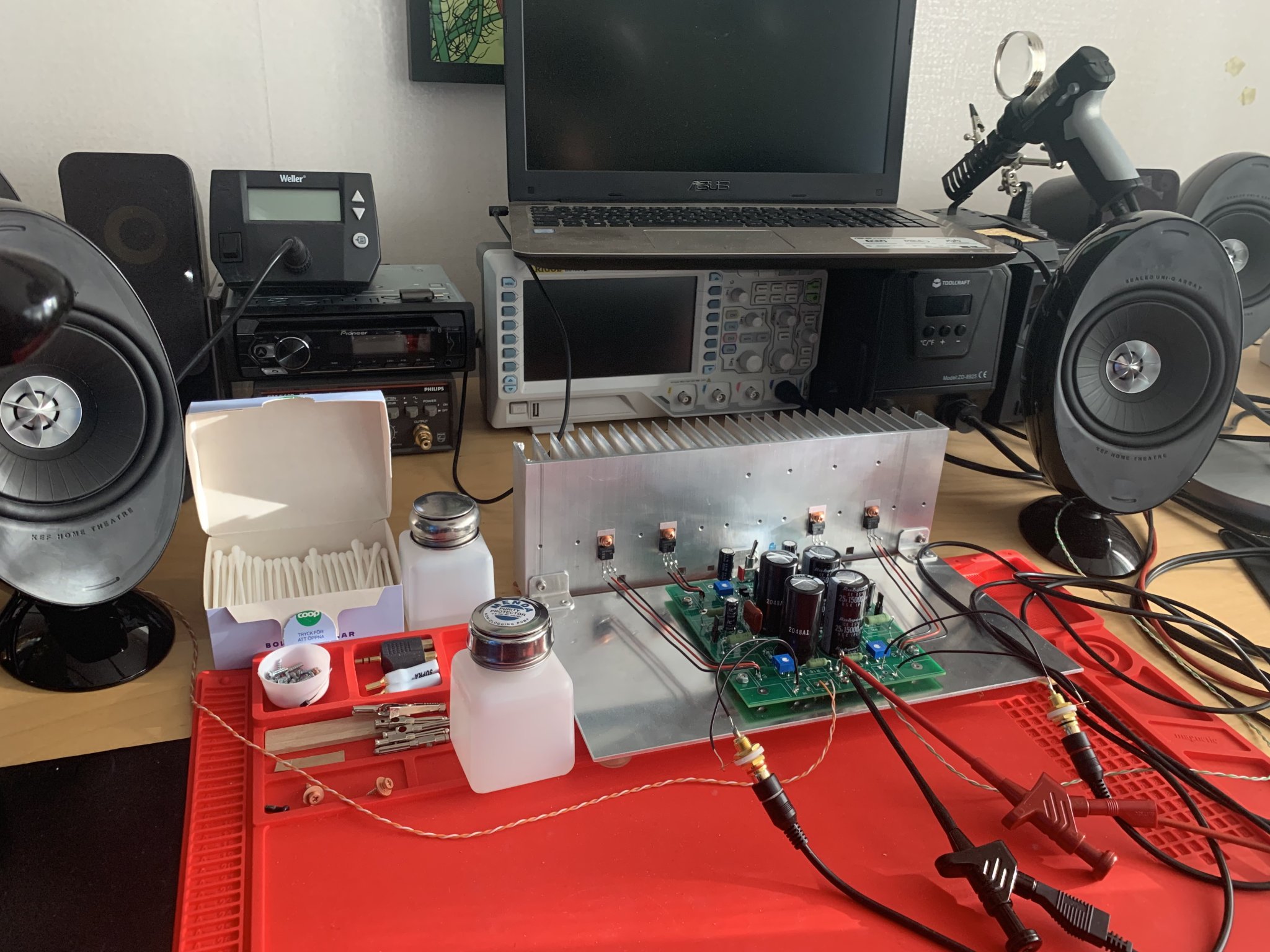

@KevinHeem apologies not trying to be frustrating. I took new readings with pics.
All pots all the way counterclockwise I have:
Left VB 00.00 & Vo 11.89
Right Vb 01.8mv & Right Vo 11.83
All pots clockwise I have
Left VB 91.60mv & Vo 11.79
Right Vb 1.0mv & Right Vo 11.86
No smoke on either. Pics below.
Testing at stock bias. Sounds actually spookily fricken toetappingly beautiful with the linear lab PSU. @24V.
Yeah, only the small, beautifully smooth, but almost bassless, build bench KEF aluminium enclosure point source speakers.
I am now MORE than curious how this will sound on the really big rig.

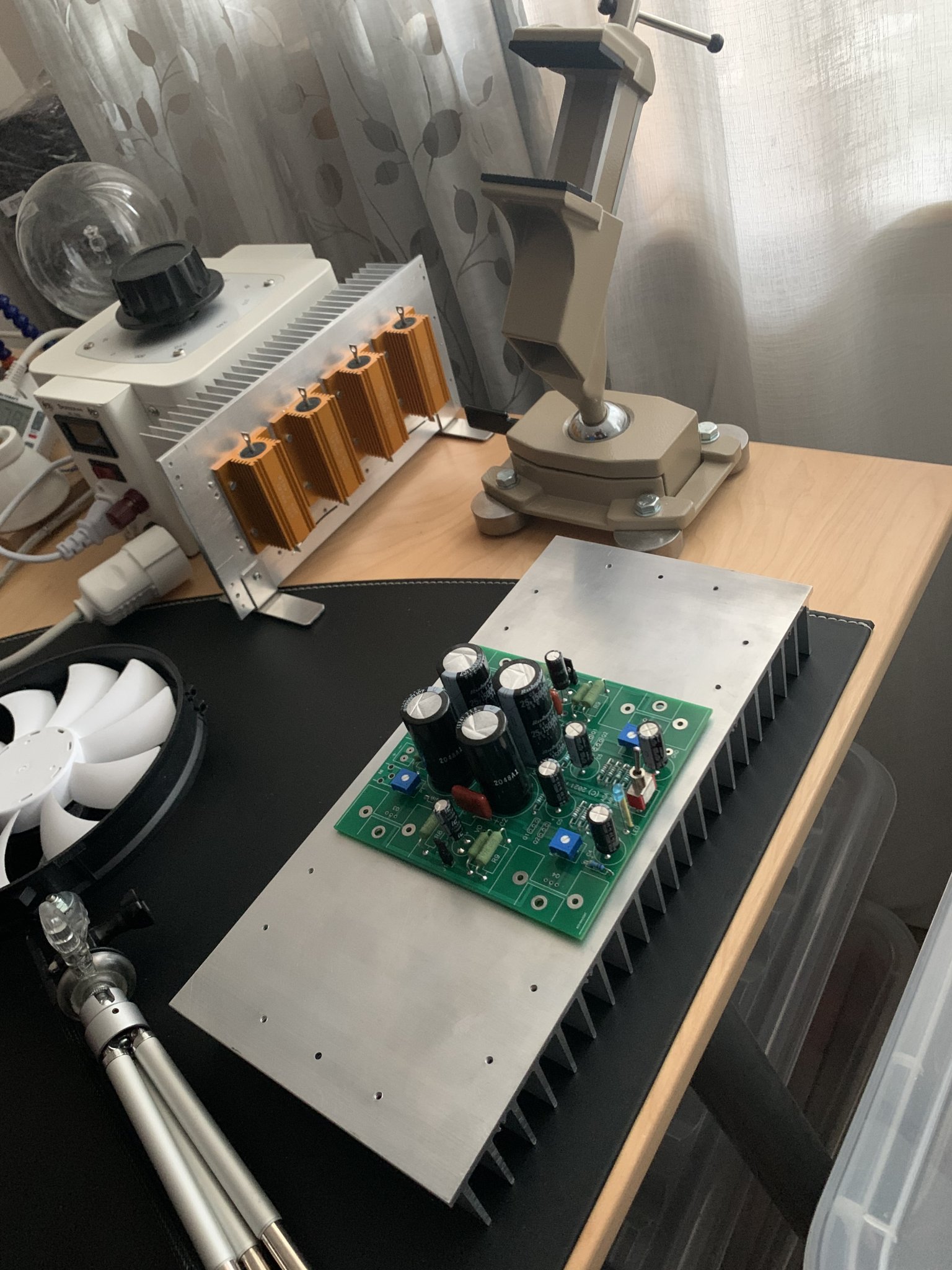

you can fix the pcb direct on heatsink to have short mosfet wire.....Testing at stock bias
Yeah, thats probably not a bad, but a fairly good idea. Less is more. Clean is Clean. So, since i am reuseing the heatsinks from my old Yamaha and my not so old Onkyo home cinema recievers, on my first and my second mini, thats exactly what i am gonna do. So here is teh planned setup for the no 2.
Comin up, one of these days: Pass ACA Mini no 2 🙂❤️
