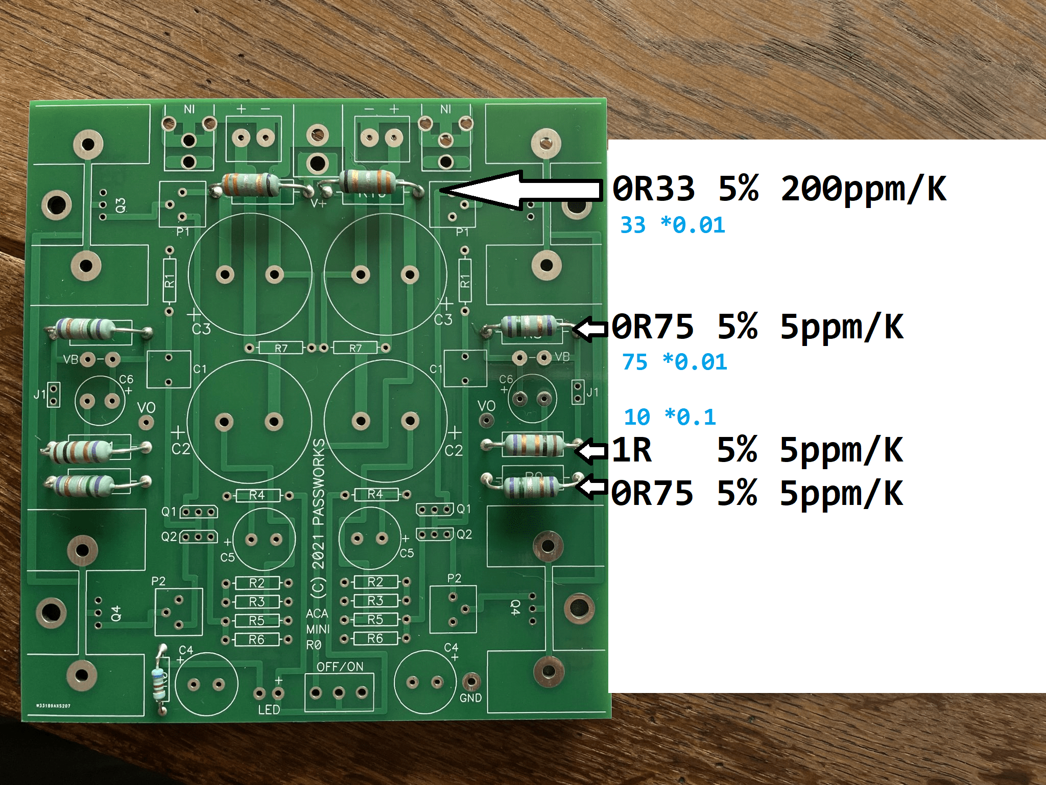

I have had a hard look at resistors R8 and R9. They should be 0.75 Ohm but they might be 75 Ohm based on the colours that I see. If that is the case, that would explain the cold mosfets. Please check their resistance. Unsolder and lift one resistor leg if necessary to get an accurate measurement.
OK, I checked with Vincent and it's a tempest in a teapot. The correct resistors were shipped
and the values measured in and out of circuit reflect either the meter accuracy or that they
were measured in circuit. The odd bands are simply from a different source and 2% tolerance,
reflecting cost and supply issues. They will work fine.
With the specification of the temperature coefficient, the value of 0R75 and 0R33 can only be described with three bands, because there is no color for a factor of 0.001.
When using four bands and with a factor of 0.01, the first band should be black, which is not allowed or intended.

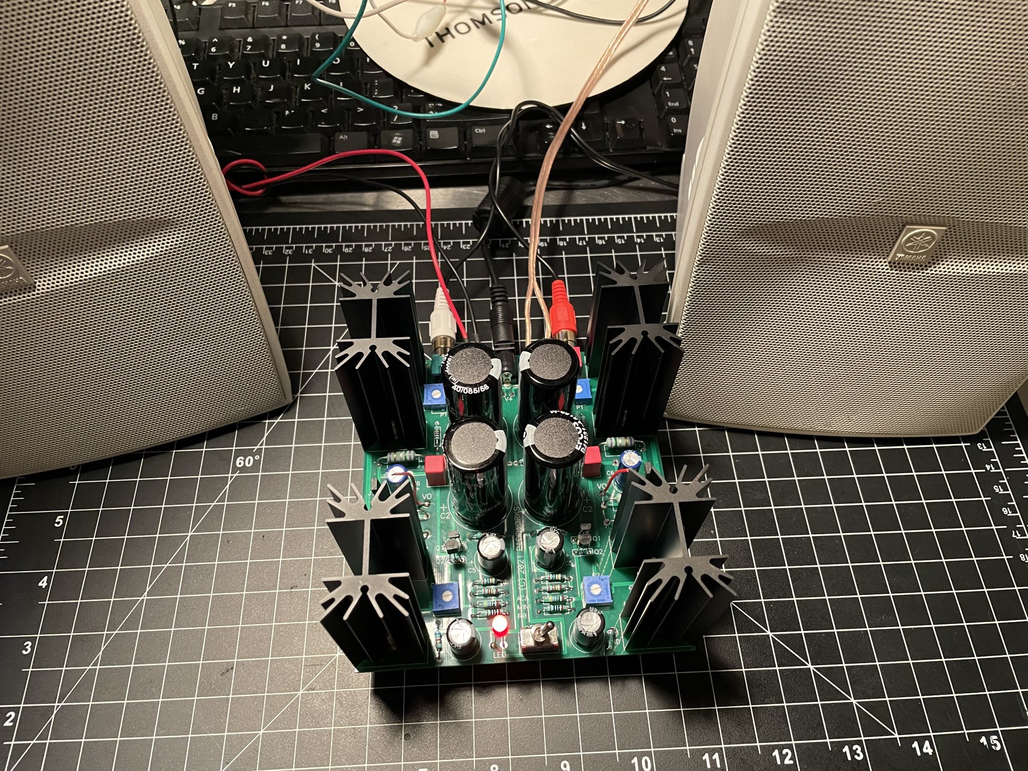

It’s the fact that his sinks aren’t warming up at all that is troubling to me.
@ALNY
Are we sure it’s biased at 300mV and not something like 30mV? I know, I’m reaching for straws here…but we need to determine why the MOSFET’s aren’t getting enough voltage.
Thanks @Nelson Pass and everyone. Wow, what an amazing forum, and project.
I'm ashamed to say that I had screwed up the biasing, but it took me awhile to get there. In between work emails, I pulled out R9 and tested it. 0.75 ohms. So I turned the pots back to full counter-clockwise and started over with biasing. At this point I began looking seriously at my three multimeters. After work I got new batteries and then realized two of them are just junk. So I biased it with the one good one, switching back and forth between VB and VO, and estimated I had been low on VB by a factor of 10.
Now the heatsinks are toasty and the sound is wonderful. It's driving the Yamaha speakers very well. Buchardts tomorrow.

Regarding recent concerns regarding out of spec readings of power resistors, I discovered a link in step 6 of the ACA Mini build guide, which I overlooked while building 2 of my own, that discusses the difficulty in accurately measuring low resistance resistors.
Power resistors: It's difficult to measure these because the resistance of your multimeter leads (normally 0.2-0.4Ω) will be added. You can measure your leads and subtract the value, just trust the values which are printed on them, or build a low resistance value test rig.
