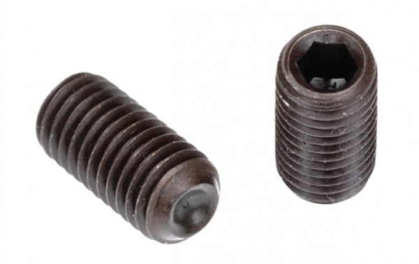

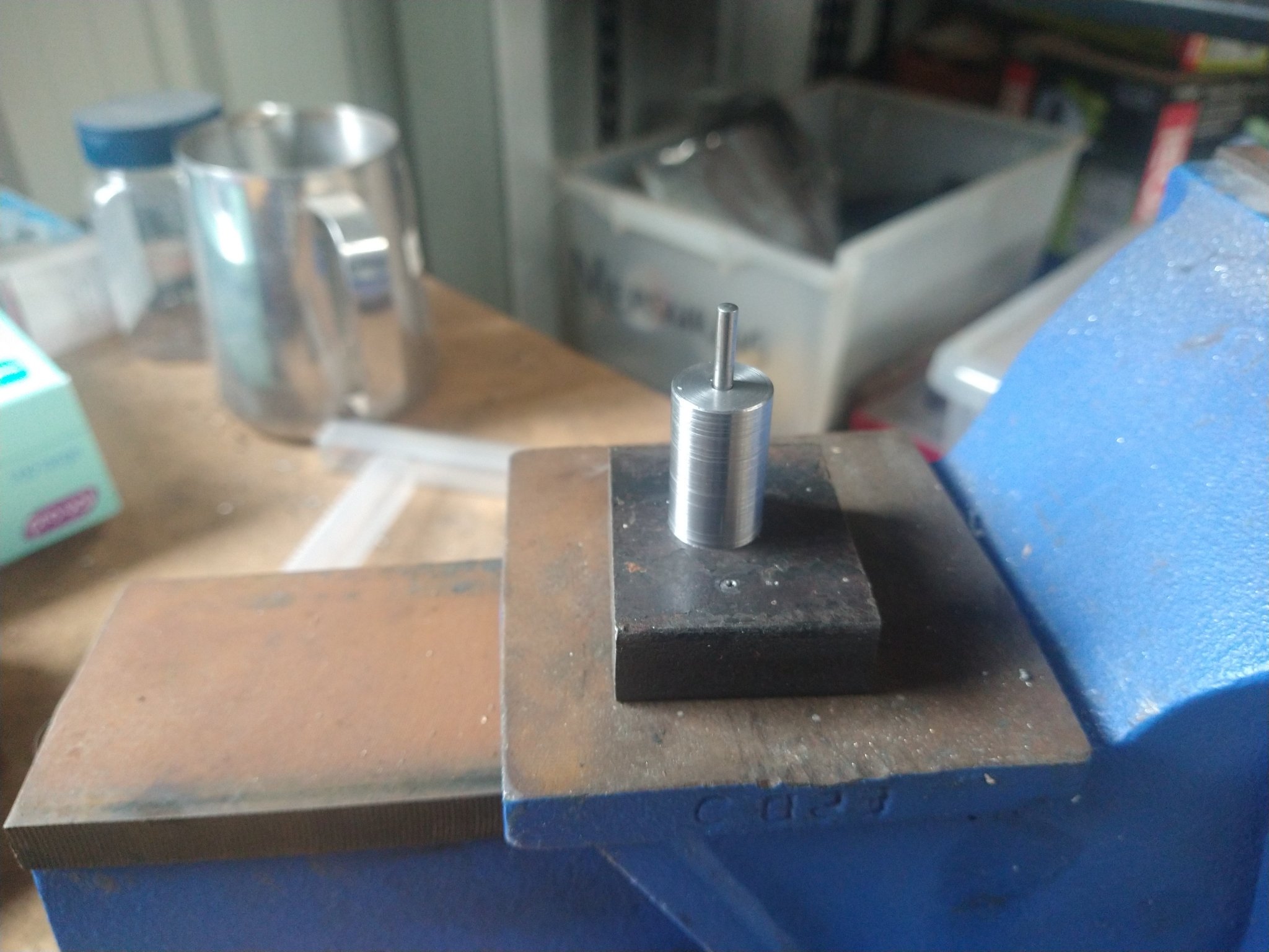

I didn't ask True Point if they could make larger pivots although this would be possible.
It takes a lot of work to radius and polish the pivot and cup. I did it in the lathe but you could use a hand drill. The M4 setscrews need to have the flat cup radiused to suite the pivot.

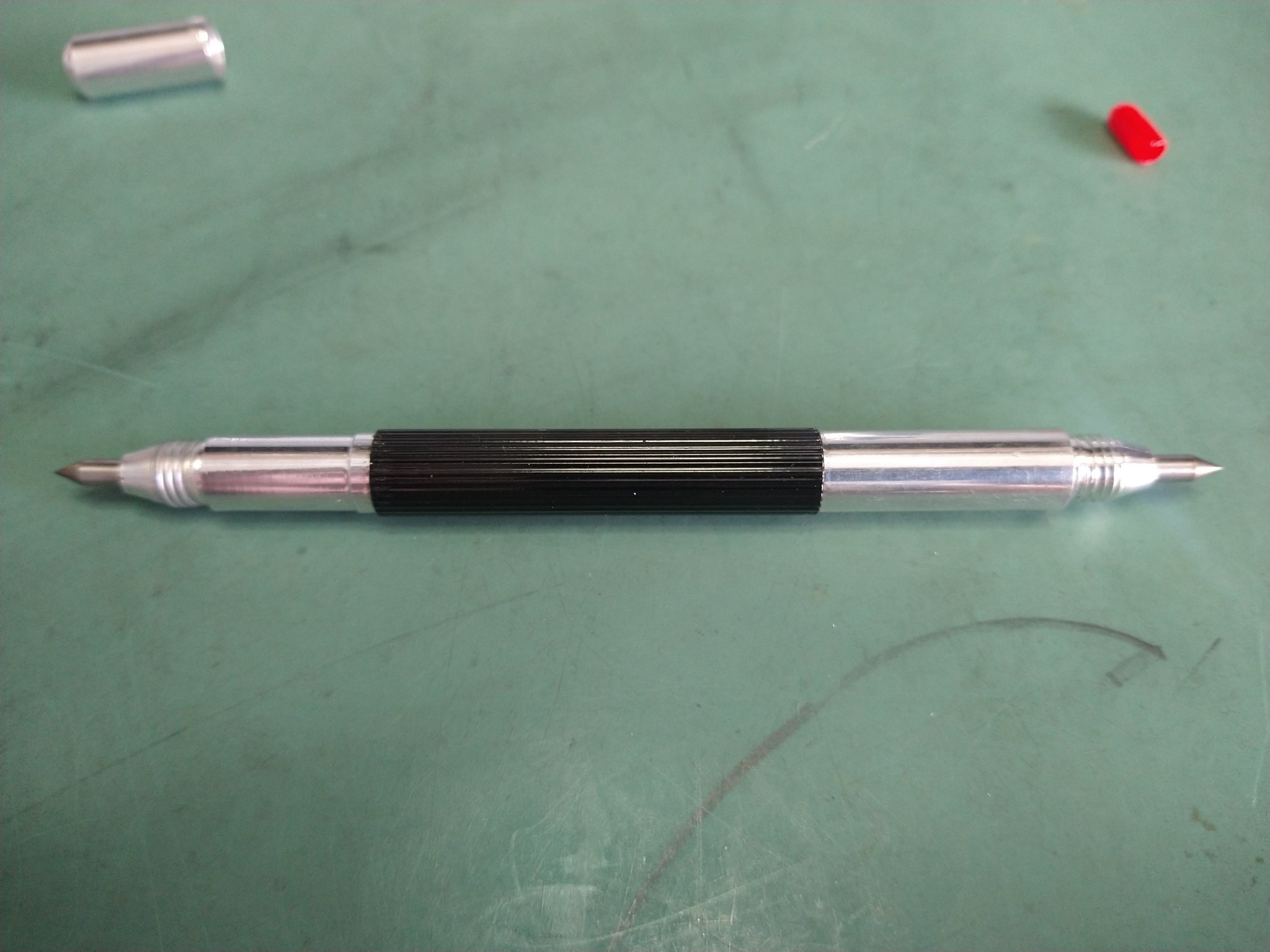

To forge the radius in the cup I used a needle from a roller bearing as these are incredibly hard. I ground the radius on the needle screw the setscrew into the bottom of the round bar and hit it with a hammer.
Next step is to install the needle into a drill and burnish the setscrew. Polish with diamond paste to get a mirror finish. The better the finish the lower breakaway torque will be.
The donor carbide scribe and forge.

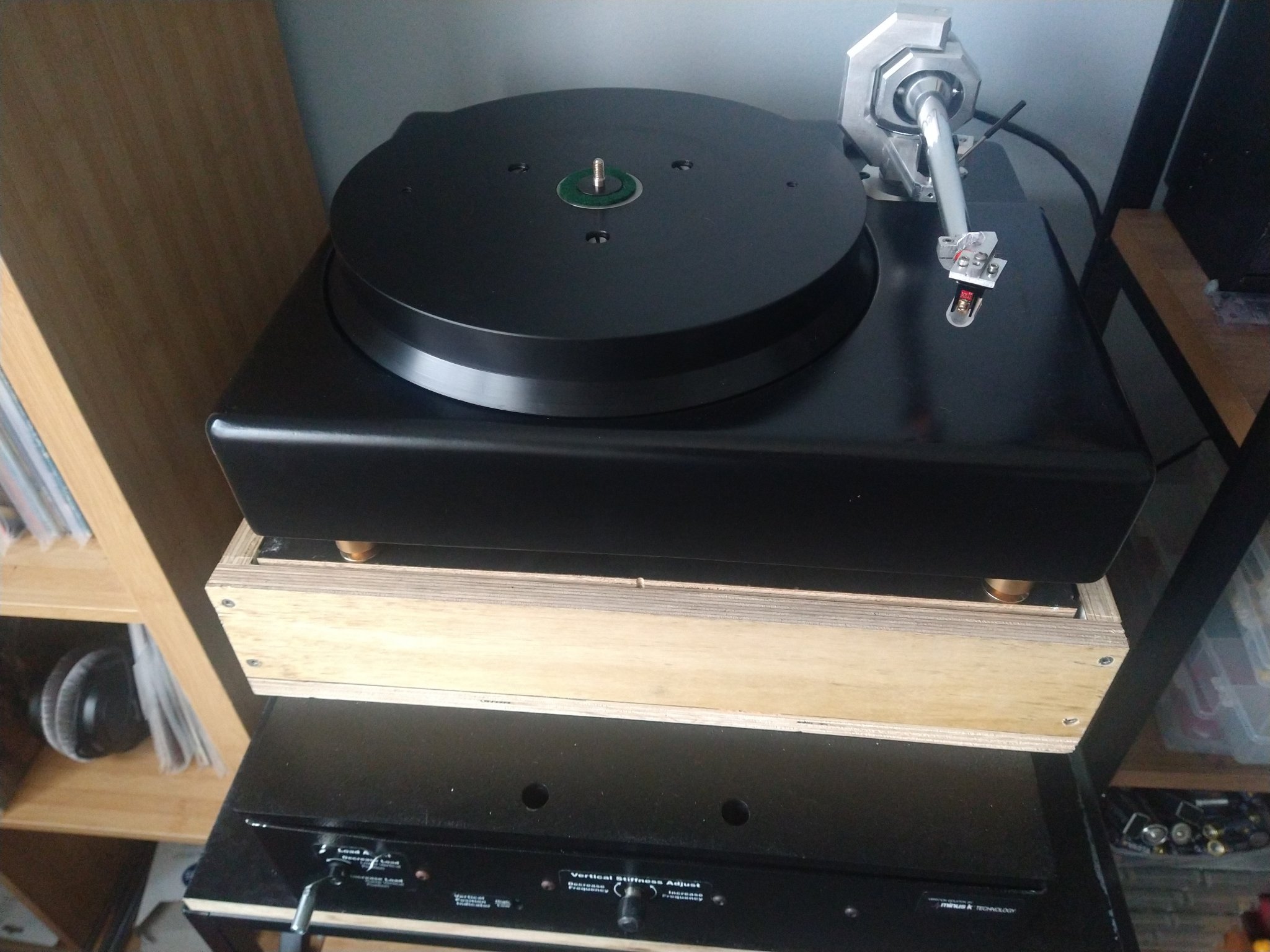

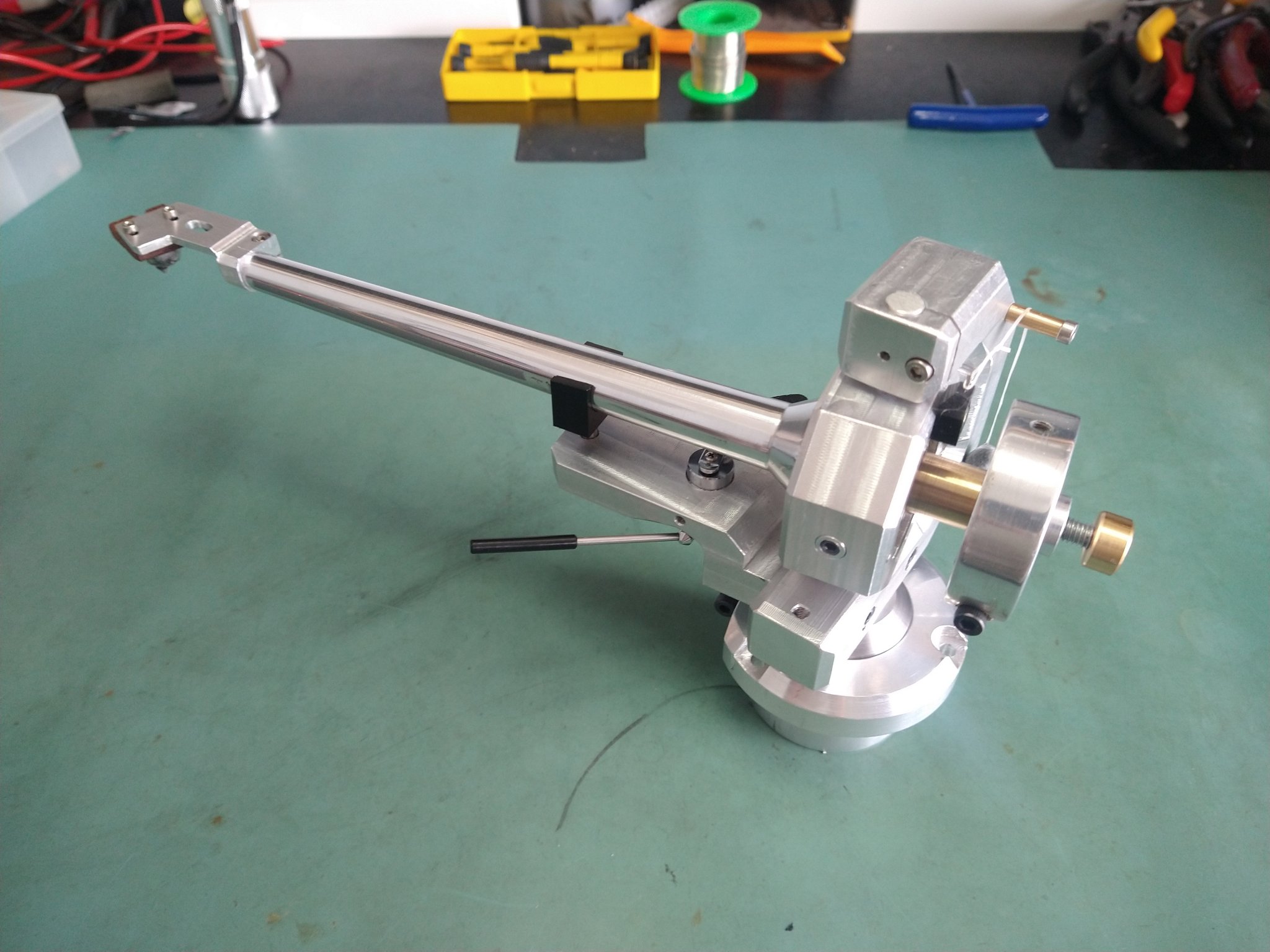

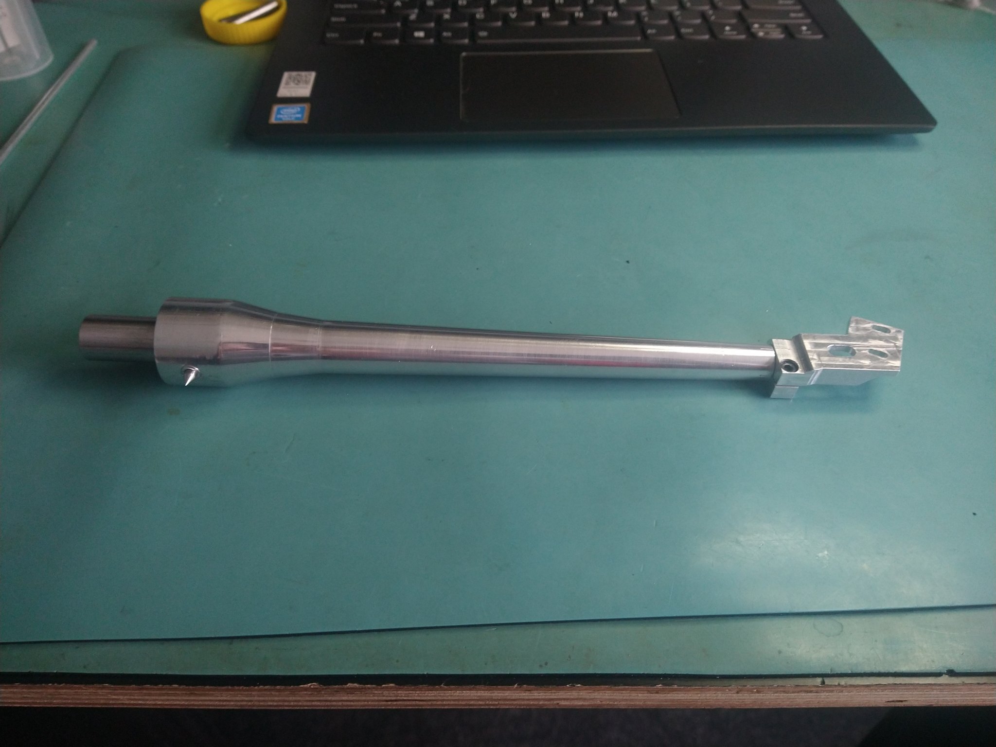

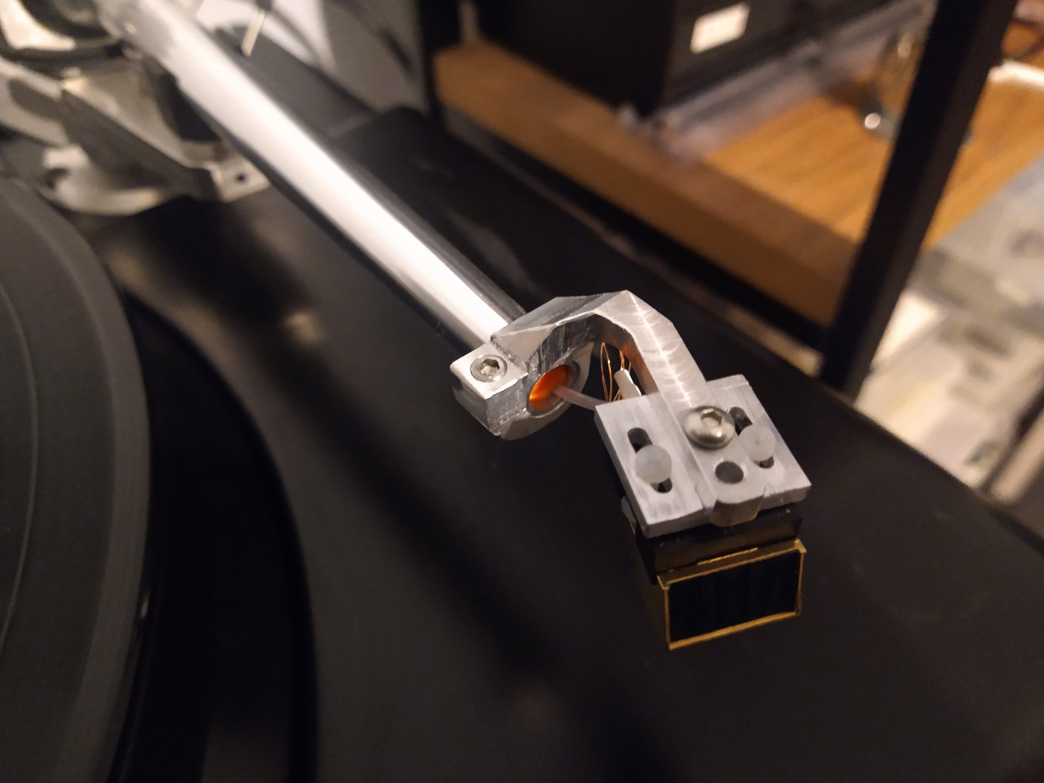

Here are a couple of pics of the arm. I've modified the headshell to make swapping cartridges quick and easy. You can see in the 2nd and 3rd pics there is a removable plate. The cart is aligned in the plate and can be removed and replaced without having to re-align.
