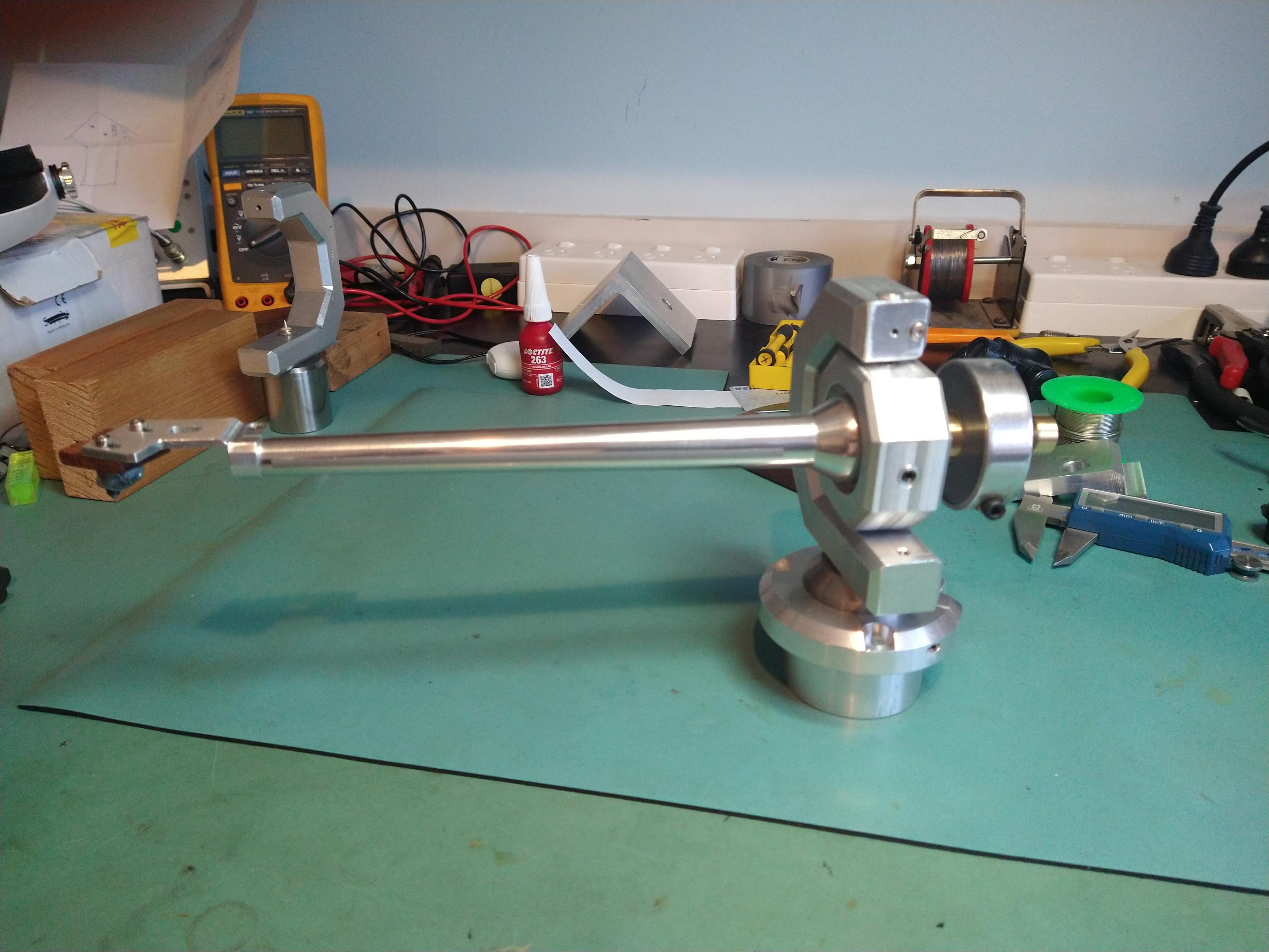

Here is a video I did at the same time as the sensitivity using the Bic pivots. The ONLY difference is the COG of the CW. In the first section there is a carbide end mill on the underside of the CW which is removed and the arm re-balanced.
With the COG in the center of the arm wand it stays anywhere it's put. VTF will be the only restoring force, there is no unwanted movement. Static VTF variation is less than 1 count (0.01g) with a height variation of 8mm.
The seesawing in the first section is IMO a bad thing, any warp induced movement however small will excite the arm into this seesaw effect. The result will be modulation of the audio signal at the seesaw frequency.

I have never thought this. So, your experiments imply that a lighter counterweight but far away from the center of gravity is better than a heavier counterweight but near the center of gravity due to the latter causes of seesawing. Is it possible that your bearing is too tight?
When I designed my air-bearing arms, I purposely designed the counterweight away from the center of gravity. The reason to do that was to reduce the total mass. But later on, I found that doing so didn't make too much of a difference in mass and it makes no difference for air-bearing since air-bearing can take heavy arm.
BELOW or AT center of gravity
You are missing the point. It is about the mass of the counterweight being BELOW instead of AT the center of gravity that created the seesaw effect of oscillation. It is the vertical placement of the mass not the fore and aft of the counterweight. The reason he moved the counterweight further so the arm is balanced to zero so he can demonstrate the vertical movement.
(Most unipivot designs necessitated the use of low slung counterweight in order to stabilize the arm and lessen azimuth rocking but at the same time created this seesaw effect of oscillation on the vertical movement. The Graham Phantom is an exception and is neutral balance but is aided by the use of magnetic stabilizing, for example.)
You probably missed visually the attached metal piece below the counterweight.
No, it won't. The seesaw effect is the natural frequency of the pendulum created by the underslung CWT. When the arm is playing a record, the stylus is in contact with the record surface and it is the compliance of the cantilever suspension acting against the effective mass at the business end of the arm that determines the resonance frequency. The seesaw effect will not affect the resonance frequency but it will cause a variation in VTF with warp height.
You are overthinking this. Get some sleep

I saw the end mill. If the purpose of the test is as you said, the test should be done as follow.
The counterweight should be left on the rear of the arm as it while VTF should be 1.8 g or so. Then, take the counterweight off the arm and use a tape or a thread to hang the same counterweight under the arm. The counterweight is not on the same plane as the arm, but it is in the same position vertically as the counterweight on the arm. Therefore, such a test will illustrate what exactly as you said.
Furthermore, I am not sure about his view on seesaw frequency either.

I tried the same tests on my air-bearing arm since I don’t have pivot arm. Please see the following videos.
No seesaw. You can see the counterweight is on the arm.
IMG 2844 - YouTube
With seesaw. The same counterweight is attached to a piece tape and hang on the same position as it was on the arm.
IMG 2845 - YouTube
My tests have the same results as warrjon's . However, I really can’t say which is good and which is bad. Let’s assume there is warp. The counterweight that is under the arm may introduce a natural tendency to force the arm down. The counterweight that is on the same plane as the arm may lack the natural tendency to force the arm down, but it may have the tendency to keep the arm stable. Which is better? I don’t know. A correct VTF will force the arm down anyhow. Damping and correct VTF are the keys to fight warp. So, it probably makes no difference. If there is a difference, we may have to look at it from different perspectives.

I designed this arm as a precision measuring instrument and the goal is to have the most stable platform possible to hold the cartridge. Basically any movement of the cartridge caused by tracking the LP will not cause erroneous movement.
Even antiskating forces were modeled to ensure this force is orthogonal to the stylus CL. Most pivoting arms the AS force is not orthogonal and generates a vector force.
If we look at the physics of what is happening, an arm/cartridge system can be modeled as a double pendulum.
Pendulum 1 (P1) is the arm with the mass being the cartridge.
Pendulum 2 (P2) is the stylus cantilever, the mass is the diamond and the pivot the CL suspension.
The modeling is complex as P2 is constrained by the CL suspension. So the model will vary depending on what cartridge is installed. On the other hand if the arm is neutral with NO erroneous oscillation it does not matter what cartridge is installed as the arm is stable.
Any oscillation of P1 WILL have an effect on P2. The level of effect will be dependent on many variables. Any double pendulum that is not constrained displays chaotic behavior. The constraint will damp the chaotic behavior but not eliminate it.

Warren, in light of Niffy's point below, I am curious for vertical movement why not use two downward pointing spikes, a la Kuzma 4Point style, to achieve better mechanical grounding because gravity takes care of the loading? I understand you're modeling after the SAT design, hence the scheme. I am always baffled by why manufacturers don't use down-pointing spikes in dimples more. In my own experience, side pointing pivot bearings have a tendency to chatter. If the bearing cap is too tight you have too much friction, too loose you have chatter and slop room. I found spikes and knife-edge bearings a la SAEC/SME to be precise, loaded, and low friction and better mechanical grounding. I believe the use of side pivot bearings with end caps is to avoid the arm being unseated and tugging or breaking the arm wires. There are ways to prevent that in the down-pointing spike method. The other arm example is Origin Live models.
In my opinion the most important aspect of bearing performance is not low friction. It is mechanical grounding, how well the bearing couples the cartridge to the sub-chassis/plinth. There are 6 degrees of movement. You want the arm to move freely in 2 of them and be held absolutely rigidly in the other 4. Spikes/pin bearings are the best way to achieve this.
As I headed down this path I did think about downward facing points this came about when I assembled the arm with the sapphire/carbide vertical pivot the end shake needed was too much, put a stethoscope on the bearing housing and I could hear the rattle ever so slightly. The pen tips on the vertical pivot don't need end shake so no rattle with the pen tips and 8mg of sensitivity.
The other issue I didn't have an answer for was the horizontal pivot, SME/SAEC use ball bearings for the horizontal pivot. This is something I wanted to avoid.
So I decided to forge ahead with this topology.

Here are a couple closeup videos of the CL and cartridge. I did these to view what is happening at the stylus for both vertical and horizontal pivots. Both videos use a Technics EPC205mk2 with Jico SAS stylus and 1.25g VTF.
ATM the vertical pivot is Parker pen tips and the horizontal is homemade carbide in setscrews. The carbide in setscrews works so well I plan to replace the vertical pen tips with this setup.
Vertical shows both neutral and low COG configurations. Watch the bottom of the cartridge as it bounces with a low COG.

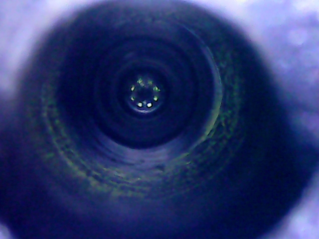

I think someone said earlier about sapphire being very fragile, YEP, I have 1 fractured sapphire pivot. So I decided make my own carbide in setscrew pivots.
The carbide was supplied by a double ended scribe and M4 setscrews.
I made a small jig to forge a 0.4mm radius in the end of the setscrew. The radius in the setscrew is burnished and polished to 0.5microns.
The scribe is removed, radiused (0.1mm) and polished to 0.5microns. For the $10.00 spent and 2 days building jigs and polishing, these work better than the $700 of sapphire/carbide I bought.
Setscrew - the green dots are the reflection of the microscope LED's.

I really appreciate the honesty.The only way of using sapphires is to use big ones which are kind of expensive and really difficult to polish and drill for which you'd need way more expensive jewelry tools.I investigated this path and it would cost around 7....10 000 dollars to make suitable ones from scratch , an investment i couldn't afford...There are still ways of using partly polished industrial ones drilld and cut with a laser.In the end carbide is used since the 70's for toneram gimballs with reasonable success...so no real need to take the most difficult path.I think the swiss Stellavox reel to reel tape machine was the only audio equipment using ruby guides, but reel to rell machine parts don't move randomly or by people's hand, they have very tightly controlled and reduced in length movement.
Maybe it would have been better to use the springed Vee jewel pivots to prevent fractures.
I didn't make the sapphire pivots I bought them from True Point in the UK. They are highly polished instrument pivots.
These DIY pivots have 4mg sensitivity in the vertical plane. Better than most high end tonearms. They are very rigid to go along with the rest of the arm.
DIY Tonearm sensitivity 4mg - YouTube
It's been operational for a couple of weeks now.
Technics SP10 with DIY Tonearm - YouTube
