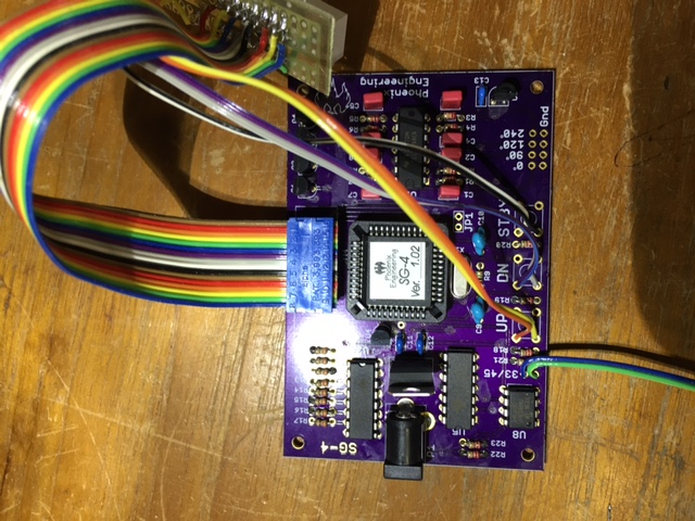

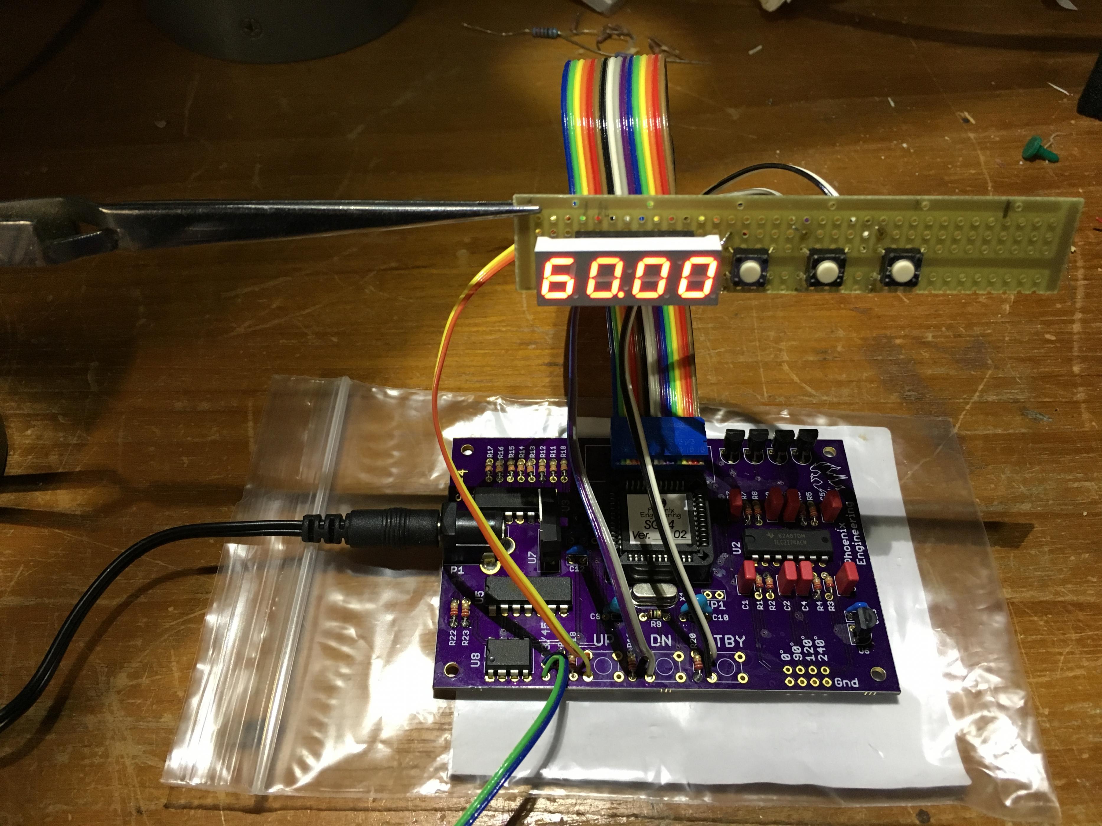

Completed Board
Here's a photo of my completed board. It seems to work perfectly. The extra board for the switches and display is (probably) temporary until I figure out my final packaging.
Pyramid - you have created a thing of beauty!. Thanks for sharing this with the community.

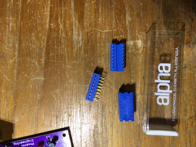

Can you post a picture from the back? I'd like to see some detail on the connector. What is the blue connector called? I asume its available from digikey, i just want to save some time sorting through hundreds or thousands of results 🙂

Rif,
Below are two photos of the connector I used. I actually bought them off ebay since they were pretty cheap there. Mouser had them also as I recall, but these were an after thought and Mouser was about twice as expensive (even with shipping) anyway.
