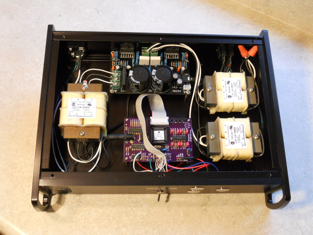

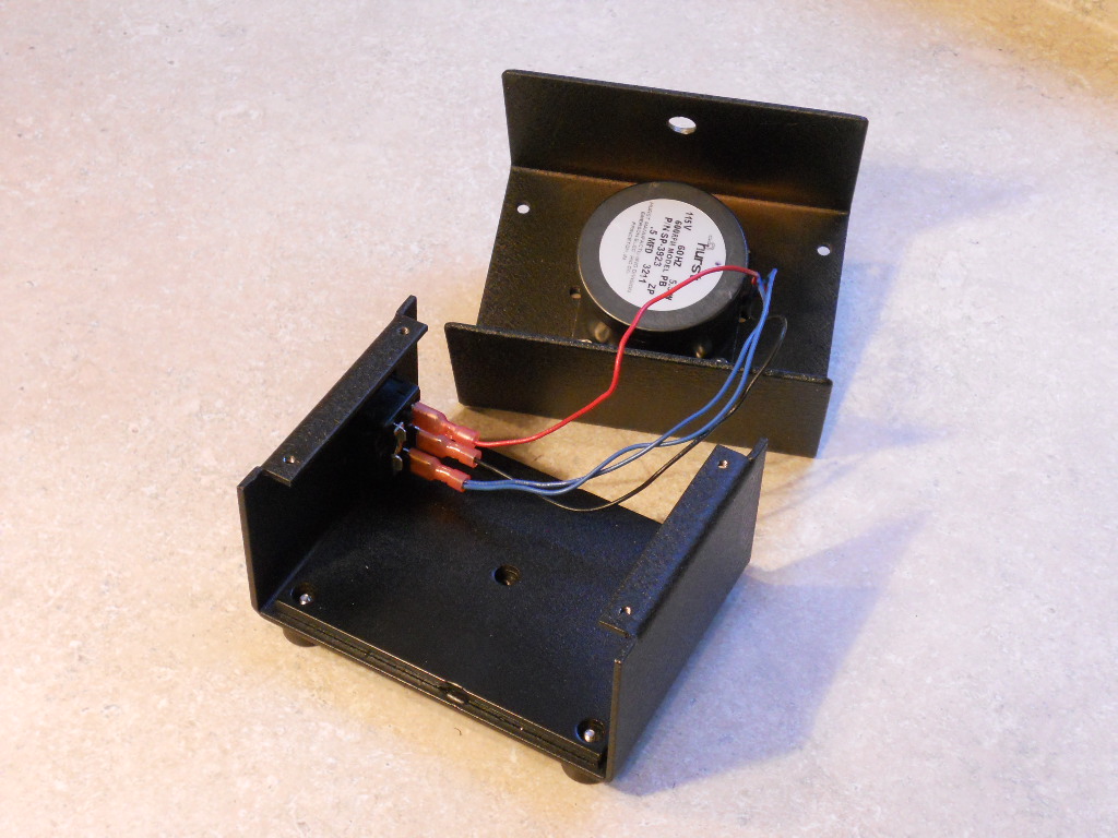

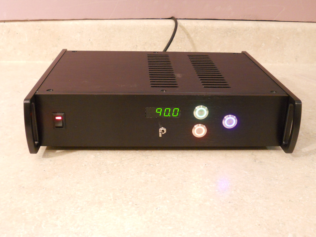

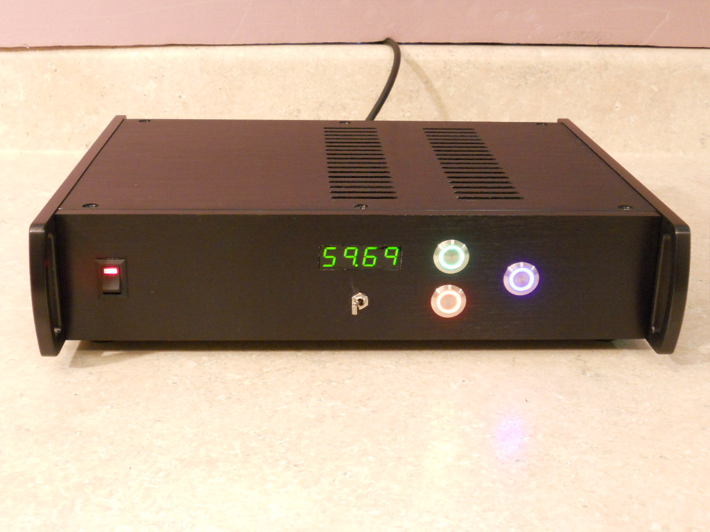

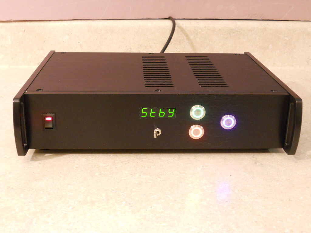

This is my version of the SG4. I built the dual phase version using the MK154 amp for use with a VPI Scout table. I bought the case on e-Bay and machined the front panel for a remote mounted LED display. The 3 lighted buttons parallel the buttons on the PCB: Green for UP, Red for DOWN and Blue for STBY. The toggle switch changes between 33 and 45 RPM.
That is a very professional looking DIY project , nice job.
Have you had a chance to try it yet with the Hurst motor.
Wow that is nice! Can you talk more about the machining? That's where i always fall down in my builds.
Yes, I'm using it with my VPI Scout w/Hurst motor. 33 RPM works perfectly and it is easy to dial in the phase for lower vibration. At 45 RPM, it works but not all the time (sometimes the motor does not run). I've been playing with the brass collar on the motor; that seems to have some effect on it.
All of the components are mounted on stand-offs on the floor of the case. I marked the hole locations for the circuit boards using a sharp pencil in the mounting holes in the PCB. From there I center-punched and drilled the mounting holes. I marked the mounting holes for the chip amps after the PCB was installed on stand-offs. This requires the case to be assembled-disassembled several times, but it results in accurate placement.
The holes in the front panel were the most difficult, especially the rectangular ones for the power switch and the display. I traced the outline of the display with a pencil and I started with small drills and worked up to the larger diameters in several steps. With most of the metal removed by drilling, I used various files to flatten the opening and square the corners. The round holes were easier, but I drilled them in several steps starting with 1/4"->3/8"->5/8".
Good to know, kind of surprising though.
I have my custom built deck driven with the Hurst running from a Eagle PSU and it works every time on 45 RPM.
It does make some cogging noise though until it gets up to speed though
If you do not mind me asking, do you have PNs and source for the push button switches?
