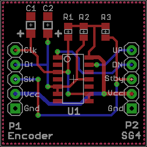

I just uploaded the PCB files to OshPark for a Rotary Encoder to SG4 interface PCB. The circuit converts the 2 quadrature signals from the encoder to a single pulse train on the UP pin when turned CW and a single pulse train on the DN pin when turned CCW. The momentary push button switch of the encoder is connected to the STBY button of the SG4. This allows all of the normal operating functions to be performed by one rotary control.
The 1 inch square board uses all surface mount components in order to keep the size down. The IC is a CD4013 in SO14 package. C1 and C2 are both 0.47uFd Tantalum caps 10V rating. R1, R2 and R3 are not necessary if you use the Arduino Rotary Encoder which has the pull up resistors already on its PCB. If you use another encoder without pull ups, add the 3 resistors (all 10K 0805 size). Vcc is connected to the 5VDC output of the regulator on the SG4.

Are these caps ok for the rotary encoder board
http://www.mouser.com/ProductDetail...=sGAEpiMZZMtZ1n0r9vR22ZBQR9LXYg3mvJYHfNO12MM=
The PCB is laid out for SMT parts, so something more like this:
http://www.mouser.com/ProductDetail...=sGAEpiMZZMuEN2agSAc2pmRv4r8cj6yFk1V36MciNnk=
The caps are polarized so please observe the '+' polarity marking on the silk screen.
