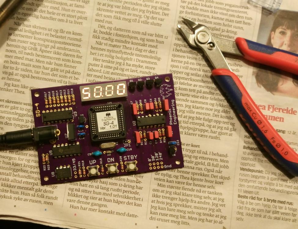

I just finished mine. Received both the parts from Mouser AND the letter from Ralph today.
Built it on the kitchen table. Powers up nicely. I don't have a scope so I can't really say if it outputs anything, but the display and switches work as described.
Thanks a lot! Both to Ralph in the UK and Pyramid and others involved in the project on the other side of the pond.
As mentioned earlier I ordered some other capacitors. I had to bend the legs a little, but it worked out OK, as you can see.
