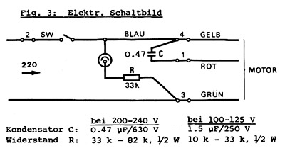

Configuration for a TD-124
I ordered the parts to build an SG-4 for my TD-124 mk II.
It has a single phase motor which has a capacitor on one of the windings.
The diagram is shown below.
Would I connect the 0 degree output to position 4-3 and the 90 degree output to position 1-3?
Since there is only one switch I would need to wire in a relay so I could switch both 0 and 90 degree outputs together.
Alternatively would I just leave the cap in place and connect the 0 degree output to position 4-3 ?

From your diagram it looks like your turntable uses the three phase Papst motor. If this is indeed the case then you will really benefit from driving it with a proper 3 phase supply.
Have a look through this thread to get a handle on what can be done
http://www.diyaudio.com/forums/anal...riving-vpi-synchronous-turntable-motor-4.html
No, it is the single phase motor like this one.
It just has a motor start winding with a capacitor.
OK, we're mixing things up a little here. The wiring diagram you showed corresponds with the use of the 3 phase Papst motor which I think you found on the Soundfountain website,and unfortunately took a little out of context.
The picture you showed after is of the E50, but the E50 does not have a 0.47uF capacitor between phases, indeed it does not have phases, plural, only 1 phase and the only capacitor is a 0.01uF across the switch contacts.
You need only build a single phase power unit for the SG4 for your your TD124, and the output can be connected directly to the wires that currently conect to your wall socket. You may gain a little extra smoothness from the regenerated power supply, but the main advantage will be the stability
That's an E50 shaded pole induction motor that was standard in the original 124 and the MKII. I have both a 124 and a 124 MKII with this motor, and I also have a 3 phase Papst that I am eventually going to install in my MKII with a 3 phase supply based on Pyramid's board.
The E50 is single phase and requires only one phase, the windings are wired in series. In fact make no modifications to the table's wiring and just use the 0 degree output of the sinewave generator to drive a 50W amp into a good 50VA EI step up transformer. (This what I currently do in a homebrew sine wave source for the MKII)

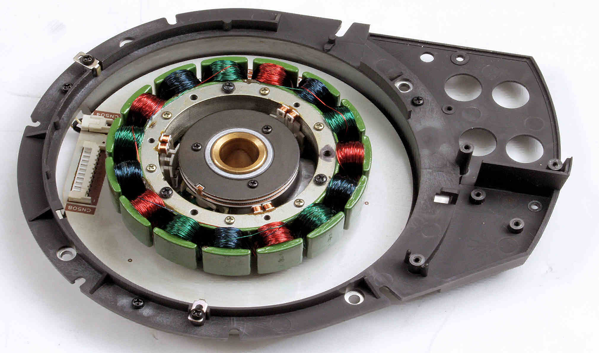

SG-4 to drive an SP-10 MkIII
I just purchased an SP-10 MkIII sans power supply
The Mk III uses a 15 pole, 3 phase motor (picture below)
I also recently purchased an SG4 kit and was thinking I could drive the SP-10 with it using the amp and transformer set up.
The motor supply voltage from the technics service manual shows +/- 32 Vdc going to the motor bridge.
While the SG4 would not have the Quartz PLL It seems like it could run the table without it.
Since it is a 15 pole motor would I need a SG-4 chip programmed for a lower frequency ?
The SP10 is a direct drive motor. It will spin at the platter speed or 33 RPM and would most likely need a frequency of <1Hz. No, the SG4 is not suited to drive this type of motor. It is for belt drive tables with 600 RPM motors.
