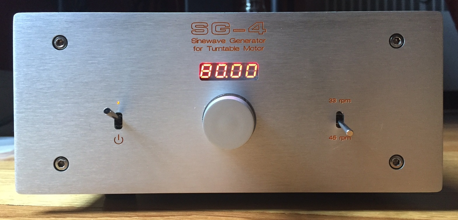

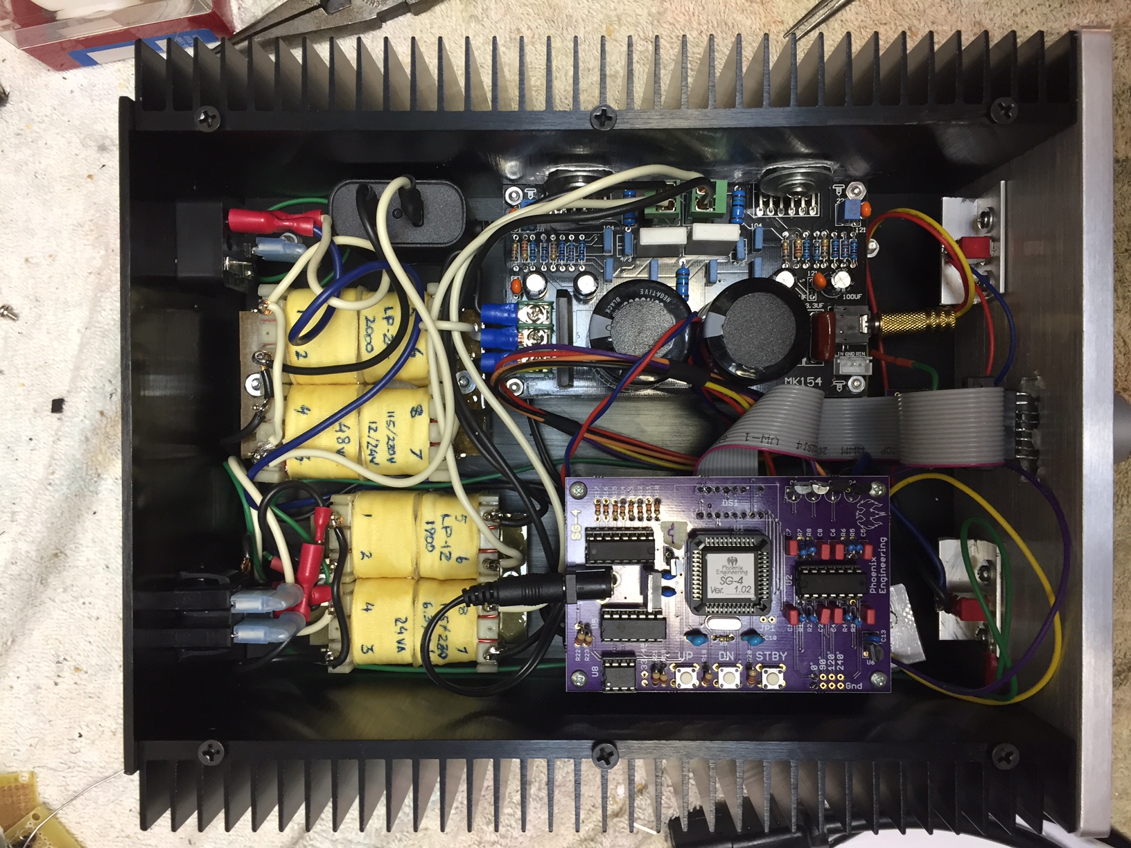

I worked from home today and took a break to complete the corrections to the SG-4. Additional 1k resistors were added, the voltages at both 60hz and 80hz were adjusted and everything is working beautifully.
I'd been agonizing over your Falcon for a few years and was thrilled when you announced the SG-4 project. The SG-4 fills a void (albeit one of your own creation -- a superior, affordable turntable motor controller). diyAudio is a far better place because of the generosity of people like you and I hope you find retirement to be a happy, productive time. Thank you for making this project available!

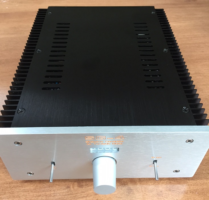

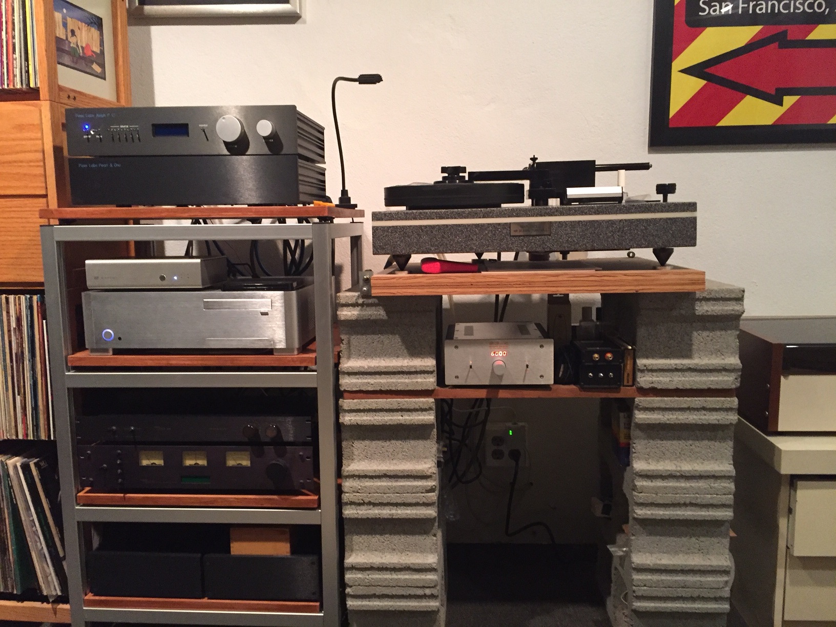

Love your engraving work and case tweaks. Very slick! Nice turntable build as well. My own setup is almost as messy as Mike Fremer's basement.
And it seems you're close by to me as well. Nice! If you had any of your casework done locally, please do let me know. If cash ever frees up (HAH!), perhaps I could get some beautification done.

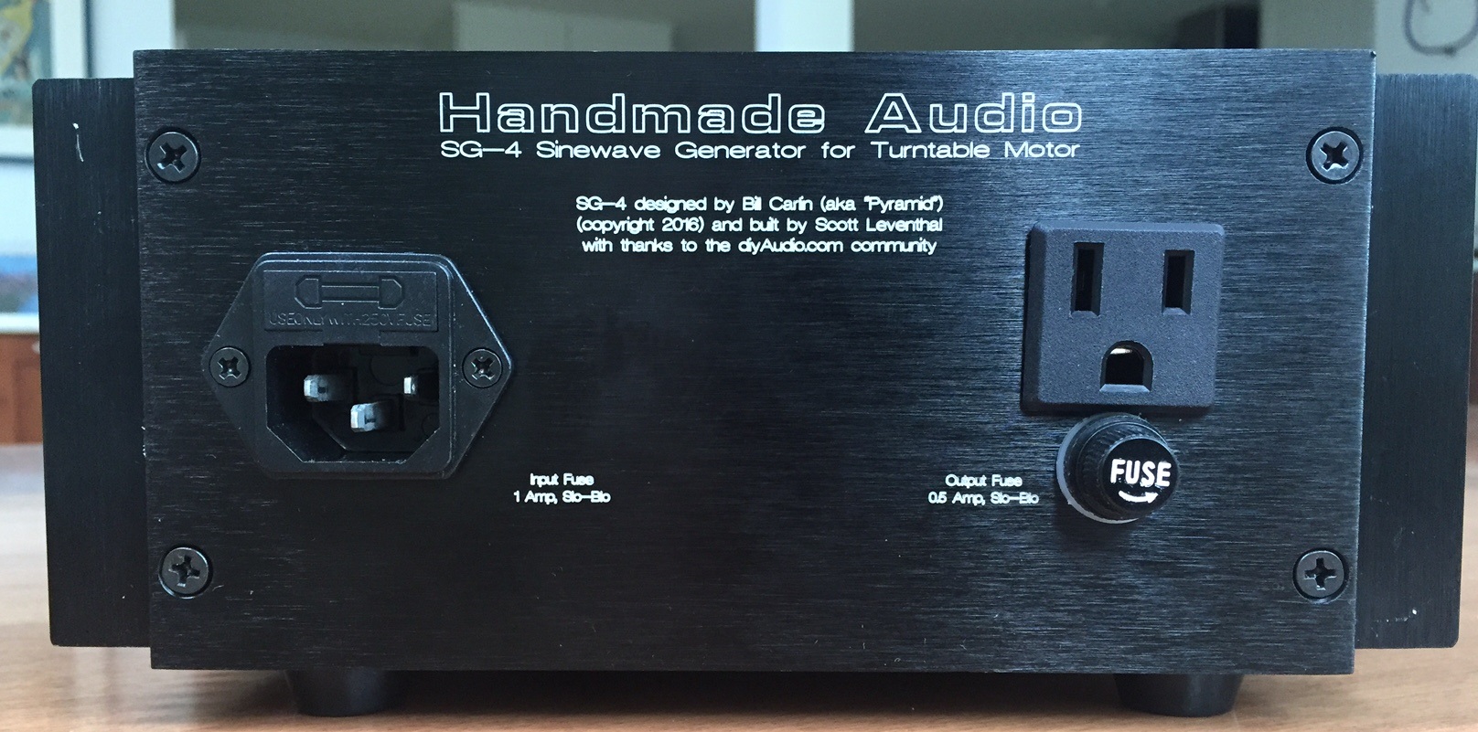

Pyramid:
Front Panel Express. I've been using their services now for about 10 years. Their prices are a little high but I don't build that many projects and tend to use what I build for a long time, so things even out. Given my general lack of knowledge about circuit design, focusing on the cosmetics (as lame as that might be) helps me to personalize the things I build.
If anyone is interested in my .fpd files, feel free to PM me.
