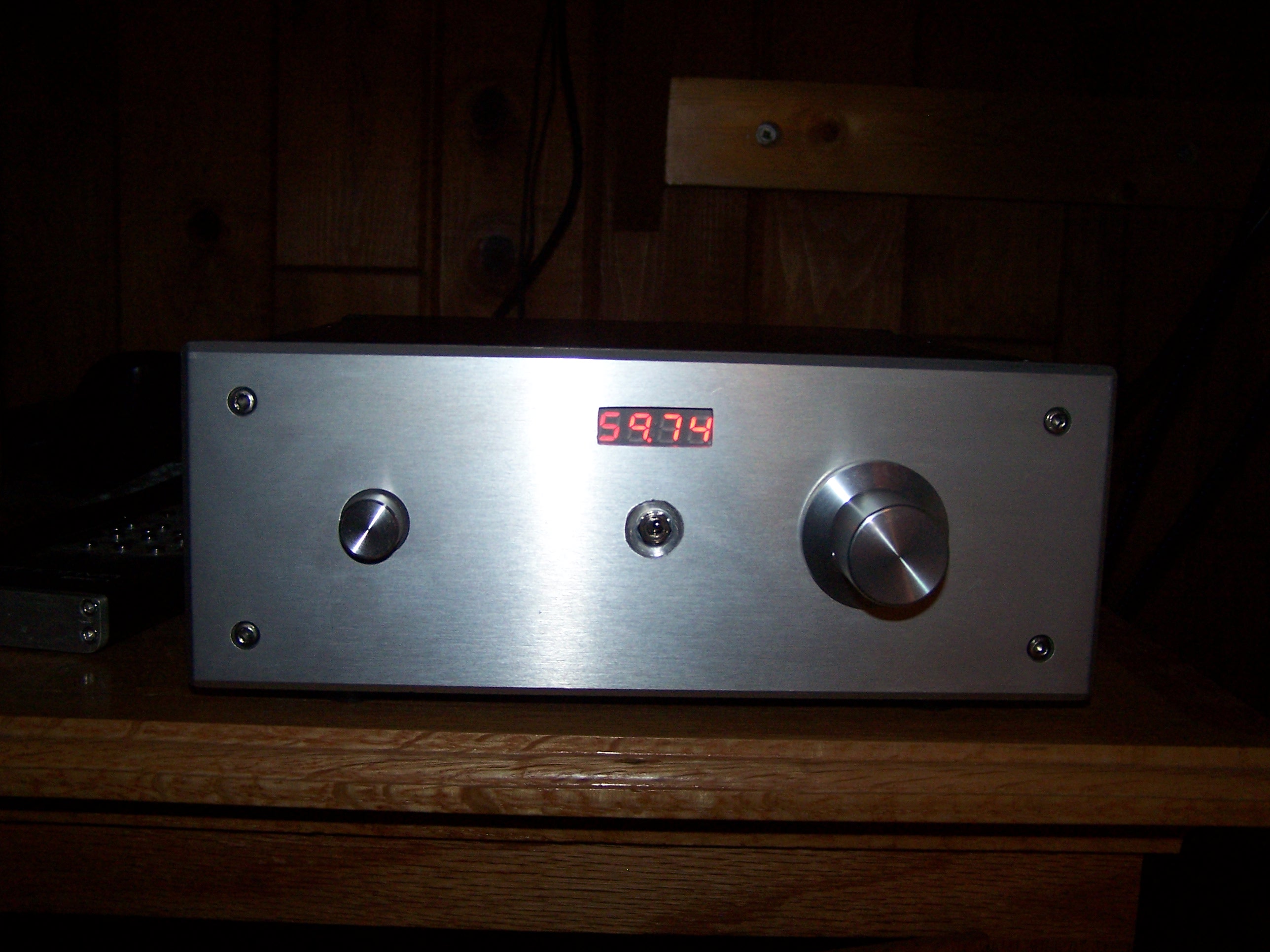

This thing is pretty amazing for the money involved.
Ran it last night for a few hours and had the Roadrunner checking speed.
Once it was dialed in, it would float slightly by a few digits in the thousands display.
And I built it with my own little hands, a few swear words and updated seeing aids.
Thanks, Pyramid, hats off to you sir
Greg
