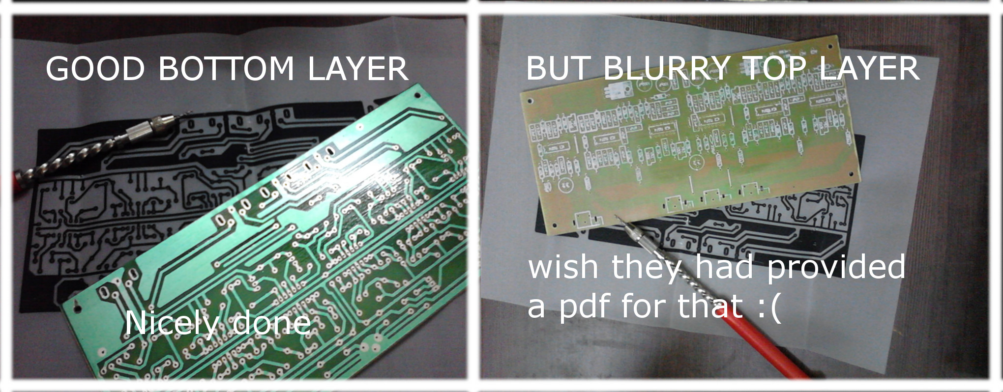

I've finished the PCB just now with the help of a friend.
Bottom layer is okay.
The drill reference points I made are okay too.
But the top layer is blurry as expected 🙁

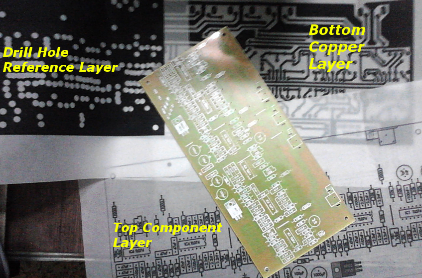

Here is the Photo of 3 layers of the PCB, an example in case anyone makes the board with silk screen printing.
1. Bottom copper layer: Provided by the Author in the download.
2. Top component Layer: Provided by the author in the download and given only as a reference by the author to DIY-ers.
I resized, edited and aligned to fit the size of the PCB in my personal hobby project.
3. Drill hole reference Layer: I made it following the original author's design as I wanted to give the PCB a professional look
This layer can safely be ignored as redundant.

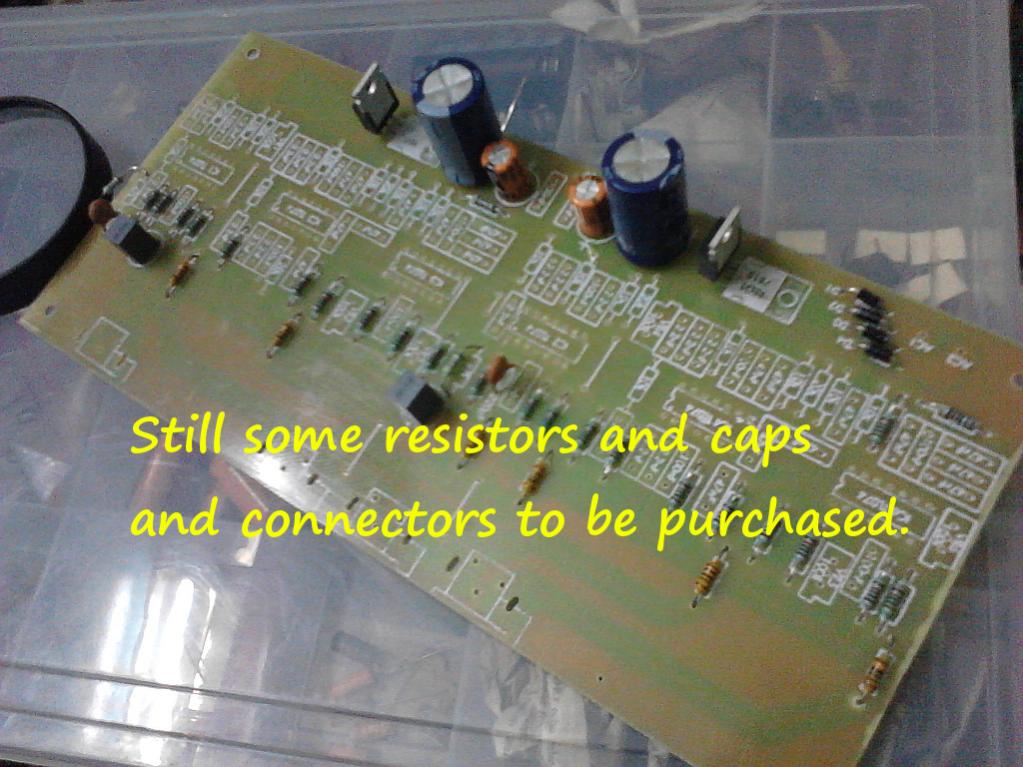

Anyways, I started populating the components and now, I found I have not enough stock of 1% metal film resistors and the 2.2nF box type caps. So the progress is slow for the time being. Perhaps it will take some two days more to obtain the remnant components.
I have one question. The vendor is charging me INR 1 per metal-film- resistor seeing my hobbyist-need. Do you think this is a fair price?
And according to you, what is expected price of the box caps ? ( I was charged @INR 4 to 7 per piece earlier depending on the value)
Here is the photo of the progress of my work so far. 🙂

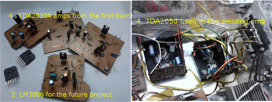

.........Which amps are you going to use with this?
thanks,
Bibin
I have 4 TDA2030A amps that I made earlier. And 4 TDA2050 Amps are being used in the system. ( note to self: "never ever use TDA2030A amps. They ARE evil. You will simply fall in love with their sound quality and straightaway discard all your discrete high end commercial music systems that you earned with your hard earned money and then you will upgrade to TDA2050 in need of greater power". 😛). I bought 2 LM3886 ICs for the forthcoming project. ( Wow! Another audio fanatic has found home here in DIYAudio forum, it seems 😛)
So at present I will play with them after the completion of this xover. .
But as Mooly, our respected and experienced moderator, suggested, after I asked the identical question, I will do a comeplete switch over to 6 LM3886 based amps. But that will take some time due to the cost factor involved. 🙂
