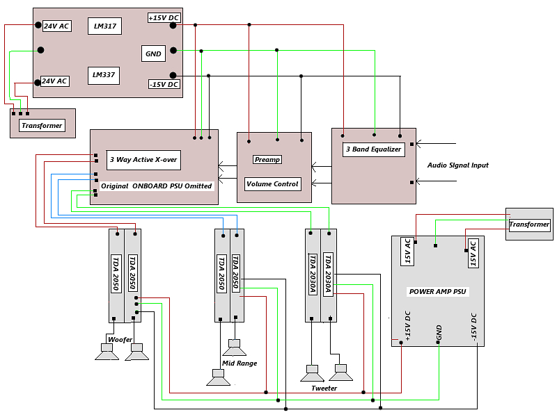

I want to build the power supply like this attached picture.
Could you please tell me if this is possible or not?
Better to use different one trafo for preamp and xover and another for power amp. Your suggested Idea will also work but connect the wires directly to trafo, means all wires from pcb directly connected to trafo instead of one pcb to another.
thanks.
sudhir.
................./QUOTE]
Okay Sudhir,
I tried powering them all with a single Transformer but a Hum appeared in the sound.
So I changed everything and removed the power supply of the Original design of the X-over and getting Power from the Preamp power Supply. Things are working normally now for last 15 minutes or so and Hum is gone now.

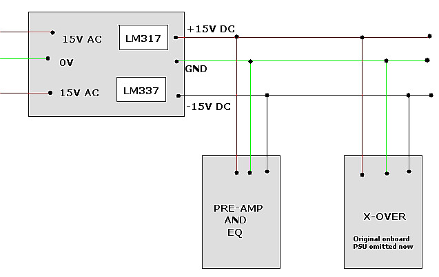

Can I use Dual Potentiometers in lieu of those Variable Resistors and discard the volume control of the Power Amps since I already have a Volume control in the Preamp ?
Oops, I forgot to attach the pic 🙂
Here is the common Power supply section of the EQ, PRE-Amp and X-Over thats is being used now.

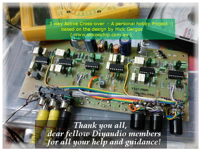

Dear friends,
I am am very happy to inform all of you that the project has been successfully executed with all your always extending kind helping hands.
A big thank you to all of you. ( including dear Santa 🙂 )
Also my heartfelt thanks to Mr. Mick Gergos who painstakingly designed the corss-over and thoughtfully documented everything and kindly provided the much needed download files here Silicon Chip Online - Active 3-Way Crossover for Loud Speaker Systems .
Thank you really so much www.siliconchip.com.au for the support that you constantly provide to the hobbyists "to build for their own use".
Wish you all a very happy and prosperous New Year from the core of my heart ! 🙂

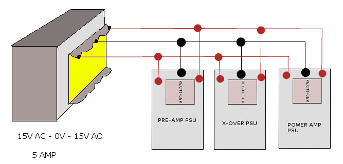

no.
You have connected the centre tap to all three PSUs.
This means you cannot later connect the audio grounds together without creating a ground loop.
BUT your linked PSU centre tap carries charging pulses. This is a contaminated ground.
Do not do it your way.
no.
Thank you Andrew for your wise explanation.
I have not implemented that after I found a lot of hum appeared due to the "contaminated ground" in that connection, as you have very aptly pointed out.
similar mistake in post67.
Multiple grounding creating loops.
I am now using a common PSU for the Equalizer, Preamp and the X over and another for the Power Amplifier section which is now isolated and placed on a wooden board for the time being.
And interestingly, there is no hum or any kind of noise even after a continuous running of some 12 hours. I am just trusting my ears as I have no oscilloscope or other tools to identify the noise figure if any.
So I want to continue with this arrangement until A problem occurs.
But still I want to know what, according to you, is the ideal Power supply arrangement in this case? Do you recommend individual transformer for each section?
Thank you so much again for your valuable words.
I have not implemented that after I found a lot of hum appeared due to the "contaminated ground" in that connection, as you have very aptly pointed out. ...............
Yet you left that post there for all to see and commented that you had completed your project.
Do you expect that some Members read both posts and would copy what you posted?
Tell them what does NOT work is just as important as telling them what does work.
TELL THEM !!!!
Main Audio Ground (MAG).
ONE and only one MAG

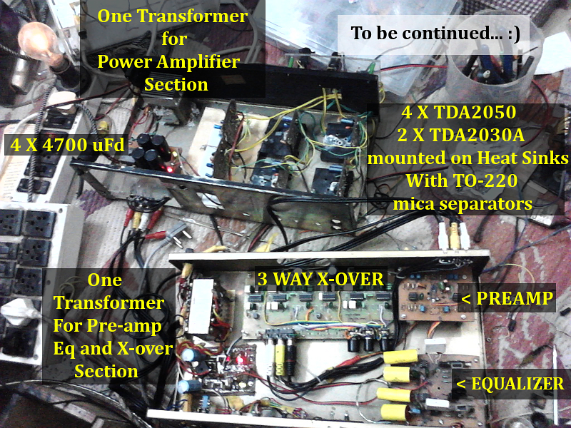

Okay, here is the complete arrangement of my amp that is performing impeccably with only two transformers for me, in my case, since last 24 hours or so.
No hum, no hiss, no unwanted noise, very quiet as usual.
Here is the real thing right at this moment.
Still lot of works, lol! 🙂
Any DIY suggestion for the front plate ? Please feel free to suggest/guide me 🙂

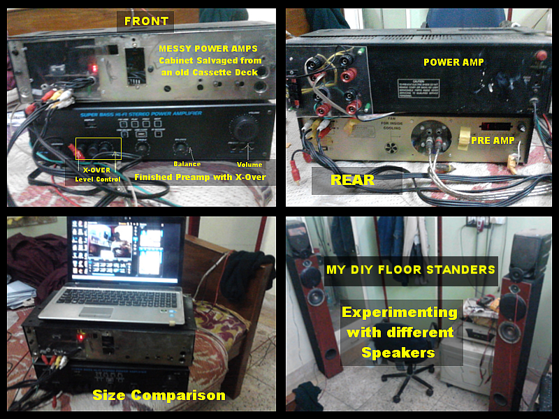

Please share you speakers / entire setup photo also.
sudhir
Okay Sudhir.
Though the amp setup is not aesthetically pleasing yet, but as per your request and with the excuse of my being a DIY noob, here are some photos. 🙂
I added 3 potentiometers, instead of the preset variable resistors, to the front panel of the preamp section in a separate cabinet. This is mainly because I have no audio oscillator and a good multimeter to check the signal level as suggested in the site. So I am doing it with constant trial and error method and trying to guess what is optimal for me. But I can say that now I have a way better control over the individual BASS, MID and TREBLE range.
Earlier I said that the Car Speakers are good in a near field listening environment. They offer very good clarity for sure but, to my utter surprise I've found that normal speakers are better in my enclosure as far as the creation of sound stage is concerned. I used two full range speakers for the mid-range from an old and obsolete music system. Please note that this is my purely subjective opinion after a lot of listening from DIY standpoint without having access to any measurement tools.
