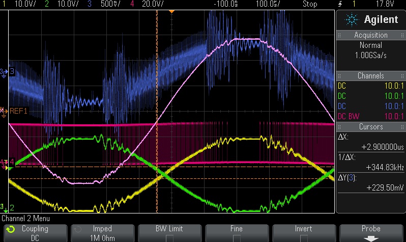

I believe TDA7498 is a self-oscillating class d. The switching frequency decreases to zero when output near clipping as shown in the figure below.
CH1 & 2: output + and - (after output filter); CH 3: inductor current; CH 4: output PWM waveform. Math channel = CH1 - CH2
As can be seen, PWM frequency drops to DC during output clipping.
