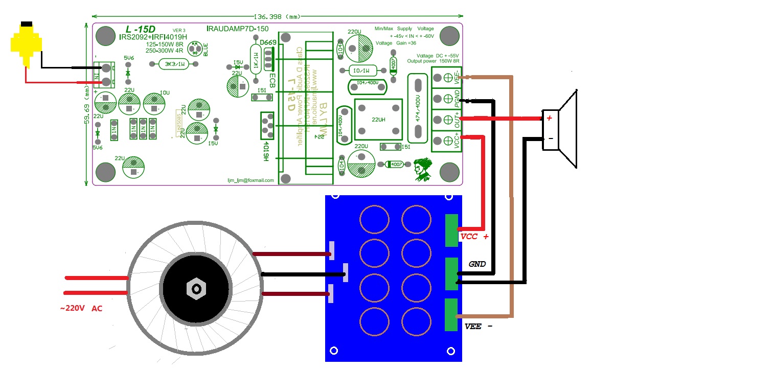

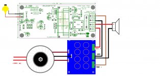

Hello!, I'm sorry to use this tread but I don't know how to connect my new L20D ... The pinout on ebay page was not very clear... +70V to VCC+; -70V to VEE- and ground to PGND? The speaker + to OUT+ and speaker - to PGND?

In free time I draw a picture, may help.
By the way, power and voltage is connected.
L15D work 40 to 60 V DC (+-)125-150 W8R
L20D work DC 60-80 V (+-)200-250 W8R
According to from already the need to choose the better.

L20D near power position has two 80 V150UF capacitor, they need more than compression VCC +
The voltage between GND.
Some 63 V22UF capacitance they work voltage is low, only need to more than 25 V is enough.
22 UF capacitance need high frequency, LOW ESR.
In addition L20D has a resistance, the default is 470 OHM. Can set PWM frequency
About 470 R = 550 K, 330 R = 440 K, 300 R = 400 K HZ.
