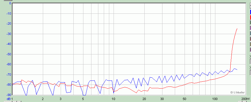

After being prompted by Saturnus, above, I decided to buy a more sensitive 24bit analog to digital converter for my Distortion tester setup.
It is very hard to measure distortions around -80dB, which are already 10dB down on full scale (instrument overhead), and at the 1watt level, 40dB down from that. The 16 bit D-A converters cannot handle the dynamic range, whereas my new 24bit converter can resolve down to a noise floor below -120dBm.
So I measured jlw_jlw's L20D again, the low cost IRS2092+IRFI4020 design. I increased the supply voltage capacitors to 100V rating, 330 uF, otherwise the boards are unmodded, exactly as received from Zoe on Ebay.

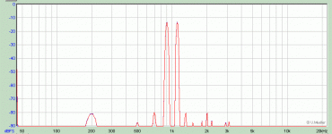

The two-tone Intermodulation distortion at 35 Watts into 8 ohms, 1KHz, (attachment 1), is as clean as one could expect from a high quality switching amplifier (compare it with the plot from the TDA7498 which I posted in another thread earlier today).

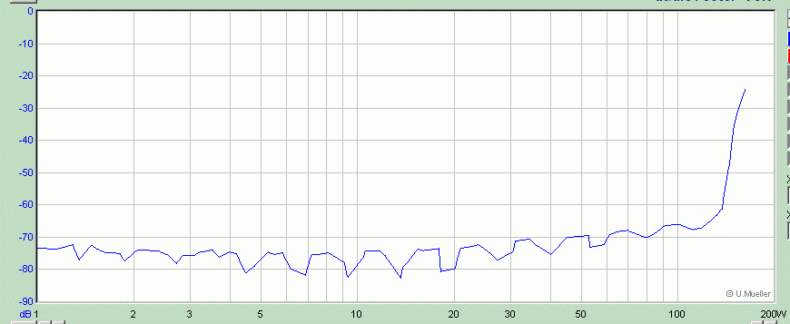

With the higher resolution A-D converter, the distortion vs power curve resolves noise-free by comparison with the curves I posted to begin this discussion thread. You can notice the quantization dither changes from step to step as the input level was incremented to move us across the curve from low to high powers. The supply was a real-world 100W toroid supply with 88,000uF total capacitance, giving 50-0-50 no-load. I used an 8 ohm load for these tests.
I have mentioned the quantization error, when looking at a signal with this level of precision. In order to investigate further, I displayed the 2nd and third harmonic distortions only (red=odd order, blue=even order). It is interesting how the IR quantizer is dithering the second harmonic distortions more than the higher (odd order) components (odd order usually created by clipping, such as at the 100W+ power levels here).
When measuring a switching amplifier with this amount of dynamic range I could obtain a smooth curve by spline-smoothing the data points, or by applying an A-weighting filter (or indeed some other weighting) prior to measurement. I don't do that sort of thing, so my curves will always show exactly what is present, rather than smooth lines 🙂
Anyway, that's my summary of the L20D, IMO a superb amplifier implementation, clean, stable, and simple. It is also cheap and easy to replace the power chip. I would like onboard speaker protection, as well as IR's overcurrent/overvoltage protection circuits to be added, but as a high-end switched amplifier, I am very happy with this one. Two are going into my new MinDSP-based electronic-xover amplifier system (the one with Linkwitz Pluto-like speakers) 🙂
ps: -60dB = 0.1% while -80dB = 0.01% distortion

UPDATE - two minor errors in the post above. Obviously it is a LACK of dither on the even order delta-sigma error components which would lead to variation in the quantization distortion from step to step. Secondly, I wrote the designer's name incorrectly, the author of the L20D design is DIYaudio member ljm_ljm. More info on the amplifier is in this thread: http://www.diyaudio.com/forums/class-d/191739-my-design-l20d-irs2092-irfi4020h-200w8r.html
Incidentally, I did experiment with a number of inductors, including the Sagami 7313NC, 7B12 series, as well as ICE Components 1D14A-220M and 1D17A-220M and I can confirm figure 31 of the iraudamp7s.pdf document showing the THD with different inductors. The one which ljm_ljm chose is indeed the one with lowest distortion at power - the 1D17A-220M.

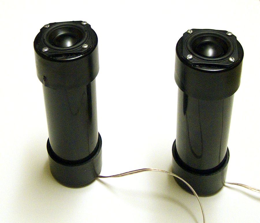

I am sorry, I don't feel comfortable quoting noise levels on amplifiers as good as the L20D. There are too many variables, weighting/no-weighting, etc. I did put a small speaker on an L20D module, and with my ear in the speaker I can just hear a high-harmonic 60Hz 'buzz' from my mains power supply and/or random signal pickup / ground loops / on my workbench -- along with a predominantly low frequency pink noise hiss which is barely audible.
As far as I am concerned, it has no noise, nothing you can hear 1 foot from a speaker in a 30dB listening room. But your measuring preferences may vary 🙂
True, the widerange speakers I stuck to my ear are 84dB/W, Peerless 830983, But they cover from 40Hz to 20K, as long as you don't want a lot of volume... and as long as you use a MiniDSP to equalize them 🙂
These days I myself would select a higher power, highly efficient amp (like the L20D) and a wider range, very low distortion, speaker 🙂
Still, 113dB/W is a pretty impressive achievement 🙂
