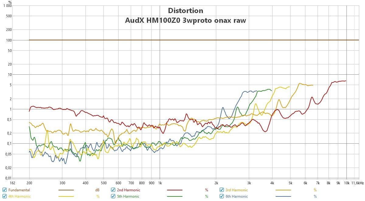

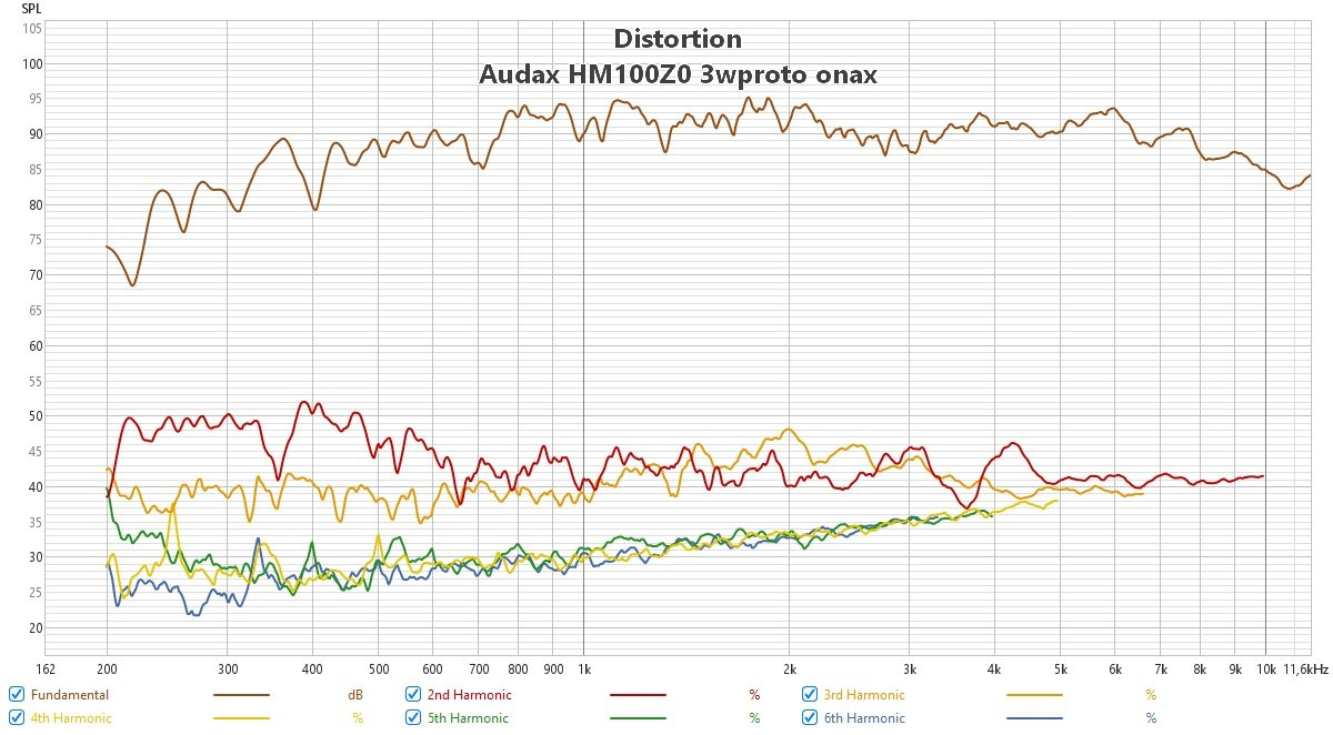

Again same driver in a proto 2014. No eq or xo applied. The proto box was large sealed with polyfill stuffing. Differences are in details, general behaviour is similar. This spl is again too low to search for maximum spl, just a sanity check when doing directivity measurements. With REW it is easy to do several succesive sweeps and let the program to calculate means, which reduces noise artefacts remarkably.
Like Charlie said, odd order distortions should be lower than even, and no peaks! Here 3rd exceeds 2nd 1500-3000Hz. Most likely attachment to the proto baffle was not tight enough.

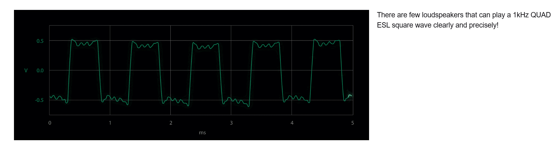

I have designed speakers to have accurate Square Wave response but this did not result in better sound.
Hi ! thanks a lot and this is unfortunate Another test that cannot be correlated to sound quality Personally i had hope for SW being useful after reading some advertising using a good response to SW as a selling point for speakers
I remember Redheko speakers for instance
But also Quad has a good square wave response
https://soundodyssey.be/en/audio/speakers/quad-esl-2912/
this is very bad because SW test is extremely easy to carry out

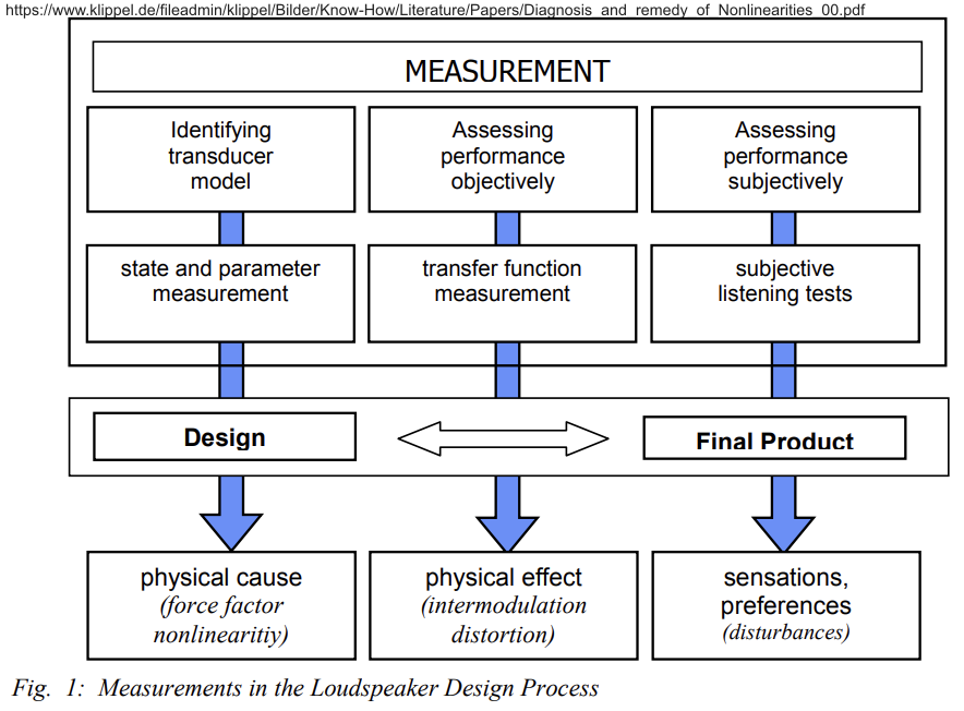

Good to know I wonder about priorities now Ok FR is clear than maybe CSD dispersion on H e V directions
As i asked above i would like to check the dynamic abilities/limits of a driver first and a speaker later
because drivers selection comes first
The most important 'measurement' is a Double Blind Listening Test. This is VERY expensive & difficult to do properly so we only test 'good' speakers; ie ones which don't sound poorly.

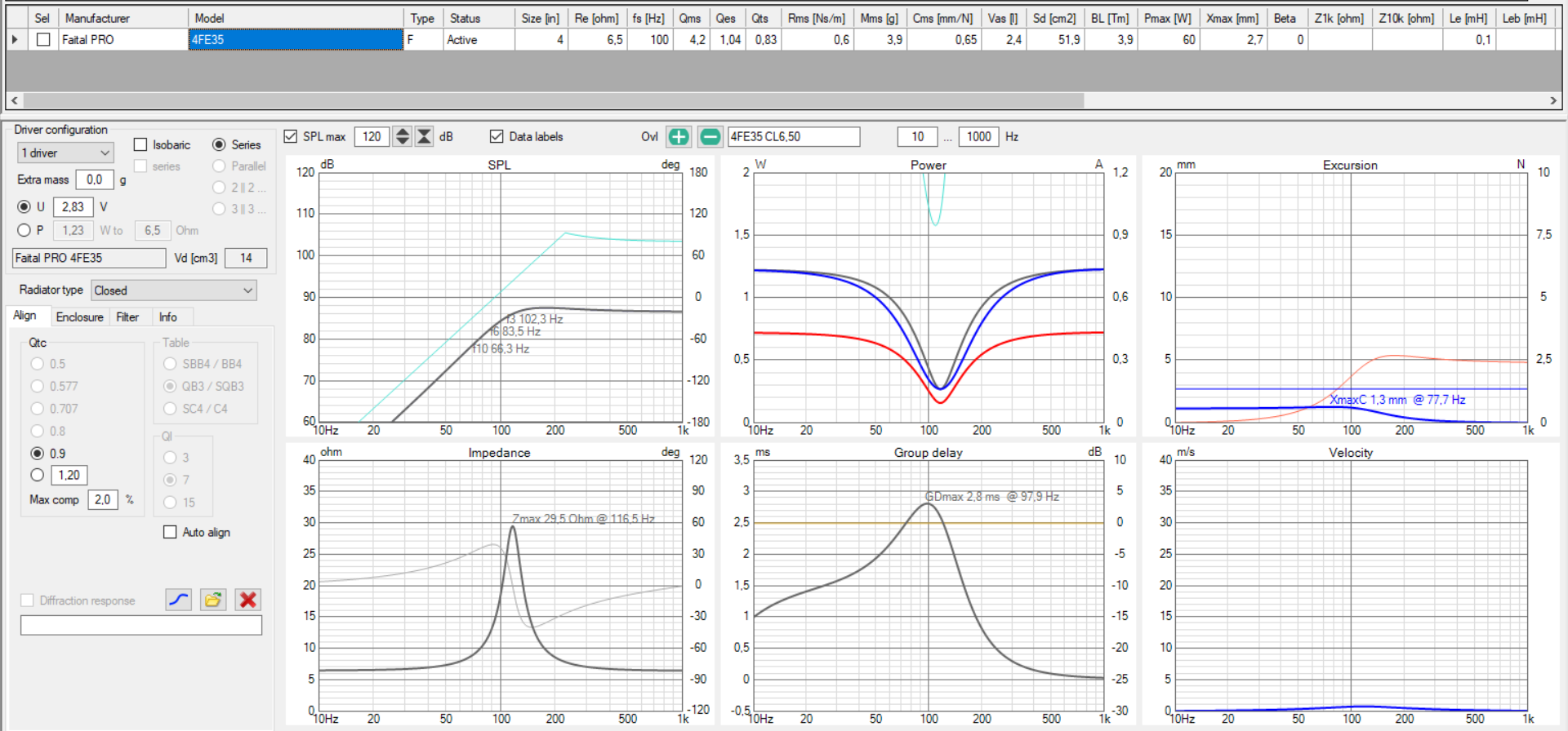

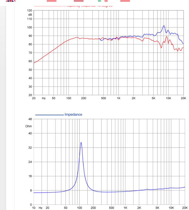

To check out if 4FE35 would work for 100db / 1m system and for what bandwidth, I'd do this:
Load the driver into VituixCAD enclosure tool.
Good ! so the SW is needed I will download it soon and study it carefully I do not even know what loading the driver means
i will look for a tutorial
I did nothing else here than increase the bandwidth shown on graphs from 500 > 1000 to see bit better, this is the view:
From here, top left SPL graph the blue line shows maximum SPL in this enclosure. The enclosure is what the system thought would work fine and offered it ready there. You could shrink the box size or change to reflex box if you already know what the enclosure is. But let's just use this data. First I just look the light blue line on SPL window, it seems this driver can actually do 100db.
this is amazing The SW can provide the max SPL obtainable from a driver mounted on a specific cabinet ? this is more than great
i think this could solve any issue i could have Thank you very much

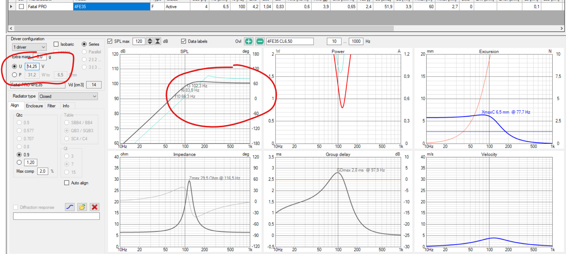

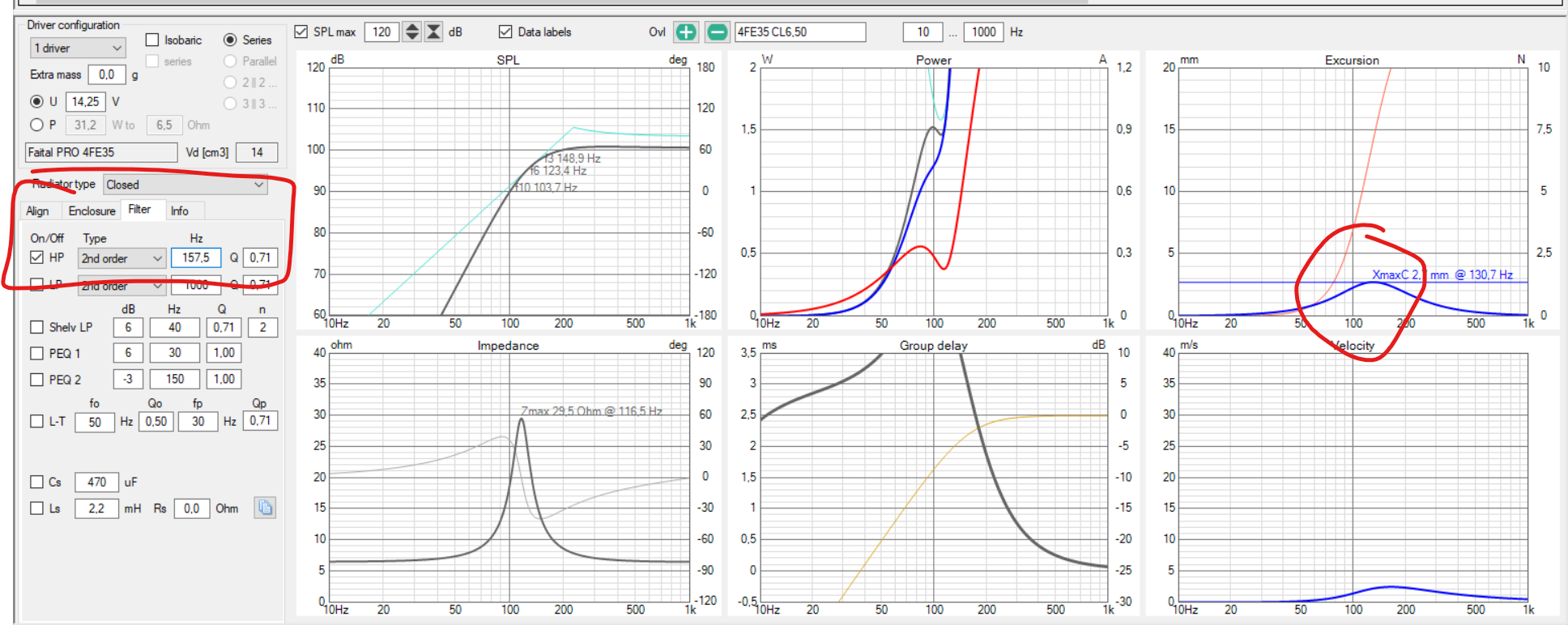

Next I just increase input power to see how much is needed for the driver to make about 100db. I just scroll my mouse on the voltage box to increase input voltage, and look the SPL graph change until it's about at the 100db mark. Now we found out about 30W of power is required. Nice my amplifier is sufficient so this driver seems plausible, it's also the RMS power limit on the datasheet so the driver will survive just fine. As you see the top right graph showing excursion goes beyond xmax, so next thing I want to find out is how low crossover the driver can do 100db. It obviously cannot without highpass filter as the image shows xmax isn't enough so let's add high pass filter.
Here I've opened the filter tab and engaged HighPass filter and just using my mouse scroll wheel I move the high pass filter frequency up, looking at the excursion graph, top right, until excursion goes below the xmax line. Now I can read from the graphs that the driver is capable of 100db of output if I have 2nd order high pass at least at ~150Hz.
Obviously, the high pass filter could be steeper and higher in frequency and the excursion would go down even further, but this here is the minimum based on datasheet TS parameters. In general, the less excursion, the less there is distortion so you'd likely want to experiment how low you can have the xover before it sounds bad. In practice, you would make a prototype box to try it out, where the crossover needs to be. Prepare to adjust the crossover filter from say 150hz all the way up to 300hz or even higher, in order to make sound change with the 100db/1m output. Now if you think the system as a whole, crossover somewhere beterrn 150-300Hz means the bass section on the system needs to sound fine up to 300Hz at least, which is another task you need now to look at and plan for, if you decide to use this particular mid driver.
perfect I think i have understood I am open to other drivers of course This is a very cheap driver
But i understand the procedure much better now This is what to design means I wonder how many Diyers are aware of this SW and use it
i am not an expert but it looks fantastic to me Impressive

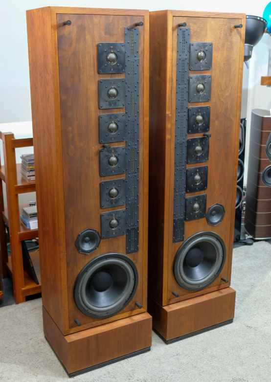

I have seen very expensive and also famous speakers that did not take into account this issue and when pushed a little some drivers started distorting or even tended to break under pressure Probably different xover points would have avoided any issue Wrong design
Quite surprising considering the brand a case here below with the cone mid being the problem
so those numbers are quite meaningless...on the other hand they can tell a lot of a speaker design!

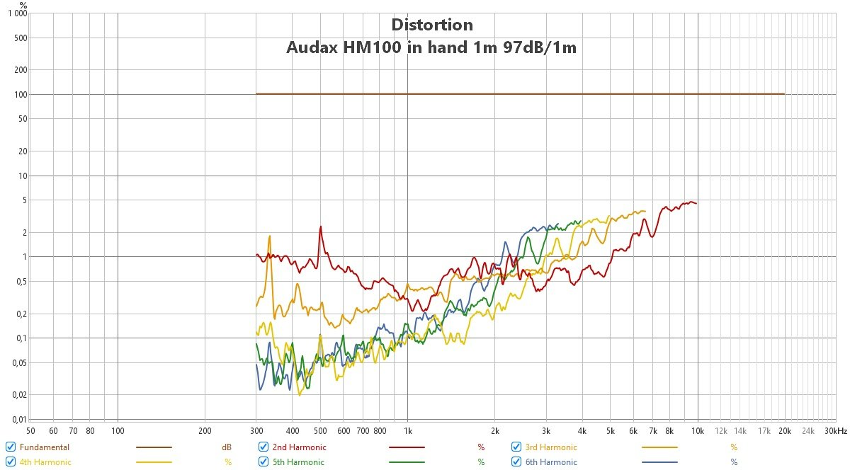

Audax distortion in % looks quite different... This was done in 2013, REW didn't show noise floor. And these don't tell much, they were done with relatively low spl. Just an example that I picked from my archives.
Best source for distortion behaviour of drivers is hificompass.com!
View attachment 1405742View attachment 1405743

I have understood the concept of Xmax of a driver
the question is still the same i.e. when a driver displacement exceeds its Xmax this should show up in some measurements
i get that SWs can predict at what Hz and SPL this will occur but i would love to see this event with instruments
for instance using a sine generator i could send a signal in and raise the level
when the X will exceed the Xmax will i get an increase of distortion peaks level ?
as an example when an amp starts to distort at clipping the sine top flattens
at some points the predictions of the design SW should be confirmed by specific measurements
i would do this only for the mid driver
the fact that TOTL speakers had flaws in the design is shocking for me
unbelieavable
it would be like Usain Bolt who trips when he runs to catch the bus instead of running in front of it
some speakers should come just perfect
i guess that in reality most speakers are normally used at very low SPLs i.e. with drivers working well below their Xmax
Therefore their limits do not show up
Driver's Xmax (voice coil overhang) exceeding will not result in clipping, but distortion (nonlinearity of vibration) skyrockets. Coil/magnet constuction is important and there are many ways to reduce distortion near and beyond Xmax (eg. copper ring)
Xmech is often much higher and then behaviour is like clipping of an amplifier. Every loudspeaker driver behaves a little differently, some will break from first hit, some other can take it for some time. Testing of this will get very expensive...
https://speakerwizard.co.uk/driver-ts-parameters-xmax/
https://www.klippel.de/fileadmin/_migrated/content_uploads/AN_04_Peak_Displacement_Xmax.pdf
Lars Risbo of Purifi explains https://purifi-audio.com/blog/tech-notes-1
