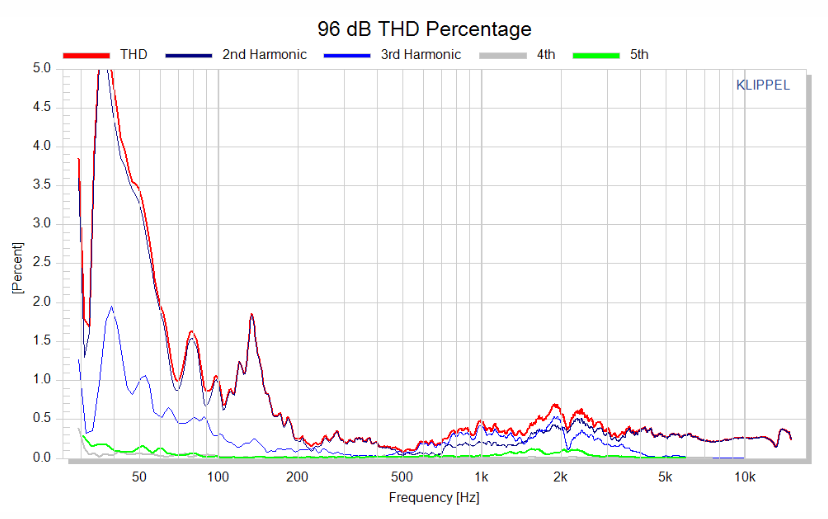

Probably for drive units, the 'waterfall' aka KEFplot is the best indicator. But you have to interpret this and very few people can do this properly. ...
I used to say the BEST measurements can distinguish bad speakers from good speakers. But an experienced listener can tell this in about 10s in "a listening test with specific tracks". What the best measurements can't distinguish is an EXCELLENT speaker from a good speaker. I don't see any evidence this Millenium to change my mind. ...
BTW, the waterfall on the JBL Everest is OK though not in the highest class. Of course this only applies above 1kHz as the usual waterfall is nonsense at lower frequencies. So it's probably a good speaker. Only a DBLT can show if it is excellent.
yes i see now Not very clean indeed And i dont like it considering that this speaker should be quite a pinnacle in quality

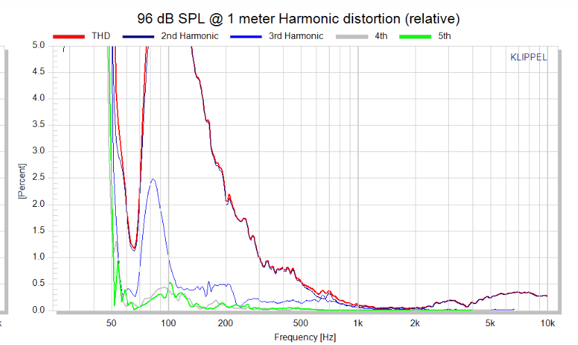

a good example imho are the distortion tests carried out at audiosciencereview.com
https://www.audiosciencereview.com/forum/index.php?threads/revel-f228be-review-speaker.23659/
they perform a test at 96dB/1 meter
this speaker aside a little peak around 140Hz should sound pretty clean considering that like i have been told the distortion below 80Hz or so are less perceptible
its a 5kUSD/each speaker by the way Not cheap

there is million ways to think why THD of single driver would not matter, for example take two drivers, one has greater THD but the other has bad cone breakup peak. Now, listen these both untreated and the one with with the cone breakup peak likely sounds worse, as it's sound of the driver itself, a peaking frequency, and not sound of the music. The other driver with high THD might have it high due to suspension issue, which manifests itself at low frequency as 2nd order harmonic, which is sound that relates to the music (and not the driver!), and makes bass peceptually more impressive due to how auditory system analyzes lows from their harmonics.
Now, if both of these were candidates for a subwoofer application and low passed accordingly, perhaps the cone breakup peak doesn't matter at all as it's way above pass band, but the higher THD driver might still sound better due to the higher 2nd order distortion making bass more impressive perceptually, because auditory system can construct fundamental from harmonics and find the sound more impressive depending on what you are looking for.
On the other hand, if the drivers were for a two way speaker bass section, and the cone breakup was treated appropriately with a passive parallel notch in series with the driver, then the cone breakup peak might not matter at all, but the high low frequency harmonics would make inter modulation distortion for the whole bandwidth and the other driver now wins. Unless you turn this as a three way mid driver, then both likely work just fine due to high pass filter cutting out the excursion. They both could work just fine in any configuration depending on your application, if you always listened at low SPL perhaps the distortion is never audible on either on any speaker configuration and you could have bought a third one.
So, if your system must perform at limits of it's capability then the distortion stuff matters, because you now have your system planned and know what kind of performance the driver need to have in order to meet the performance expectation and not sound bad. If you do not know what driver performance is required, then buy few candidates and compare. If no money to buy, then buy the better one just in case. If no money to buy the better one then only option is to buy the cheaper one. Distortion is no issue basically, quite uninteresting in the end as you just buy suitable driver and problem solved. If distortion was a problem, it's a system design problem, because of bad system design for the use case. So, all the importance is in the system design and not just from distortion perspective but in every way.
If you know the listening situation and how much SPL and bandwidth your system must have, it's easy to calculate required SPL capability, which now functions as basis for how big of system you need to design to have it with "low distortion good sound". If your system size is limited due to aesthetics for example, then you might have to use top shelf low distortion expensive drivers to meet the goal. On the other hand, if you just specify big enough system that meets the system target and then some, the distortion is likely never an issue no matter the driver.
One should avoid the absolutely cheapest bad measuring stuff of course, and perhaps the most expensive top performance stuff is not really needed, so there is plenty of selection in between to choose from which all likely work pretty much similarly, within the performance limits your system design imposes.

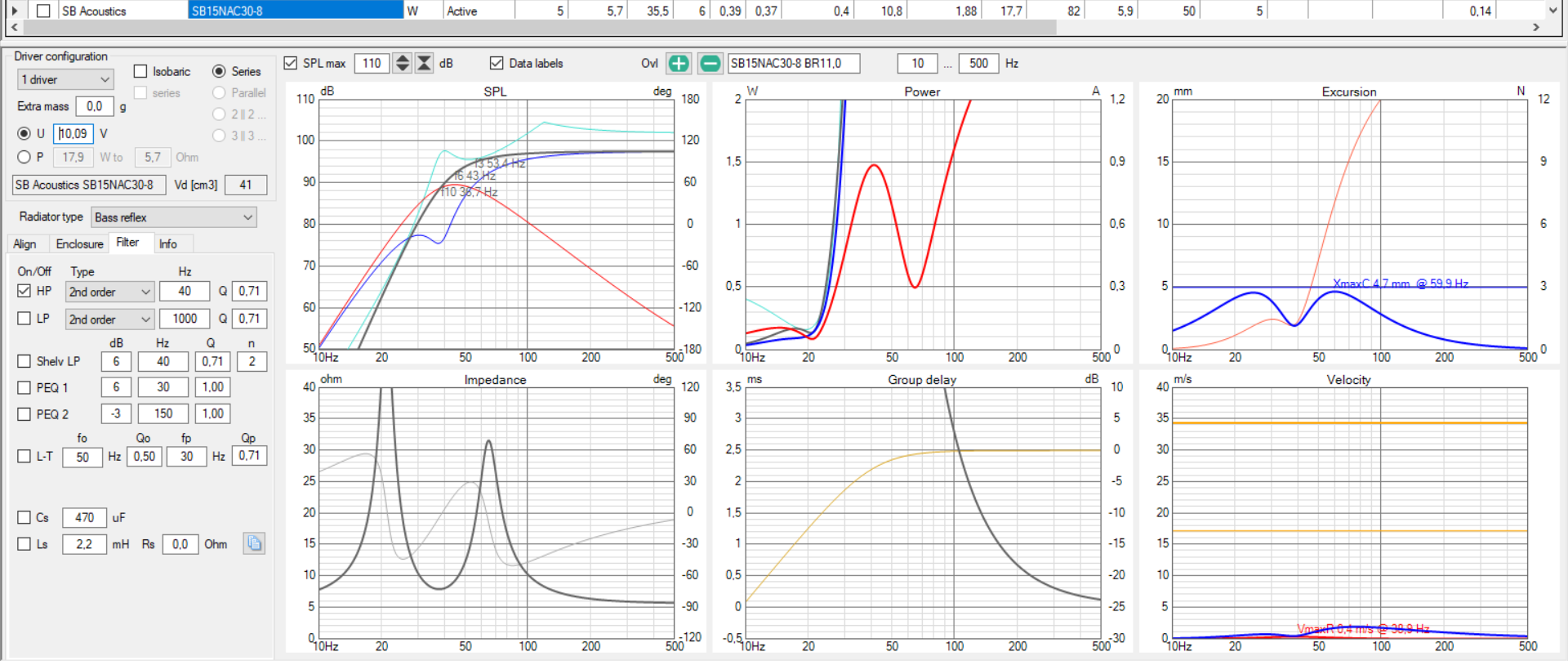

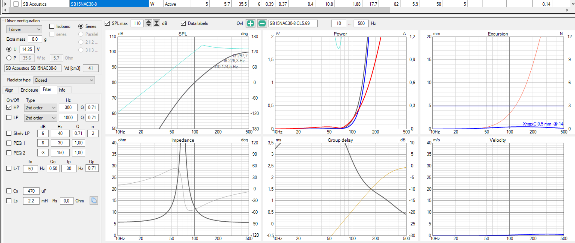

If you want to have flat anechoic frequency response, there has to be 100db/1m capability the whole bandwidth, for bass, for mid and for tweeter. If your concern is only 3way speaker mid as an example here, then it has to be capable of 100db at the low xo at 300Hz so power handling and excursion needs to be within some sensible margin from maximum if you want to listen long time and sound not change too much.

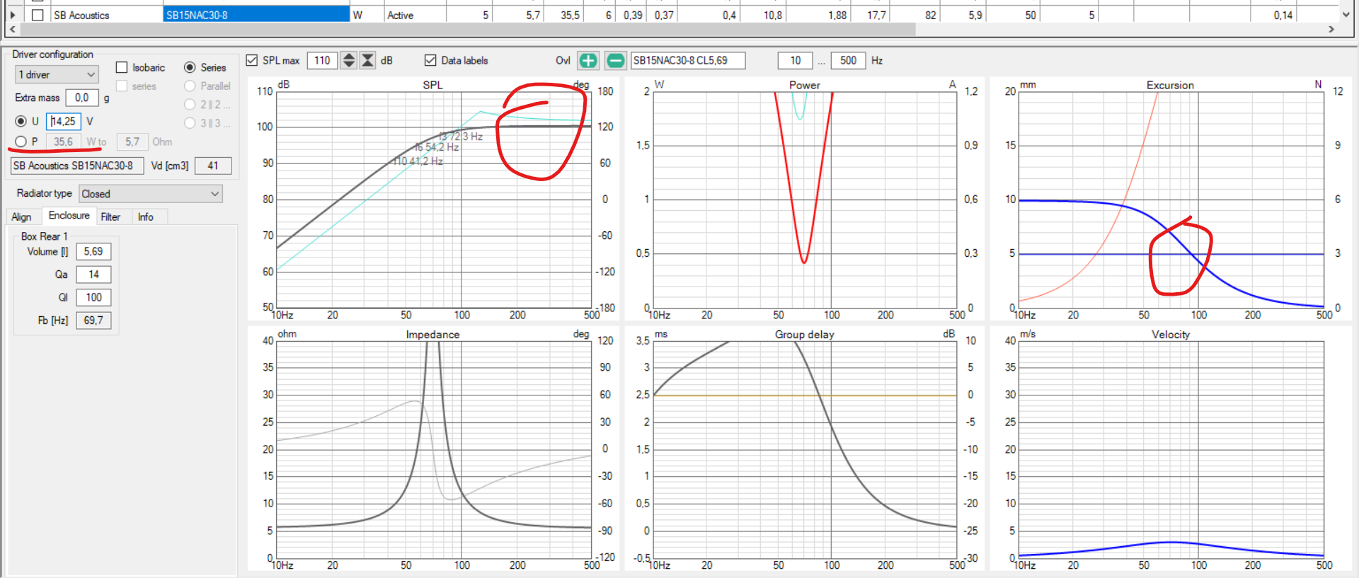

Since mid is likely in a closed enclosure, you can directly use volume displacement to SPL table to see how much of a volume displacement is needed to reach that SPL, which directly translates to excursion your driver needs to do since the driver size (cone area) is likely already specified. From this you can estimate is the required excursion within xmax of the driver for example. Same applies for the bass of course, but here you need to also account for a port output if it's a reflex system so this stuff is easiest to do in a simulator.
Example: here some 5" driver in enclosure the simulator picked for it. On SPL chart it already shows that 100db is within power and excrusion limits at 300Hz so it would work on first glance. I now see it needs about ~40W of power to do 300Hz 100db and that excrusion goes beyond xmax about at 100Hz without highpass filter. I now know this driver would not give 100db system being doing bass duty as well. Anyway, put highpsas filter at 300Hz and it's obvious xmax isn't even close to limits but power is about max the driver can take. From this we could assume such power starts to heat the system up so expect sound to change due to heat if you listen at 100db / 1m.
What else, since the driver isn't ran on it's resonance and excursion is low the suspension doesn't likely make much distortion. Hysteresis might make some, also Le(x), perhaps Bl(x) does some, so here more expensive advanced motor that tries to reduce hysteresis and linearize Le, would make less distortion than cheap driver with simple motor might give more. But, since the driver would be run on close to it's thermal limit on peaks the most audible issue might be compression due to heat and perhaps hysteresis distortion. So, perhaps look for driver with more handling capacity, or make sure the heat is dissipated somehow somewhere. If you consider 15db peaks for music, and listening distance be 2m away, 100db/1m leaves about 80db average listening level at listening spot peaks touching the 100db mark, 40W power.
These are simple metrics you can use to estimate the performance, to make sure the system is rather erred to be more capable, than not capable enough.
The same driver in bass duty could do max about 95db / 1m in a reflex box hitting xmax with 18W of power.
