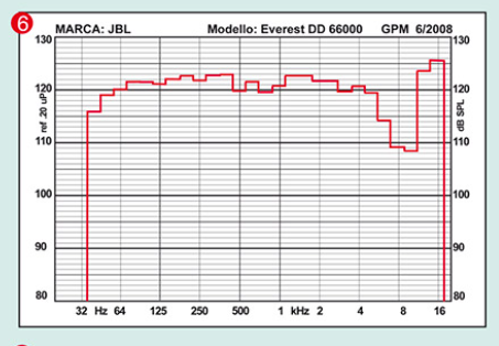

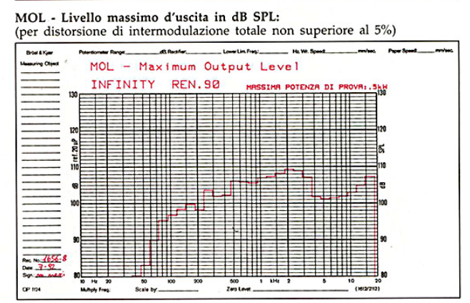

the very important conclusion is that the Xmax constant curve in terms of SPL vs Hz will provide a kind of good operation area for a driver
above that curve the behaviour of the driver will become not linear with all the nasty consequences
in an ideal world for lazy persons the manufacturers would provide that curve already in the datasheets
in any case i would love to measure it before using a driver
