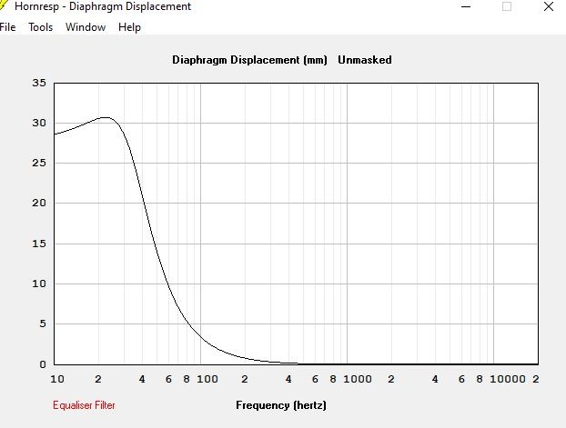

Hi Jim, I just ran a quick sim in hornresp of that woofer, 50L box, and a low shelf that appears to match what you used.
(always hard to translate shelving filters exactly between programs/processors, but I'm confident it's close)
The woofer has a power rating of 200 watts. Using that power rating, here is the displacement (excursion) HR predicts.
Woofer has 11mm xmax. I think it could be dang easy to exceed xmax without some form of hpf in place.
Or add a voltage limiter. Or just keep the volume down ALL the time.

The displacement (excursion) Hornresp predicts past Xmax won't be correct.
Repeating what I wrote 10 years ago when David added filters to Hornresp:
post # 4298
https://www.diyaudio.com/community/threads/hornresp.119854/page-215

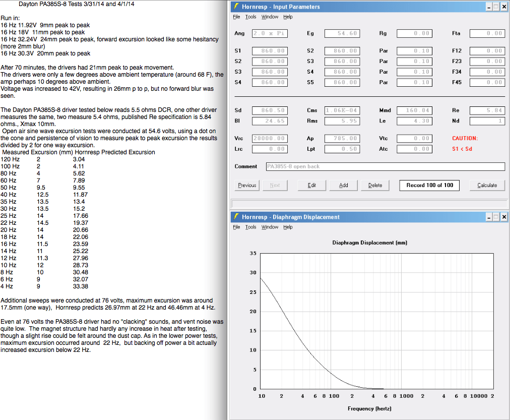

Although Hornresp is quite good at predicting excursion within the linear range of operation of a loudspeaker, that is displacement at or below Xmax, it is not accurate above Xmax, where most users are concerned regarding placement of filters to protect drivers from over excursion. Since it predicts more excursion than usually will be experienced, it is a benign problem, but an inaccuracy nonetheless.
Above Xmax the driver's BL (magnetic force) drops off, as the voice coil progressively leaves the magnetic gap there is no longer the force left to push a stiff suspension past a certain excursion. Hornresp does not take the dropping BL into account, and it appears to consider the suspension to have near infinite elasticity and linearity, not the case for most high displacement drivers which "put the brakes" on excursion before the voice coil can hammer the back plate.
Attached are sine wave excursion tests on some Dayton PA385S-8 drivers conducted in free air.
Measured results are quite close to the Hornresp simulation up to a bit past Xmax, but then diverge more and more, the simulation predicting as much as three times the measured displacement at lower frequencies.
To recap, two points:
1) Most modern drivers voice coils will not hit the back plate unless the suspension is torn.
That said, when the suspension hits it's limits, it can make some nasty sounds.
2) Most drivers excursion won't be nearly as high past Xmax as simulations would indicate.

Art, great info. Thank you.
It answers a nagging impression I've had that hornresp's displacement past xmax, had to be based on some math that drivers obviously can't really do.
Your PA385 test and explanation has helped confirm that.

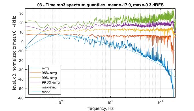

I do not understand what "practical point of view" means, especially on this forum. Let's do a spectral / histogram analysis of the popular song "Time" by Pink Floyd.
As you can easily see, 22dB of dynamic range for f < 35Hz.

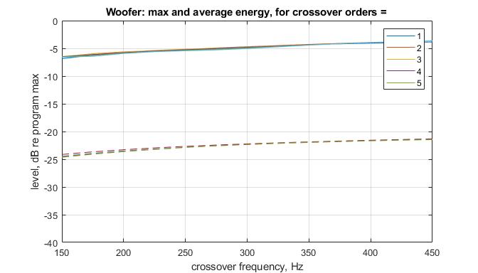

Let's also see what peak-to-average you need for the woofer for a chosen crossover frequency (and order). About 18dB, if I am not mistaken.
This is the reality, not fantasies.

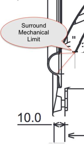

Since the simulation has no input for the suspension limits, it considers it limitless 😳
Your example of the SB34NRX75-6 with an Xmax of 11mm reaching over 30mm excursion is obviously impossible when you look at it's half roll surround, and do the math of it's "unrolled" length at a diagonal:
Somewhere around 15mm excursion, the half roll has straightened out completely, reaching it's mechanical limit, (Xmech or Xlim) it can't go further without stretching or ripping.

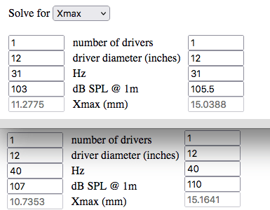

The difference between 11mm and 15mm is under 3dB:

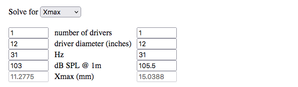

My personal rule of thumb for SPL / excursion limits is I design for hitting Xmax at 40 Hz, and that defines the SPL limit for a sealed box woofer, whether it uses a bass EQ or not. For this driver, that would be about 85 W and 107 dB.
Jim,
When William Shatner played Captain Kirk, 40Hz seemed "low enough".
So around the low "E" on a four string bass hits Xmax at 107dB, there is less than 3dB left before Xlim, when the SB34NRX75-6 goes from clean to making rubber band snapping noises 😉
You did suggest using a 32Hz +6dB boost with this speaker, so when a 5 string bass hits a low "B" (31 Hz) at ~105.5 dB, the speaker has hit Xmech.
At any rate, when you play songs like Pink Floyd's "Time" with dynamic range of ~22dB of dynamic range below 35Hz, it's hard to keep track of 3dB.
