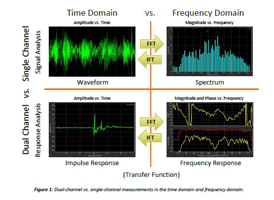

IME, It doesn't matter which path we take....they all give the same results. It's more a matter of exactly what we're trying to measure, that determines whether to look at impulse of freq response (complex.) ....Whether we have questions in the freq domain or the time domain.
A snip from the Smaart manual...
I use sine sweeps, temporal averaged pink noise, tone bursts, a Dirac pulse, etc etc ...with REW, Smaart, ARTA, and several other dual channel measurement programs. Results are always very close no matter which program or which stimulus...whether I went straight with FFT to freq domain, or thru impulse to freq.
It's awesome really, the simple equivalences between freq reponse (including phase) = impulse response = step response =CSD reponse =burst response....
...equaling all the various looks we find ways to debate ...hahaha

Fully internalizing the equivalence between freq response and impulse response and all the derived graphs,.... step, waterfalls, CSD, bursts, etc.... has been one of the biggest audio aha moments I've had....kinda mind-blowing really. (not that I have that much of a mind to blow! )
