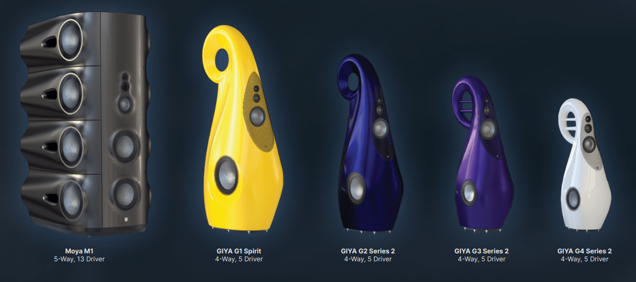

My deepest respect for Lawrence. I thought it is something only a DIYer would dare to attempt:
EIGHT ~11" woofers, dual opposed, in a vented configuration for bass below 125Hz (F6 19Hz).
This cabinet is 2 ft 2" wide, by 4 ft deep, the weight for a upright piano (760lbs). All in a passive crossover for a 5 way.
I'd design/build/buy it. But one man's singular vision may be another (wo)man's garish hallucination (?nightmare)
Reference:
https://vividaudio.com/downloads/Vivid_Audio-Moya_M1-e_brochure.pdf
