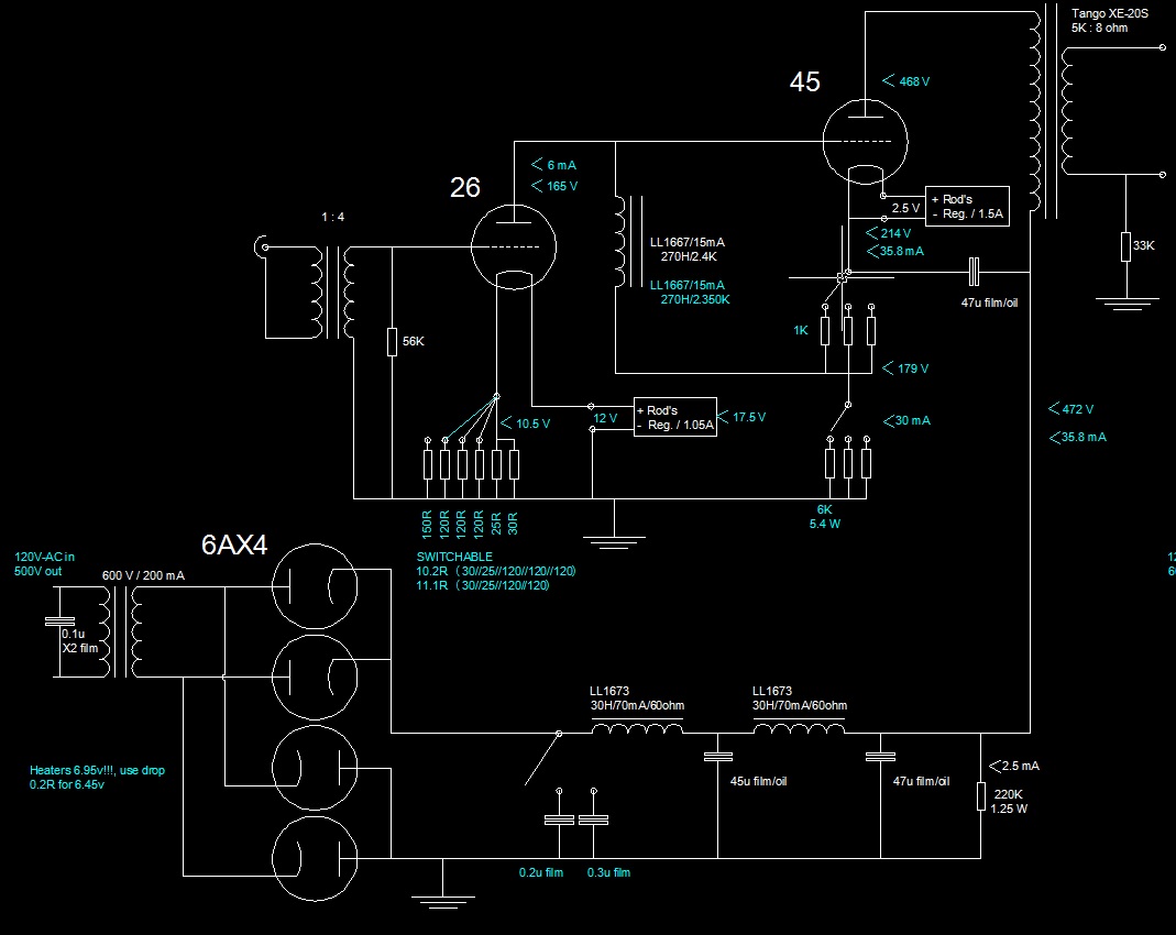

So, I finally got the circuit modified where #45 is running at around 250-260V plate, -50V bias and 34-38mA and #26 at around 150-160V plate, -10.5V bias and 5-6mA (values depending on actual tube-to-tube variations); se attached actual measured values.
While the amp is sounding really VERY GOOD, I did not really get ANY measurable change in distortion by adjusting this operating points. I am still basically just over 1% THD at 0.1W and just over 4% THD at 1W output. Spectrum is dominated by 2nd order distortion (around -36db at 0.1W; -28db at 1W) while 3rd order is much further down (-74db at 0.1W and -68db at 1W); see attached spectrum for 0.1W and 1W.
I am wondering if this relatively high measured distortion is a problem I should try to solve and, if yes, what would be the best next step to try?
Thanks for any suggestions/opinions!

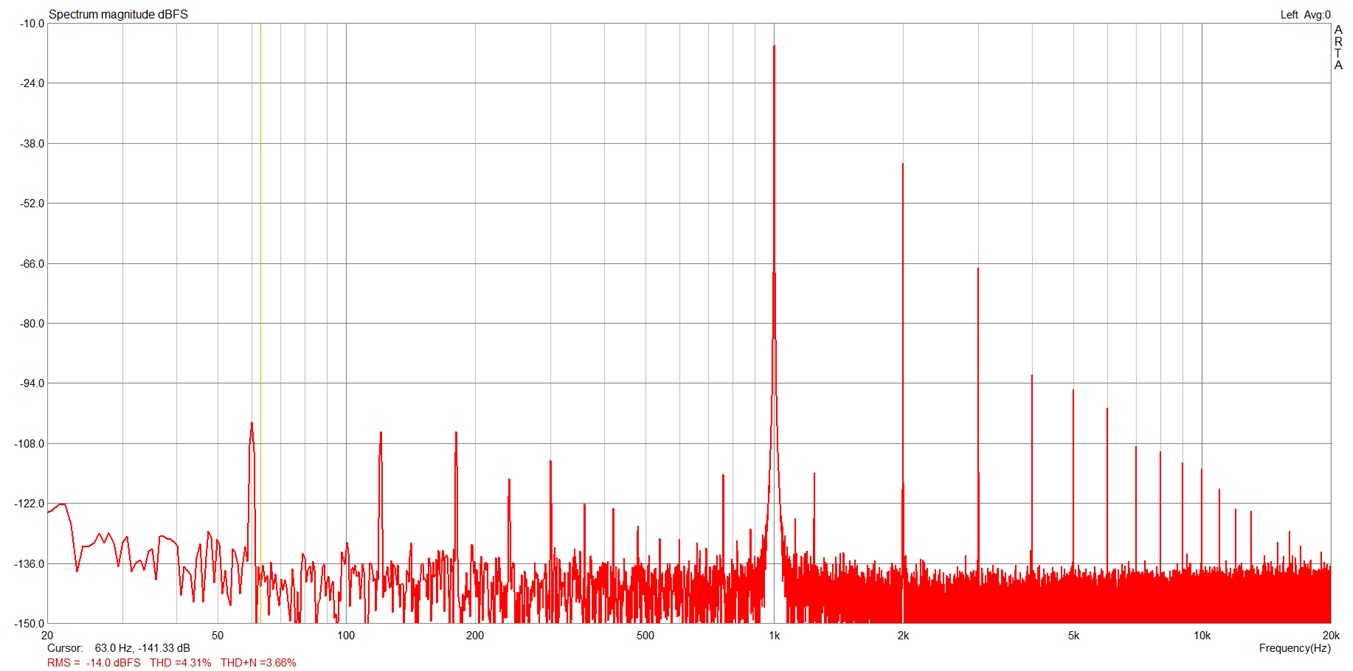

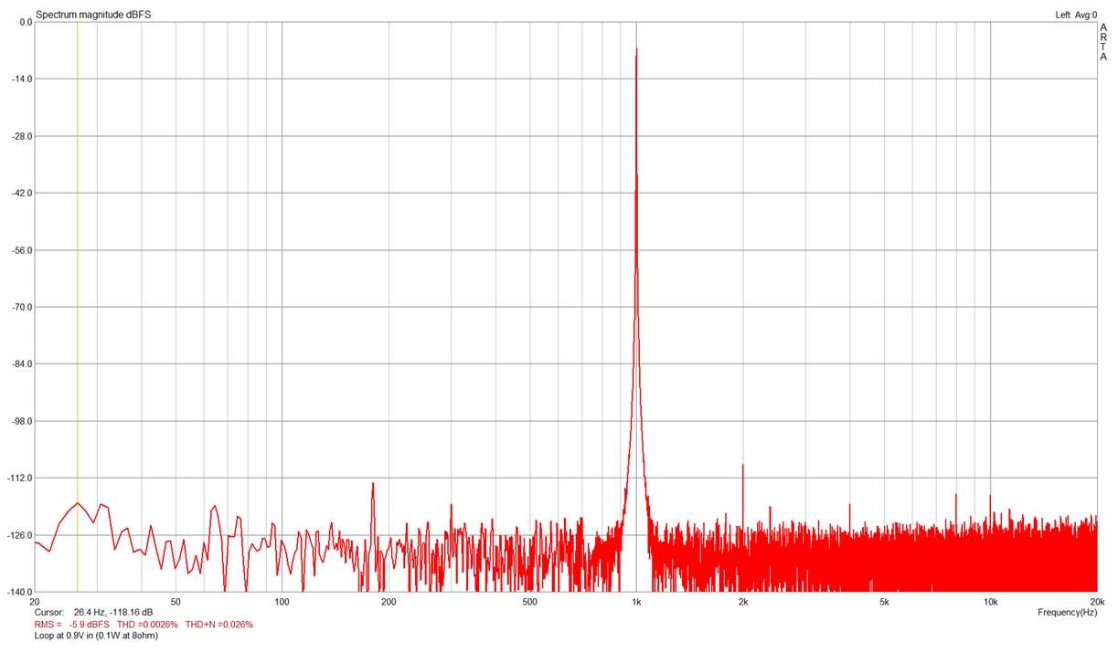

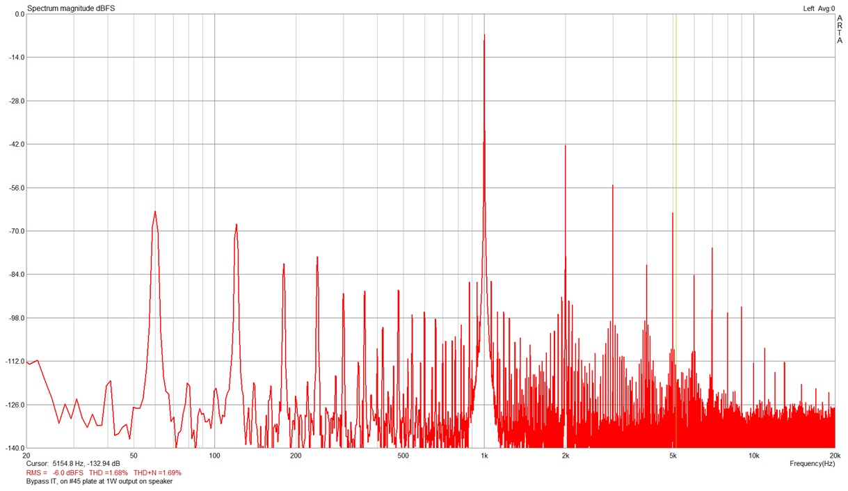

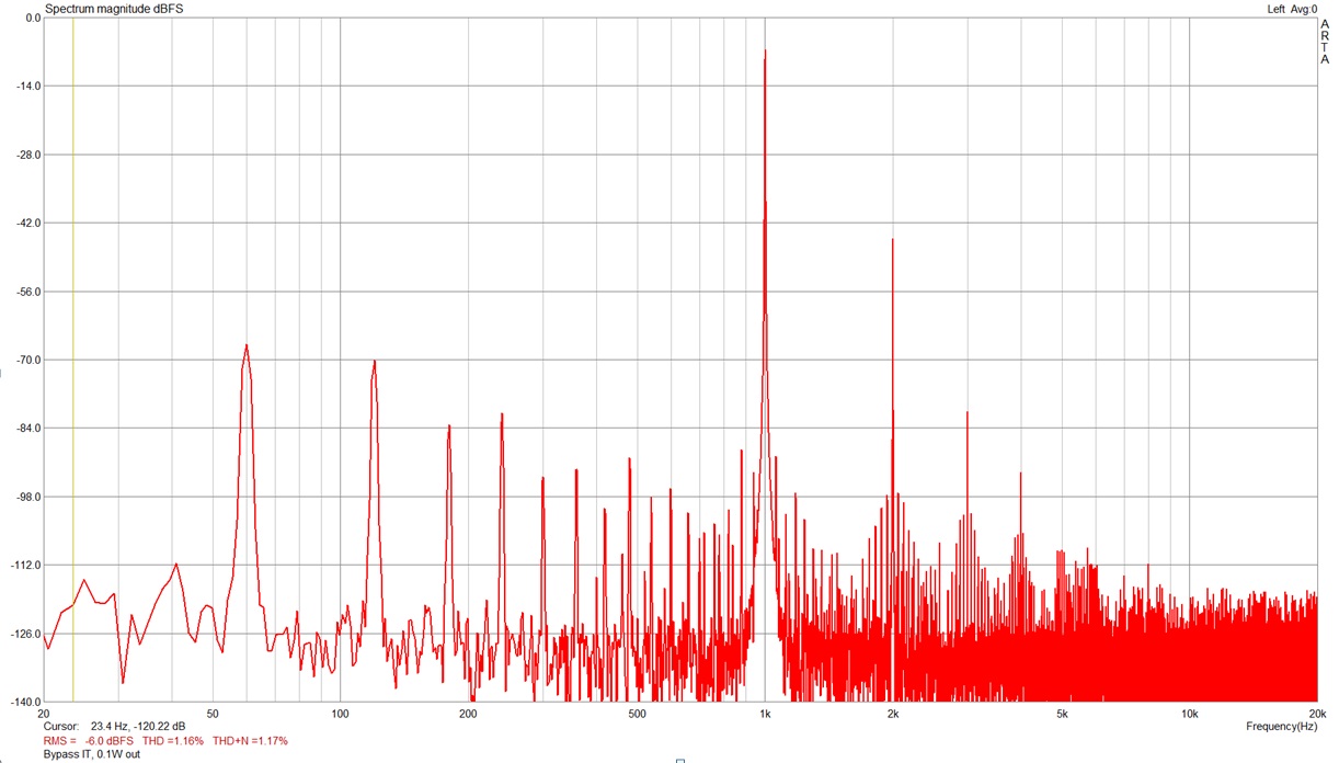

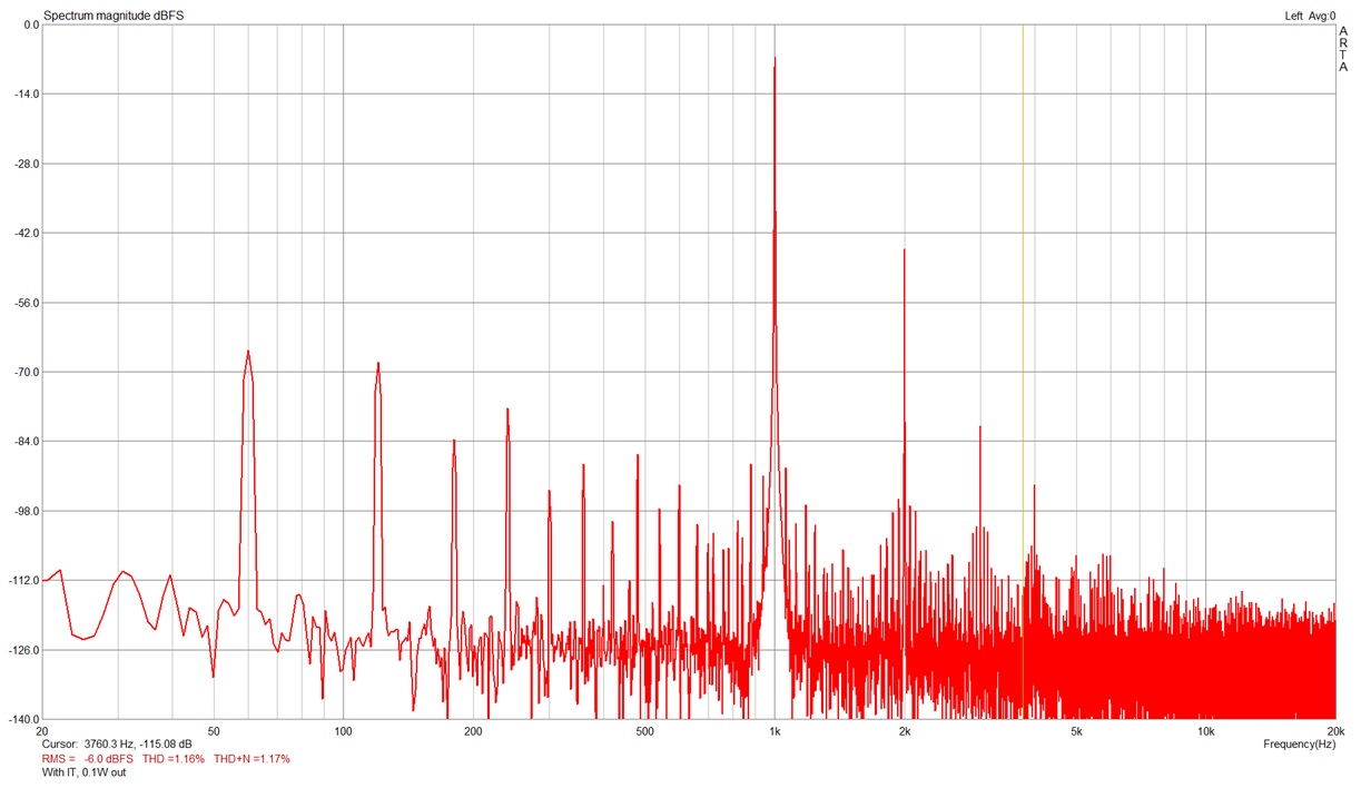

I did following measurements, all with input signal to get 0.89VRms (0.1W) on the speaker terminal with 8 ohm load:

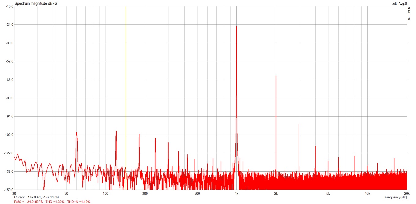

1) Loop measurement of the soundcard, 0.0025% THD at that level
2) Complete amp with IT, 1.16% THD
3) Complete amp without IT, 1.16% THD (here I adjusted the output of the card to get same voltage on the speaker terminal)
4) Same signal without IT, measured at #26 plate, 0.59% THD
5) Same signal without IT, measured at #45 plate, 1.68% THD
I think the problem I am running into here is that my soundcard input probe with 20db pad has approximately 8K impedance. This means that once I get this probe connected to #26 plate tube sees much less load than normally, so distortion goes up a lot from where it would normally be. This was very clear to see when comparing measurements of #45 plate that, once the probe is connected, works into 3K load (8K//5K) instead of normal 5K transformer load.
This made #45 measure much higher THD on the plate than actual THD on the speaker terminal.
I am wondering if there is something wrong with my measurement setup that would give me high THD number.

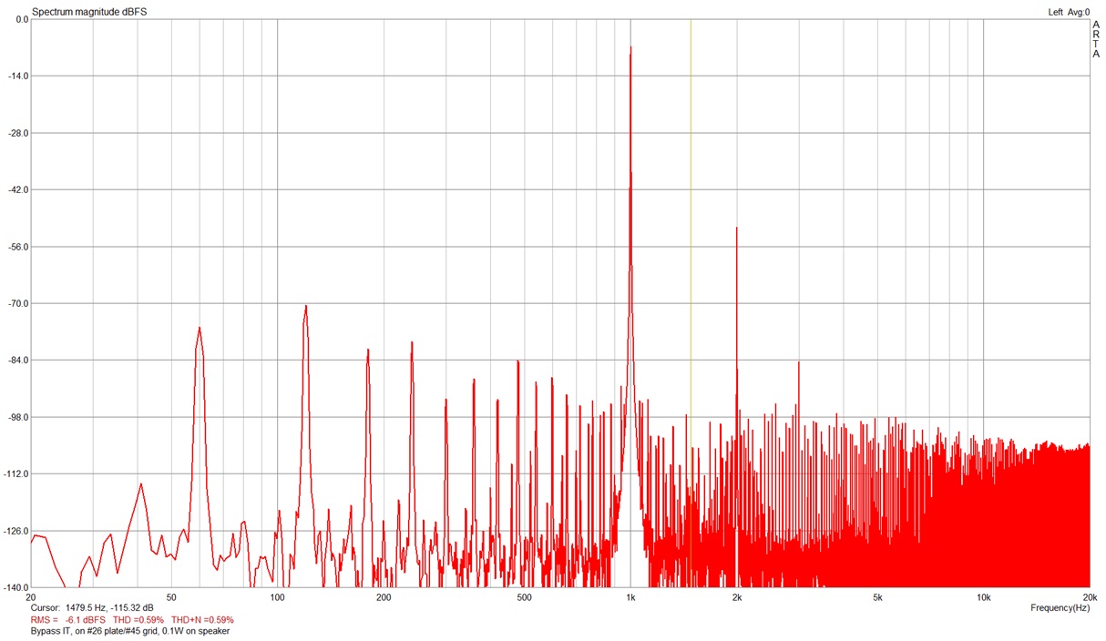

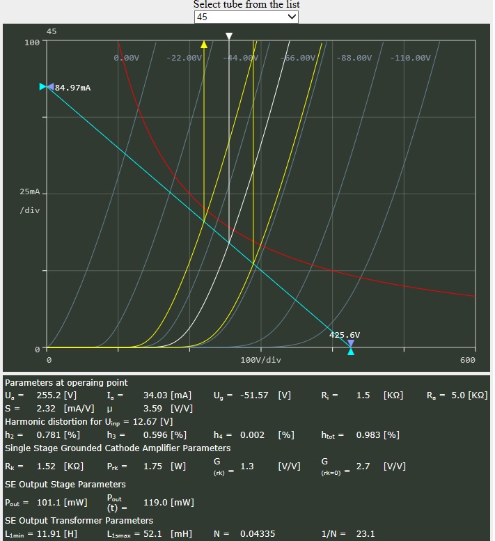

I tried Loadline simulator that TrippleM suggested (thanks for that link!) and got really interesting result; the predicted THD at my operating point is 0.98%, so really close to 1.16% that I am getting!
So, maybe this is a realistic level to expect if one is using no distortion canceling methods!?
Only thing that I could not quite figure out is why it shows 5K8ohm transformer as 23.1:1 winding; thought it should be 25:1?
Also, per my understanding U-input to 45 grid should be around 8-9V to get 0.1W P-out, even with transformer losses; simulator is calculating 12.67V?
Will get to measure and compare actual voltage.

When you calculated the drive voltage did you account for the effect of the reflected load on output stage gain, it's significant.
I'm assuming the output transformer is 5K:8 in which case I also get 25:1 ratio so that is a bit odd.

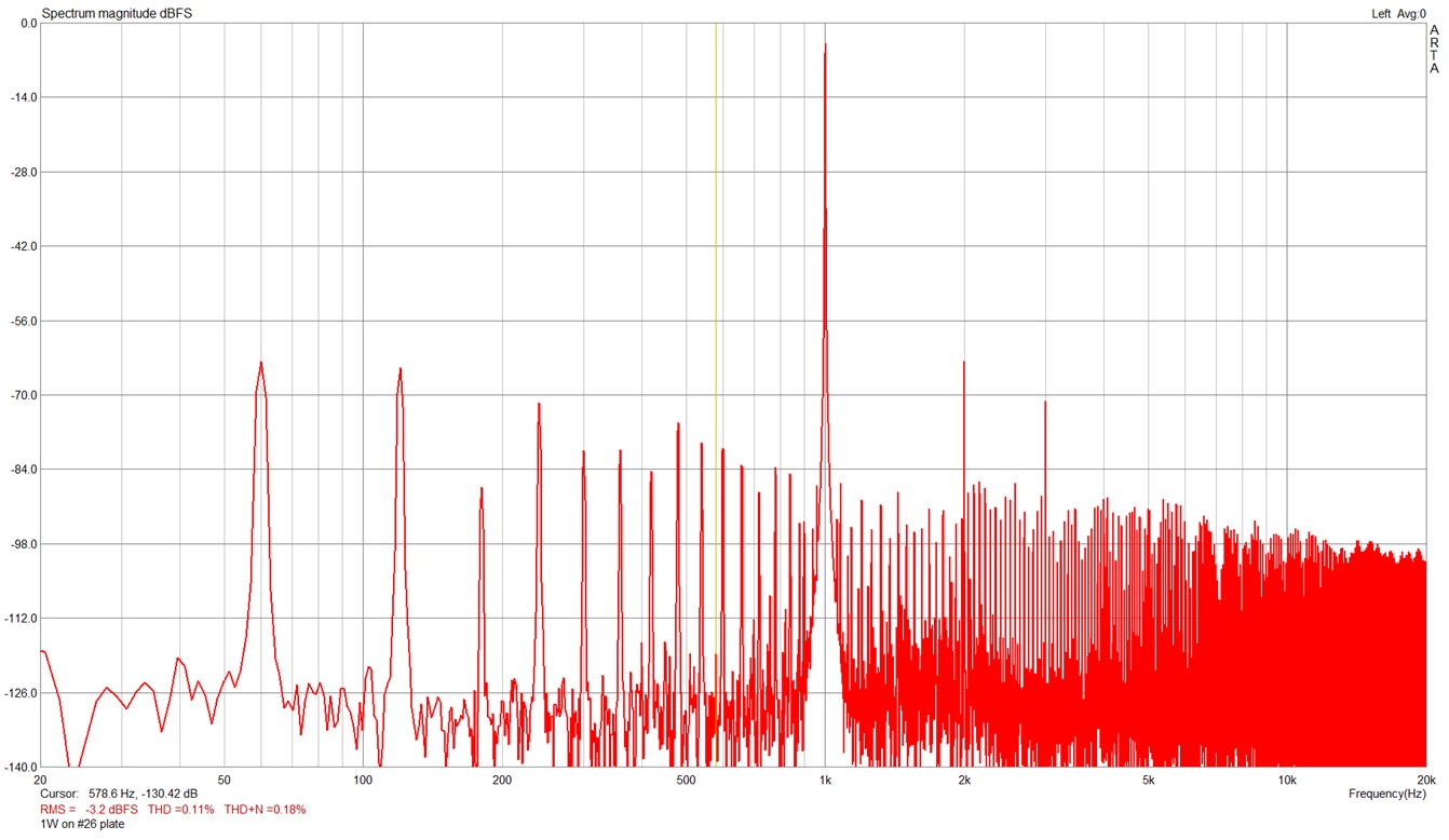

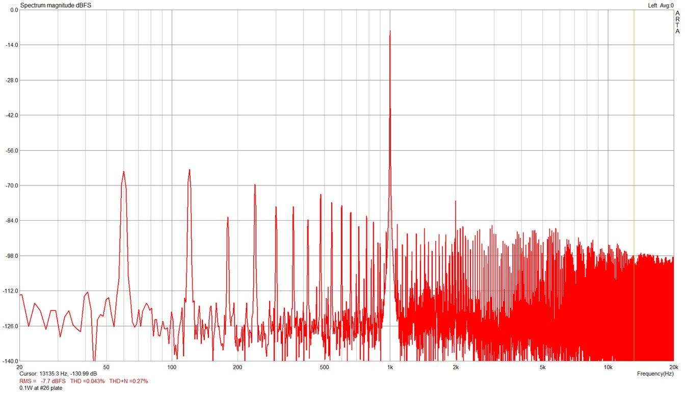

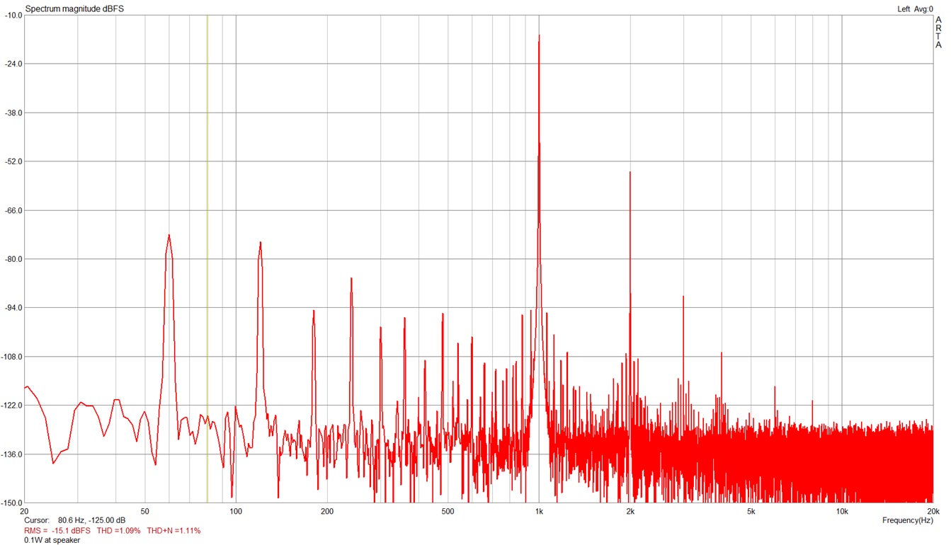

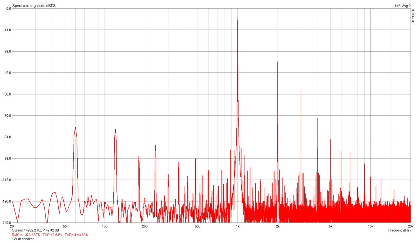

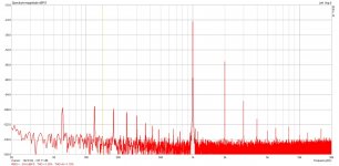

So I changed my probe to have much larger input impedance, now around 500K.
This made it possible to measure trough the stages much more accurate and it is clear that most distortion is coming from the output stage.
At 0.1W I am getting 1.09%THD at speaker terminal and just 0.043% at #26plate / #45 grid.
At 1W I am getting 3.6%THD at speaker terminal and just 0.11% at #26plate / #45 grid.

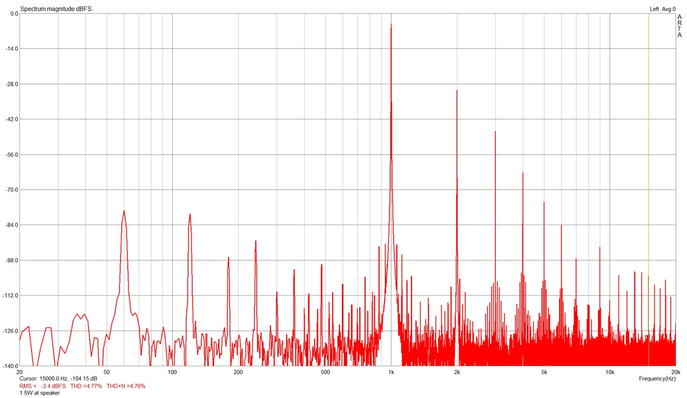

I also checked "max power" THD and got 4.77%THD at 1.5W on output?
Now, the question is if I could (and should) modify something in this design to reduce distortion at low power. Obvious choice would be to use 7K or 10K transformer instead of 5K, especially since I am only driving my horns with this amp, so really would never need more then 1W output?
Perhaps a small core, low power transformer with higher primary would help reduce distortion as well as work really well in this "mid and high" frequency range application?
I also measured all signal voltages trough all the stages and all of them look realty good; to have 1W output I measured following Vrms:
0.795V input
3.322V on #26 grid (4.18 amplification on input transformer)
29.17V on #45 grid (8.78 amplification on #26 tube)
78.7V on #45 plate (2.7 amplification on #45)
2.966V on speaker terminal (1/26.5 signal ratio between OT primary/secondary)

Also, checked again my signal voltage against the simulator prediction and there is really lots of difference there; to get 1W output with 5K OT into 8ohm I have 29V on #45 grid while simulator calculates 40V; really not sure where this difference comes from; really looks as if there is a mistake in the simulation program?
my amplification on #45 is 2.7; exactly same as predicted by simulation program...
Simulations are generally "ball park" so it strikes me that there might be an error in the calculations or in the tube model.
What frequency are these thd measurements performed at? (duh 1kHz lol) The numbers would be expected to be worse at 100Hz than 1kHz for example depending on the transformer.
The distortion performance of the driver is impressively better than I expected.
Potentially the transformer could be contributing to the distortion - any details you can share? It's the last place to look I'd say. You could potentially replace it with a transformer having a somewhat higher primary impedance perhaps even tailored for operation in your target frequency range.
As I indicated at 1.6W I measured 4% thd in my 45 amp long ago so you are in the ball park..
I am a little concerned about the LF spectra and am wondering whether those are artifacts of the measurement set up or actually present in the output of the amplifier at all times. Take a look at magnetic coupling and ripple on the output of the B+ supply. Verify that the raw filament supplies are clean.

I get this LF spectra when using #26 as my driver; I think it might be because one of the filament transformers "buzzes" a bit which would create some vibration that #26 seem to pick up. When I change driver tube to #10 this LF disappears as it seems #10 is much less sensitive to vibration.
But, even with #26 I can almost not hear it even with my ear next to the horn; they are about 75db down compared to 1W signal.
