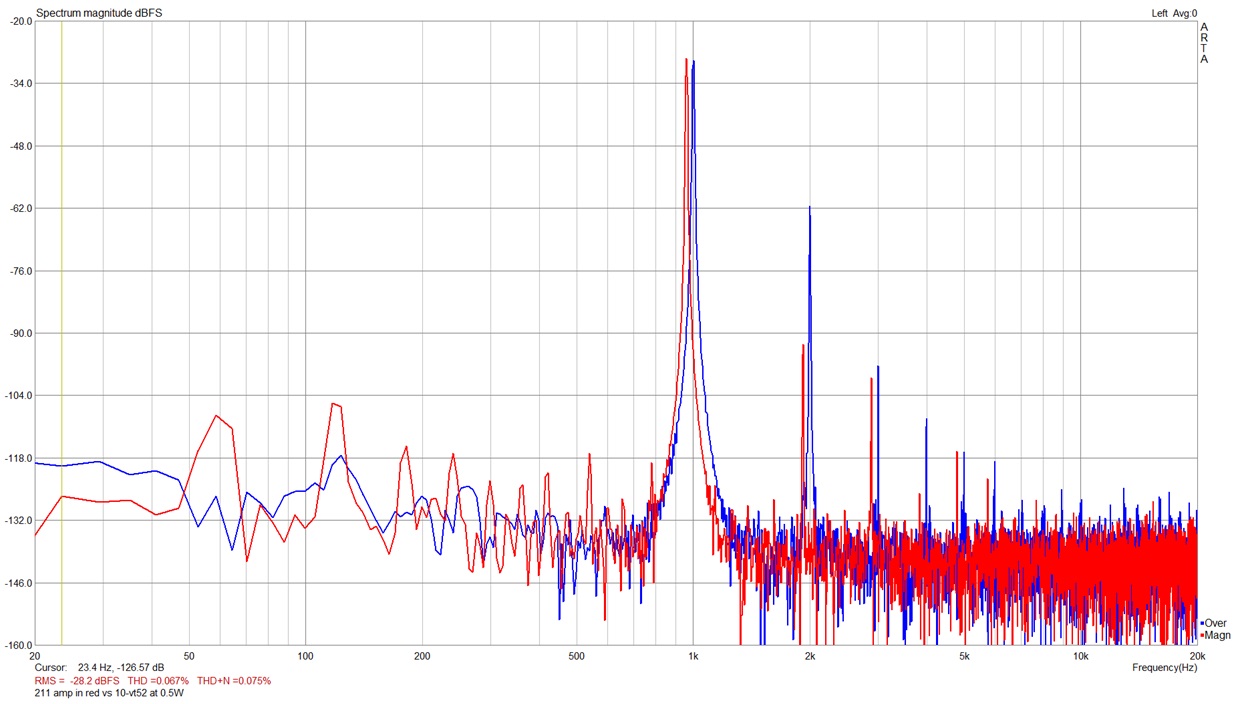

OK, understand, so the U-in from the simulation is actually 1/2 of V-pp, not V-rms; makes sense.

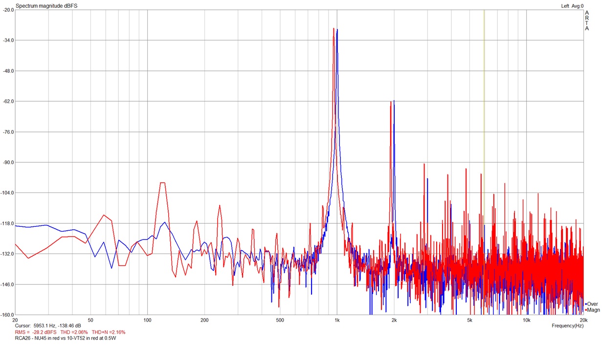

I really do not think that distortion I am seeing has to do with actual tubes; I got four 45's and two look really as they are NOS. Still, they all get very similar THD measuraments; basically just over 1% at 0.1W, 2% at 0.5W, 3.5% at 1W and 4.5% at 1.5W.
As I made this amp to be switchable and take also #10/#45 as well as #10/VT52 combinations I did measure ad compare those as well.
I was surprised to see basically same distortion figures for #10/VT52 combo as I was sure those would be less; here I enclose the spectrum comparison of #26/#45 (in red) vs. #10/VT52 (in blue); this is measured at 0.5W-Pout. Second order distortion is identical while #10/VT52 has a bit less 3rd and higher order. Here VT52 was real actual NOS, still in un-opened military box.
#10/VT52 version is running at 275V plate/18mA/-16V bias on #10 and 290V plate/43mA/-55V bias on VT52.
I am still thinking if there might be a "bug" in the actual design that would cause this pretty high THD, over 1% at 0.1W out.
Could it be something about a behavior of directly coupled topology that I am overlooking / not understanding?
Maybe best next step would be to modify design and test in simple capacitor coupled configuration, using same tubes at same operating points.
It is comparison to my IT coupled 211 amp that manages 0.067% THD at 0.5W (vs.2% on new amp) that makes me think I should be able to improve this design.
I do realize that there is some even order distortion cancelation happening in 211 amp (visible from relatively lower 2nd and 4th order distortion than 3rd and 5th order), but I am not really sure from where this comes as it uses simple 5687 as a driver, IT coupled to 211 that has grounded cathode and fixed (adjustable) negative bias on the secondary of IT.

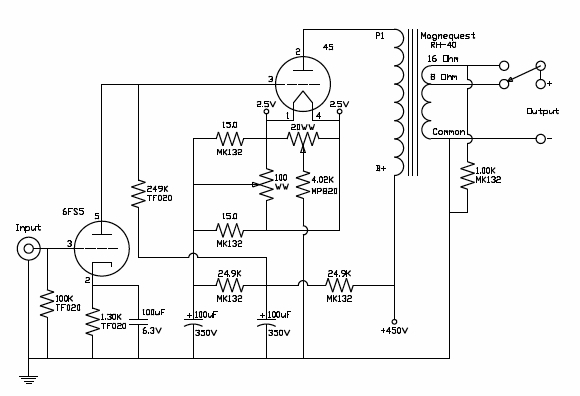

The schematic looks fine you have some degenerative feedback on the final but no neg feedback! but you bypassed the gain/driver.... if you take off the bypass and add some neg feedback...your measured and heard distortion will vanish to somewhere around .7thd 😱
Correct, no negative feedback by design. It was a quick and simple amplifier put together simply as a test around the 45 and SE, albeit a bit of inspiration from the Fi amps. I use them to drive a pair of Fostex F120a drivers for some background music in the family room, that's all. I've no desire to make any changes to it but thanks for looking.
My other 45 amps are also SE, zero feedback, much better and a clean sheet design using all Hashimoto iron and no electrolytic caps. They are not DC coupled to the 45, but the input/driver is DC coupled, hence a single coupling cap. The distortion (THD) on these is quite low, being less than 0.4% at 1-watt output and within 1dB to 50KHz. They also have better linearity, lower output noise (>80dB below 1-watt) and a bit more power, 2.25 watts vs 1.75 watts ;-)

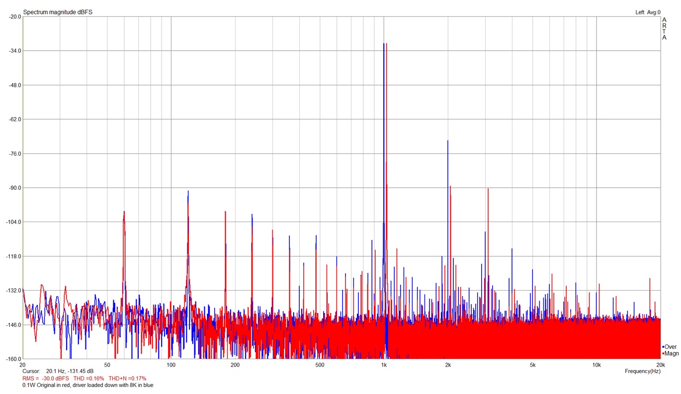

Problem found!
So, I did track down reason for my high THD of just over 1% at 100mW compared to 0.4% similar DC coupled designs are getting.....my driver is simply too clean, offering not enough even order distortion cancelation.
Found this by purposely loading the driver down by connecting the plate of #26 to ground trough 8.2K resistor in series with capacitor.
As expected my driver gain went down a lot and distortion in the driver increased compared to original circuit where there is a 270H choke load on the driver....the final result, my THD at 100mW on the speaker terminal went from 1.1% to 0.16%!!!
The question is if purposely increasing distortion in the driver to get more cancelation on the output is the "right" way to improve the design?
I could wire my choke windings in parallel and reduce it from 270H to 67.5H which would reduce the load on the driver, decrease it's distortion and probably result in lower THD on the output....but would this really sound better?
One can see from the attached comparison of the original measurement at 100mW (in blue) and new, with reduced load on the driver (in red) that there is about same dB reduction on the second order as there is increase in the third order, but total THD went down from 1.1% to 0.16%.
I guess, best would be to focus on reducing actual distortion on the output stage and not trying to increase THD on the driver to get the cancelation effect.
I tried increasing the load on #45 by using 15ohm resistor across the speaker terminals instead of 8ohm and did see a reduction in THD; at 100mW THD was down from original 1.1% into 8ohm to 0.73% into 15ohm.

I think you are on the right track.. I generally aim for the cleanest driver I can make and then either live with the distortion of the output stage or if excessive I will attempt to reduce it. The first step might be to try the earlier suggestion of applying a 16 ohm load on the 8 ohm tap and seeing what happens. I would expect at least a few dB reduction in distortion everywhere.
I would tend to prefer the blue FFT plot over the red. Not that there isn't room for improvement, of course. But adding distortion purposefully isn't likely to improve your situation other than provide a THD number improvement.
Yes, I agree that purposely increasing distortion in the driver just to get more cancelation does not sound right, so what I need to try is to reduce distortion in the output stage.
