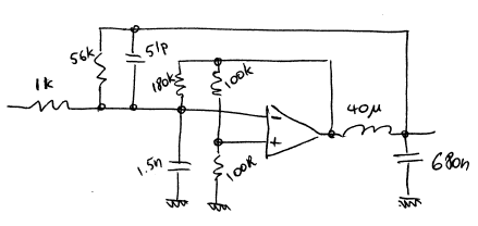

Hysteresis amps are a bit more amenable to intuitive analysis and therefore may be a more practical starting point for beginners. I began that way 🙂
One important thing: Get the positive (=hysteresis) feedback from the power stage as well, not from the comparator output. Otherwise you'll find the switching frequency changing with power supply voltage.
A good hysteresis value is 1/1000.
Attached is a drawing which I put up earlier somewhere (it could have been this thread), showing a hysteresis amp with mixed feedback. The "comparator" symbol includes the switching stage.

Hang on... are you saying you were using one half bridge for the hysteresis and the other one for the feedback? The two half bridges will never operate identically, so you need to use both for the negative feedback (even if you decide to use comparator feedback for hyst.).
Attached is how to make a simple full-bridge self-oscillating amp. This circuit is used in this product (and others in that range).
http://www.bwspeakers.com/index.cfm/fuseaction/products.models/label/Model ASW CDM
The disadvantage of allowing the switching frequency to change with power supply is not enormous, unless you intend the circuit to operate over a wide supply range. It's just nice that you can have one modulator setting that you don't have to change when making new amps based on the same circuit.
The frequency swing with signal of hysteresis amps is already quite large. Increasing hysteresis will make this situation worse (capacitor charging can no longer be simplified as a linear ramp). If the gain of your amp is small, larger hystereses are not such a big problem, but if you want to have a gain of 30, well...

You mean the second half bridge is running off the same comparator but the feedback loop doesn't see it? That is just as bad as the previous case.ChocoHolic said:In my current simulation I am picking pos and neg feedback from the same halfbridge. The second halfbridge is running simply inverted with additional control.
Try wobbling the power supply to see what I mean. PSRR=0

Hi Bruno!
Glad to hear your opinion on optimizing everything with simulation....
I am 200%
with you in this regard!
PSSR=0?
Doesn't the second halfbridge bring a system inherent high PSSR?
As you switch the rail modulation in positive AND negative direction to the load, the low frequency modulation in the load current should be very low... I thought... ???!!!
....hm, I think you might be right.... uhps!
If the feedback is from one end only, then the rail modulation will be given non compensated to the input......
Anyway, I am already simulating your cross symetric proposal.
Apart from some convergence issues (as usual) it was working fine from the very beginnig. I split the ramping cap and put the center tap to ground in order to overcome this....
...before this the differential showed heavy common mode jumping, because the power stages do not always switch perfectly at the same time....
Attached file shows the full symmetric arrangement.
