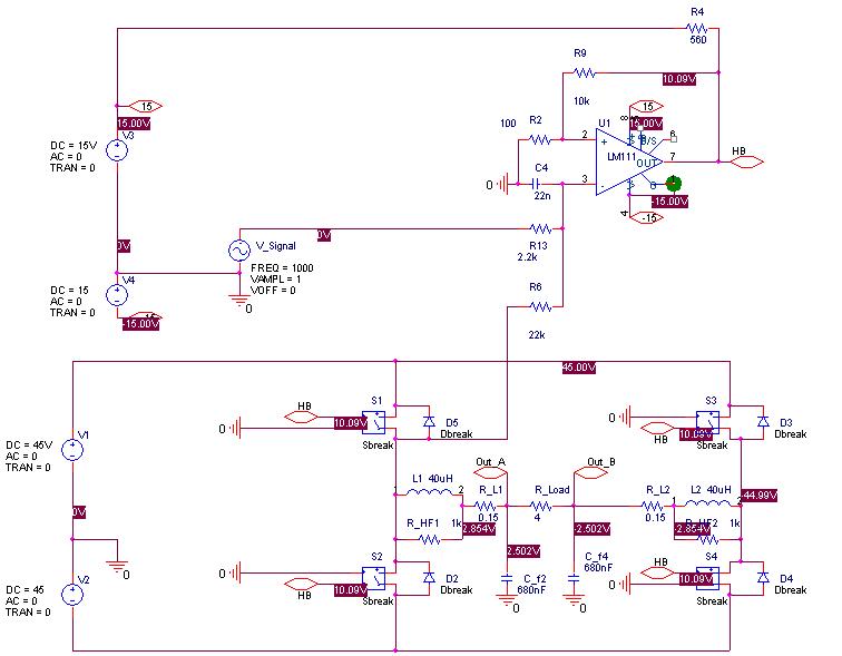

self oscilating
Hi again!
I got inspiration from the UcD-thread. I did some simulations and... -OK, the beast was working... Also I was able to get a brief idea how it is working.... But to be honest: Theory of UcD is no fun.
Calculations ...OK, but Bruno (!!!) how do you manage to model your design in your brain??? I mean, if my brain cannot intuitively think what's going on, then debugging a real amp is getting tough!
But I like the idea of selfoscilation.
I think a simple hysteresis design is much easier to understand and
up to now I do not see much advantages of the UcD, except that the feedback is picked behind the output filter.
I am getting more and more a friend of a circuit as attached.
It is easier to understand and already gives impressive results in simulation. At 1kHz: THD=0.03 %, 3rd harmonic = 0.01%....
The attached file is showing a simplified full bridge. Well the distorsion of may not reflect perfectly the reality. But I think, if I manage a proper short dead time, then I will come close.
DC COMPONENT = -1.329206E-02
HARMONIC FREQUENCY FOURIER NORMALIZED PHASE NORMALIZED
NO (HZ) COMPONENT COMPONENT (DEG) PHASE (DEG)
1 1.000E+03 4.606E+00 1.000E+00 -6.769E+00 0.000E+00
2 2.000E+03 5.486E-04 1.191E-04 8.646E+01 1.000E+02
3 3.000E+03 4.604E-04 9.994E-05 1.127E+02 1.330E+02
4 4.000E+03 5.125E-04 1.113E-04 8.953E+01 1.166E+02
5 5.000E+03 7.015E-04 1.523E-04 5.169E+01 8.554E+01
6 6.000E+03 2.762E-04 5.996E-05 1.271E+02 1.677E+02
7 7.000E+03 6.567E-04 1.426E-04 2.739E+01 7.477E+01
8 8.000E+03 5.398E-04 1.172E-04 1.341E+02 1.883E+02
9 9.000E+03 8.001E-05 1.737E-05 1.038E+02 1.648E+02
10 1.000E+04 3.606E-04 7.830E-05 1.236E+02 1.913E+02
TOTAL HARMONIC DISTORTION = 3.222336E-02 PERCENT
In order to improve further, it might be possible to add a differential amp (giving gain and the possibility to pick differential feedback behind the filter) and settle an outer loop. For a subwoofer, the frequency compensation would be no bif deal. For full audio range the outer loop may require some brain work.
Charles already said "PID".... 🙄
Back to my basic question:
What is the main advantage of the UcD, except that already the simple structure picks the feedback from behind the filter?
Looking forward to your comments.
Bye
Markus
