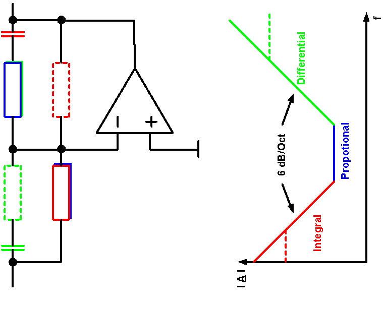

Hi Markus
Do you know what a PID controller is ?
If you post your schematic i'll try to help with component dimensioning.

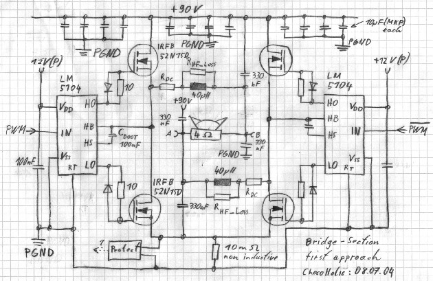

I did not draw the schematic. But it might be the right time to transfer the schematic from brain to paper. I will post it within the next days.
My plan for practice was to start with the PWM first, get it running to drive a headphone (with small filter), without the MosFet bridge... and then in next step I would add the powerful stuff....
Great that you offer your direct support!!!
Bye
Markus

... your PID is exactly my PID....
Glad to see, that you also seem to be a friend of 'Bode' !

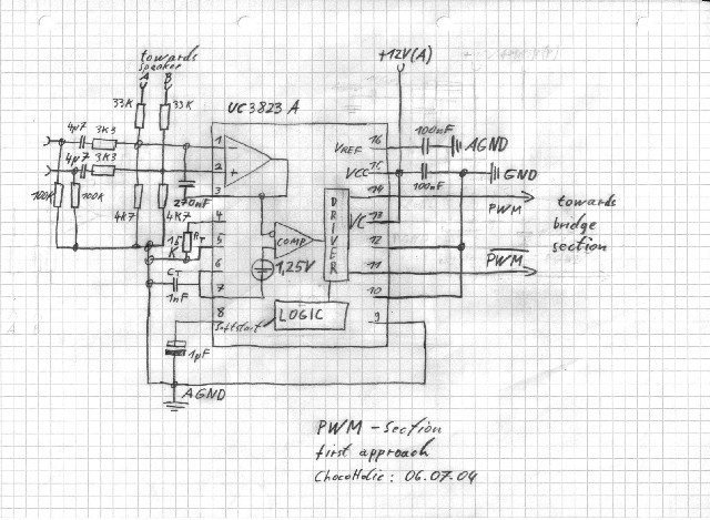

PWM schematic
Hi Guys!
This night is the perfect night to put the
schematics of my first theoretical approach to
this forum.
I will start with the PWM section.
(The BRIDGE section will follow in the next posting)
I have some enhanced version of the standard PWM control
"xxx3825" with me. The UC 3825A. I will run it voltage mode.
RT (15k) and CT (1n) are setting the PWM frequency to 150kHz.
Nice point of the UC 3825 it also delivers the inverted PWM
signal. Great, this helps me to drive a full bridge by two
simple half bridge drivers...
Gain & frequency compensation:
The sawtooth of the UC3825 ramps between 1V and 2.8V.
This difference will correspond to -90V .... +90V at the output.
So the gain behind the OP amp is 100 (40db).
For my first approach I would try to drop the overall
forward gain to 0db at 31kHz by simple integration,
as at 31kHz we will have the heavy phase jump of the output filter.
For lower frequencies the phase shift will be dominated by the
90° of the integrator (...neglecting some nanoseconds delay of the
UC3823 and power bridge).
My closed loop is designed for 20db gain. So feedback will drop
to 0db at 3.1kHz. Quite restrictive, I think....
But at the relevant signal frequencies below 45Hz, this will still
give reasonable 37db feedback.
For this the OP amp circuit (without feedback from speakers) must be
down at -40db at 31kHz, which is ensured by the integration cap
of 270nF. Probably I can try higher feedback, later in the real
circuit.
Please find attached the schematic of the PWM section.
Looking forward to your comments
Markus
Markus
BRIDGE schematic
BRIDGE section:
The IRFB52N15D offer 150V / 32mOhms / 60A and a low gate charge around 60nC...70nC. I hope that I do not need external freewheeling diodes.
Which experiences did you make with the integrated body diodes of MosFets?
If you are using external diodes: Which types showed good results?
I still think that the LM5104 are nice half bridge drivers, especially their adaptive dead time seems to be exactly what I need. The Chip detects the gate-source voltage of the MosFet which is beeing turned off. It does not turn on the other MosFet before the first MosFet is really showing a low gate source voltage.
Sounds nice and promising.
But in fact the real thing might still need some correction....
Also it is fine for me that the LM5104 uses a single PWM input and
generates both gate signals from this, which is matching nice to my
plans in the PWM section. Also the LM5104 has an integrated boost diode for the supply of the high side driver....
http://www.national.com/ds/LM/LM5104.pdf
Filter:
Rdc is simply the copper resistance of the wire.
RHF_Loss reflects the losses in the core and the high frequency losses in the winding. 40uH for 30Amps will be fun to design (love that stuff) ...
I decided to use symmetrical split filter caps. For HF the 330nF to ground and the 330nF towards 90V are in parallel. They will have to carry a lot of HF current, so I would probably have to parallel some high rated types anyway....
HF-blocking of the 90V rails.
I think I will need a battery of large MKP caps for the 90V rail as close as possible to
the MosFets....just a guess... Any experiences available?
Here is the schematic of the BRIDGE section.
Bye
Markus

Hi Markus,
I used irfb52n15d in sub amp +/-50v to 2ohm load, 5 day ago, and find they pretty easy to open/close, like irf540n or so. I'll try forget irf3415 -nightmare, very heavy fet, but irfb53n15d($2) 1.5 times more expensive. Fairchild's fets, which our pro guys loves, unfortunately isn't found in accessible price list.

You cannot use this PWM IC in this fashion. The driver outputs are toggled in order to control a push-pull SMPS topology. If you want to use this IC you will have to OR the outputs and do the inversion of the control signal for the second half of the bridge by yourself.
There seems to be an UC3823 variant without the toggle function (the version without suffix A).
RE feedback: Your loop gain is O.K. for playing around first, but I assume you will soon want to increase the unity-gain point up to 70 kHz approx. 😉

Hi Ivan!
...yes price is not very convenient, especially I am still looking for
a distributor in Germany who offers them without horrible shiping costs.
On the other hand.. it's a DIY project, not a cost optimized design
for professional mass production... So I tend to pay more in order to get high performance. And your positive experience with the technical performance of the IRFB52N15D also pushes me to try them.
So your are also using them without external diodes, right?
Hi Charles!
Uhps, seems like I did not read the data sheet of the
UC3823A careful enough. Thanks, for the hint. I will rework this topic.
...glad to see that your opinion on my feedback is perfectly matching
my thoughts.
Bye
Markus

...PWM controllers...
...hm, yes... definitely the UC 3823A is not what I need....
Thanks again Charles, your comment saved me at least one
day!
I must admit: Who can read- takes advantage! ..should really read data sheets more careful in future..
...well, I started to look around for suitable PWM controllers, but it seems that most of them have already integrated the toggling flip flop for push pull applications...
UC3823 (without A) as proposed by Charles seems to be closer to what I need , but not offering inverted output, ...will check suitability in detail...
Bye
Markus
