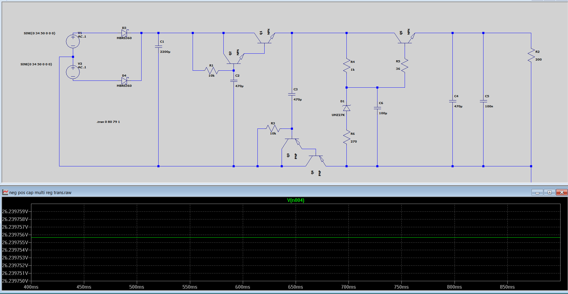

PSU
Hi guys,
I might give this set up a go. Ill try it without the zener reg also.
The darlingtons could be BD679 and BD680. The npn bjt could be MJE243G.
I've not tried this so just remember that if you build this.
The output has 1uV per division. The ripple before the cap multi is about 560mV peak to peak.
The transformer I modeled was a 24V+24V.
If I try this and it works well I might make a PCB.

My plan for my 26V supply:
Rectifier->2200uF cap -> capacitance multiplier in positive and negative line -> common mode choke -> 1000uF and 1uF-> 26V input.
