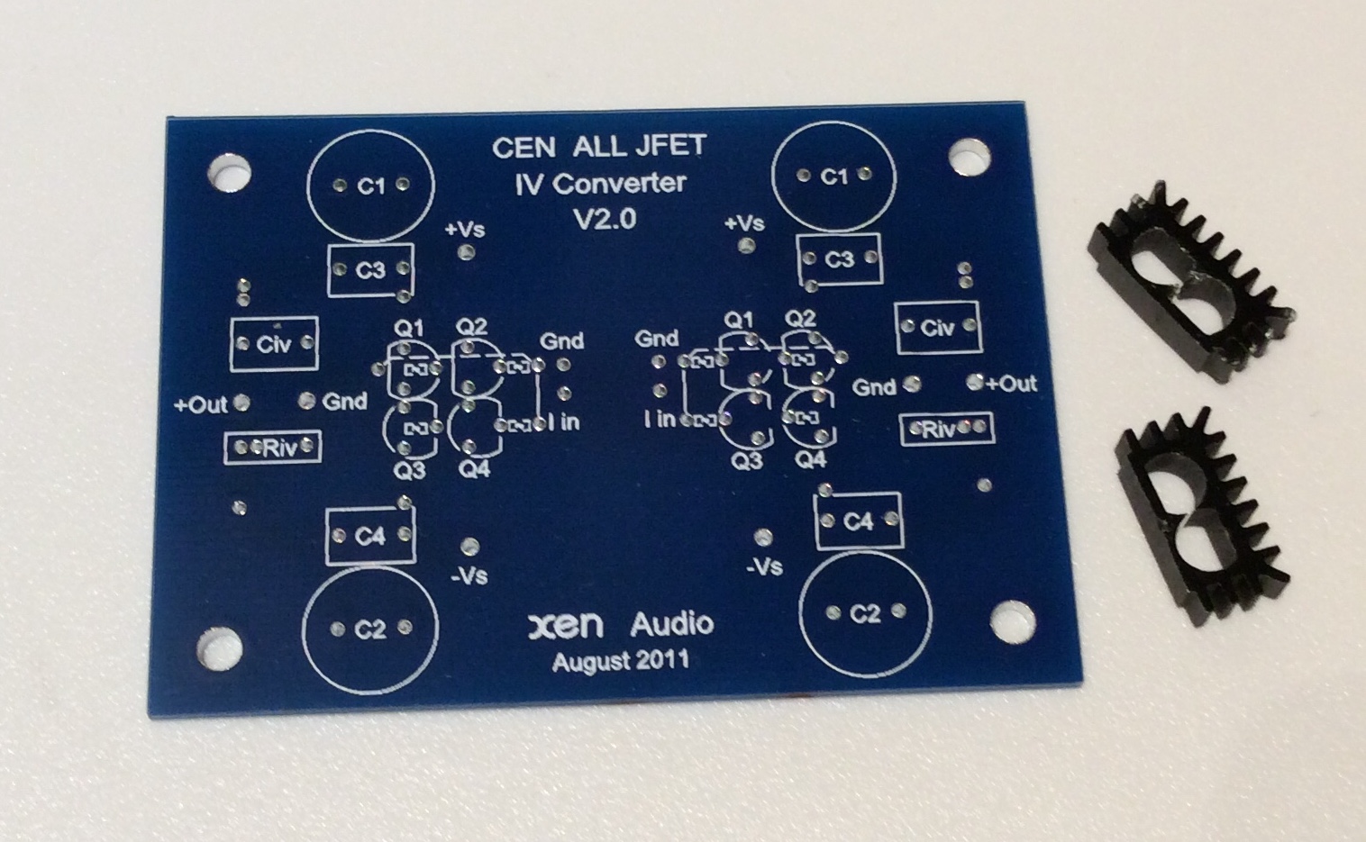

I know there has been interest from others in this GB in the IV that RyanJ is using, namely the Cen.
I have surplus to my requirements
1x Xen Audio designed Cen All JFET PCB
1x pair TO-92 heatsinks (hard to come by)
You will need to source and match your own jfets.
Happy to send in exchange for other audio related pcb 🙂

Mods= please move if not appropriate here.
I need a Sen. single ended correct?

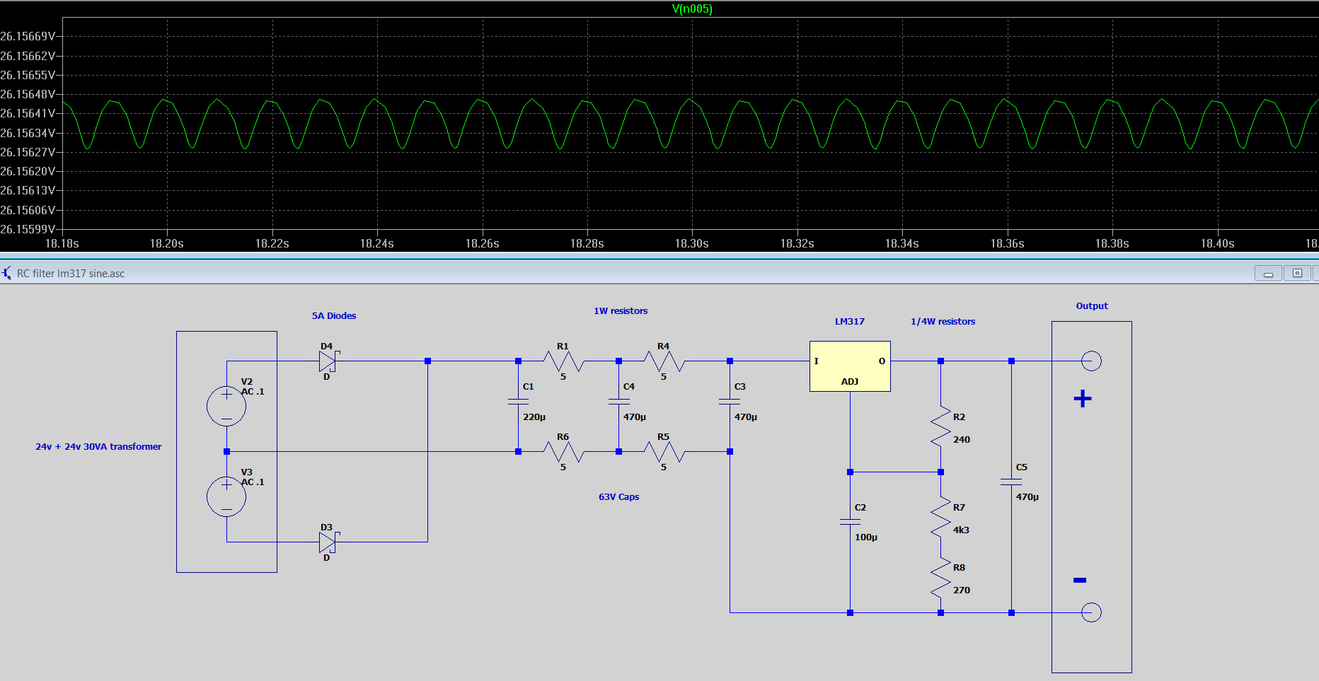

Hi!
I'm still very clueless with the 26 volt floating source, to see if I understand it now.
Would I serve any linear source even if I have references to GND whenever that source has no contact with any other than if I work with GND?
What I want to know is if it would serve a linear source like this (which has GND):
Module d'Alimentation Lineaire Regule LM317 / MJ15025G 3.3V a 33V DC 5A - Audiophonics
whenever you connect it only and exclusively to the secondary of a transformer that only feeds this linear source. So by + exits only positive voltage and GND comes out only the negative voltage.
Is this right or do I definitely not find out anything?

Hi Jjazz,
Yes that would work, as long as those mounting holes are isolated from your system GND by using nylon standoffs/bolts. In this case the GND output would serve as the negative when isolated from GND. This supply is rated at 5 amps, you only need 135mA.

I have found these sources of power and regulators of very very low noise:
ULN-PS2 Ultra Low Noise Dual Positive Power Supply
I wouldn't use a dual supply because the GNDs may be connected meaning you couldn't use it for both the 8V and 26V supplies.
Sounds expensive and overkill.
Why not just get some verro board, diodes, resistors, and caps and have a go at building your own?
I've attached a sim of a circuit that is easy to build yourself on vero board. It sims at under 200uV ripple.
Ryan
Thank you to those who expressed interest in this PCB and heatsinks.
I am very happily swapping it for a DCB1 Hypnotise PCB that was offered in exchange. Sorry I only had one to offer. Happy building.
