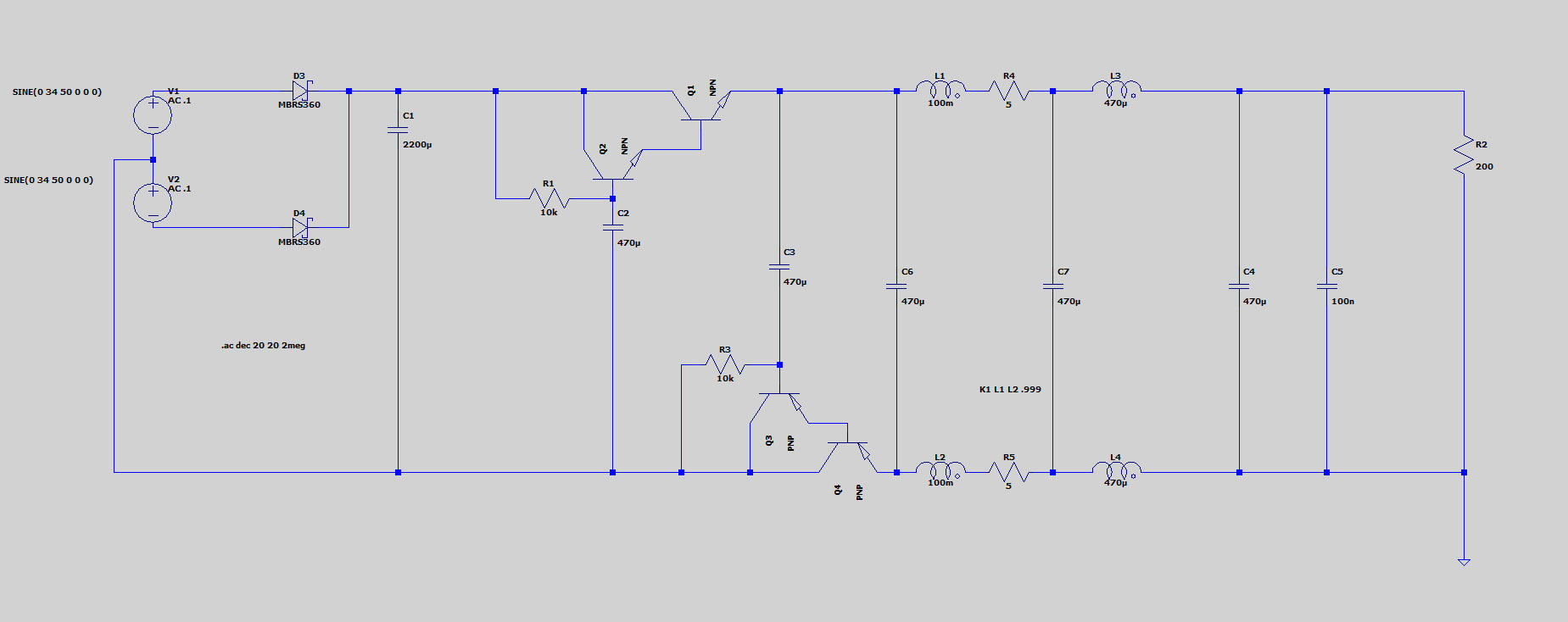

I'm interested in what you're going to be using for your 26V supply. Ill attach what im using at the moment as it seems to do a great job at reducing ripple to levels I cannot see on my scope at all.
For the output stage I've just recently put in a Direct Coupled B-1 Buffer -Hypnotize after the CEN and it complements it very nicely, seems to drive my F5 Amp much better with absolutely no negative side effects. Bass sounds more controlled.
For my CEN 18V supplies im using a shunt reg similar to what's on my D2 pcb (TL431 with PNP pass transistor) and also using the same capacitance multiplier and filtering setup as the 26V supply which reduced the small amount of buzz/hum I had coming out of my speakers since I went from battery power to transformers.
Ryan

Hey there,
The transistors I used are the BD680 and B679, which are darlington power transistors, the current gain is around 1000. In the schematic I posted earlier, the 100mH inductors are actually a common mode choke (Part link)
For the diffrential chokes, I was thinking something like this (Part link)
The BC550/60 might get a tad hot, if you did go this option, check out the internal schematic of the BD680/70, as there is a few resistors internally. (its listed here or its in the data sheet.) Its easier to just use the darlingtons in my opinion, but you could possibly get better results using separate transistors, not sure.
You may like to try without the inductors first and just use an RC after the CapMx to drop the voltage to between 26 - 27V. You should get around 500uV peak to peak ripple this way. With the inductors Im seeing nothing at all, its buried by the noise floor at 250uV. I need a better scope for low noise stuff, mine only goes down to 2mV per division, so those numbers are just approx.
Hi Ryan
That R2 of 200r on the rh side of your Psu schematic - is that just a load for your measurements, or part of the circuit?
Do you have heatsinks on these Darlingtons?
Clayton
Hi Clayton,
R2 was just to simulate the load. No need for heatsinks on the darlingtons they only get a little warm with this current load.

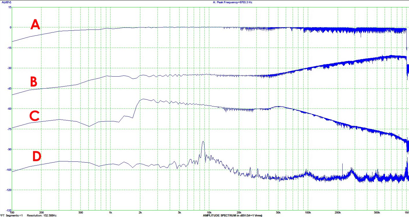

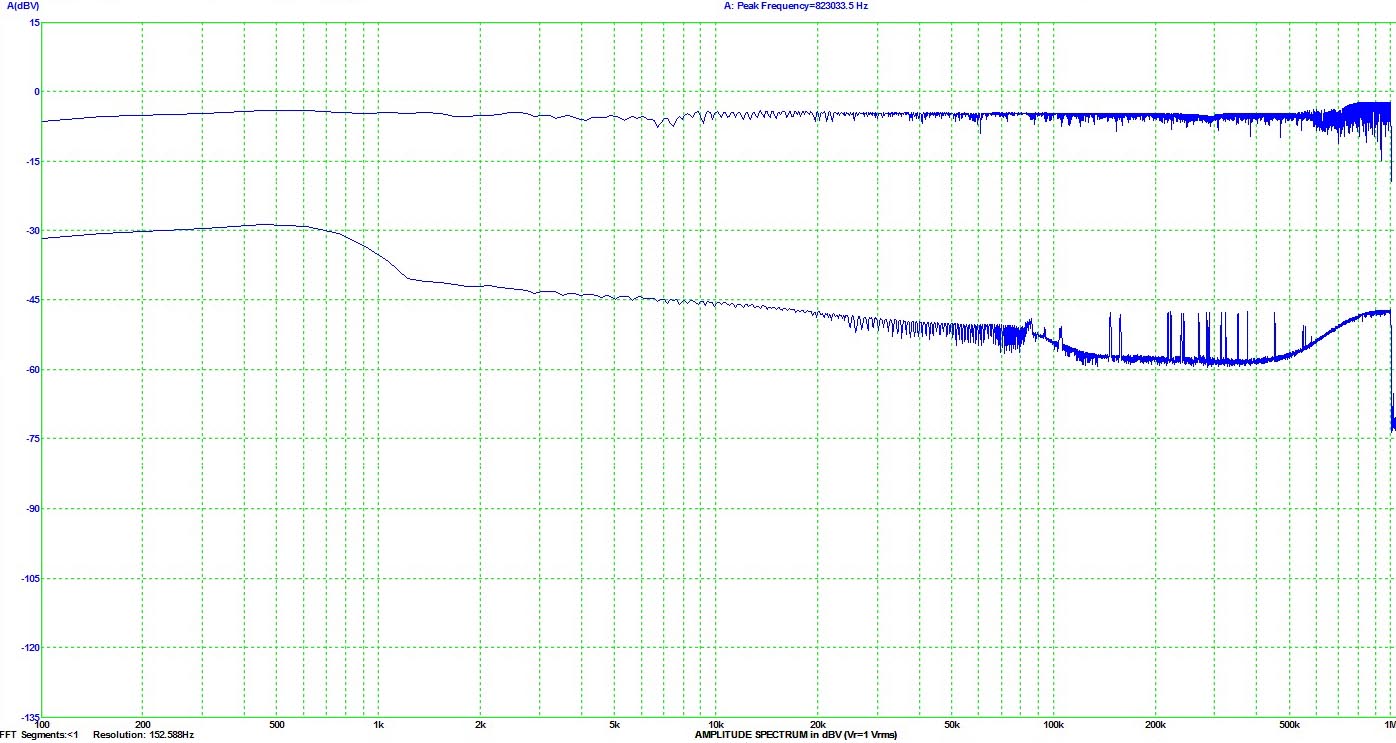

FFT of Cap MX
Hi All,
Just been playing around in the shed trying to get some meaningful measurements from the cap MX circuit I posted in post #101. (attached here also)
I injected 1V RMS signal sweep from 100hz to 1Mhz into the input of the circuit.
Circuit under test was powered from a DC source with a load attached.
The filter cap (C1) was removed for the test as it provided an impedance way too low for the amplifier I was using to handle, I think I had about 11ohm zout.
The attached image shows the levels measured at various points in the circuit.
A - Signal sweep input (where C1 was)
B - C6
C - C7 and C4 had very similar levels.
D - This is the noise floor of the measuring system with the settings I had on. It was also the same output level as when the circuit under test was being powered by the rectifier with the filter cap in place.
When you consider these measurements plus a 2200uF filter cap added to the start of the circuit, it seems to have quite an ample amount of Noise/Ripple rejection before the Voltage reg/CCS of the D2 PCB.
Ill give it a bit more thought but i've already started laying out a PCB so if anyone's interested in one just start a list in this thread. eg: "ryanj x 1 capmx pcb" and ill get a few extras made up.
These measurements are obviously a fairly amature attempt, but it at least gives some indication of what is going on in the circuit.
Ryan.

LM317 PSSR Comparison
Hi All,
After testing the Cap MX I was a little curious how the LM317 would fare under similar circumstances.
Very similar test setup as the Cap MX, same load, same voltage drop and no input cap. I didn't quite get the same input signal sweep voltage of 1V RMS in to the circuit due to amplifier limitations, so just take note of the difference between the input(top) and output(bottom) FFT.
Overall it looks like the LM317 does well in the high frequencies but not so well in the lower/audible range.
Ryan.

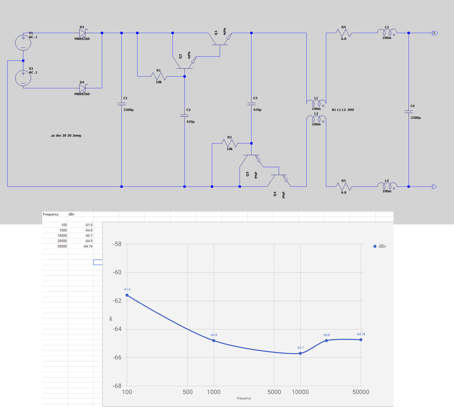

Hi guys,
Attached is a schematic of the cap MX circuit that I ended up with after testing. Also attached a basic ripple rejection graph of the measurements I took.
The previous measuring setup I had (Virtins multi-instrument) seemed to give me differing results each time, so I used my scope instead using a differential measuring technique. Here's a link to one of Dave Jones videos that describes the technique I used: YouTube
Test setup was the same as before but using my scope to analyse the waveform instead.
I had a short listen to my system with this circuit in place and its sounding like i've gained some improvement in sound quality, Ill have a better listen soon.

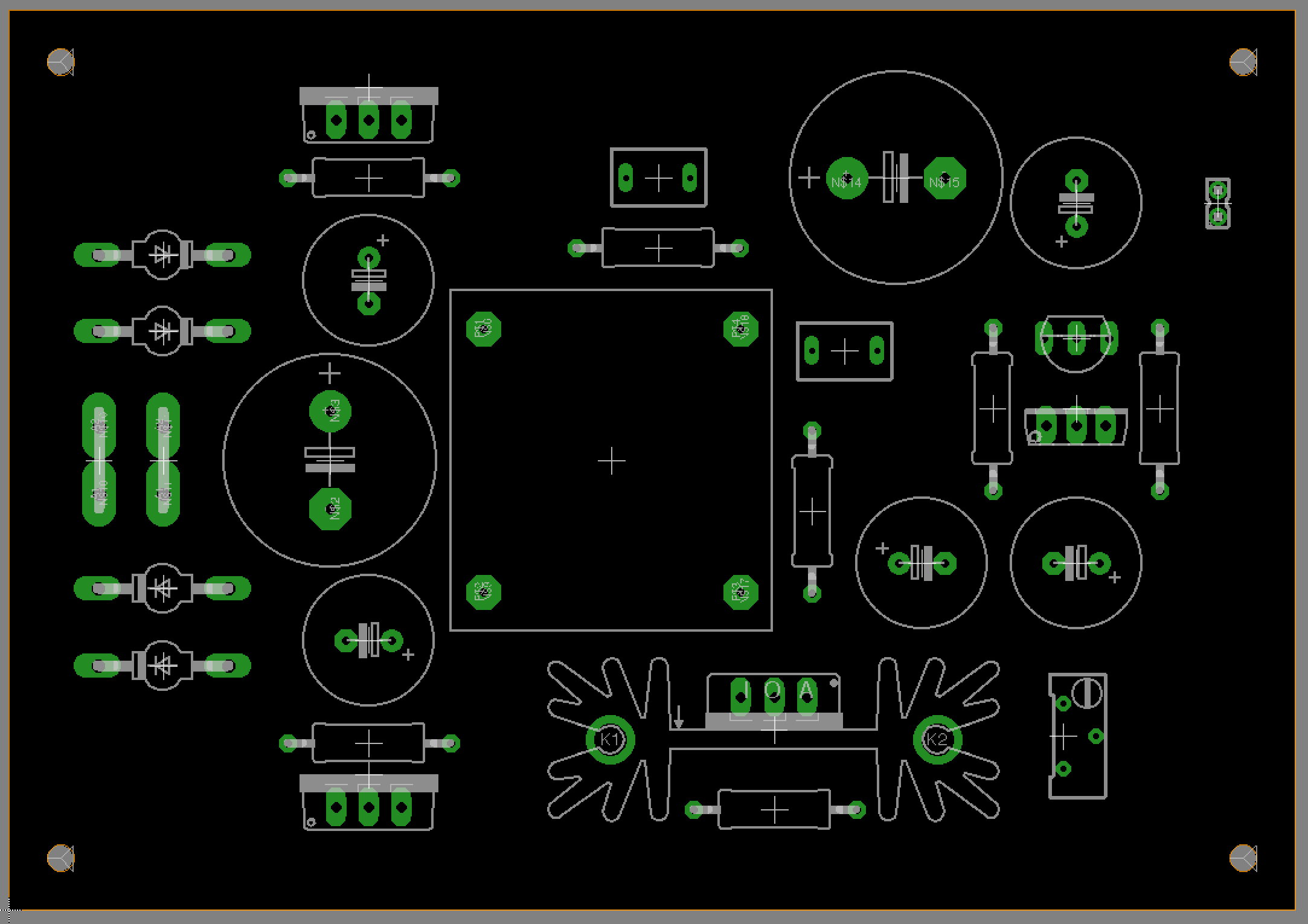

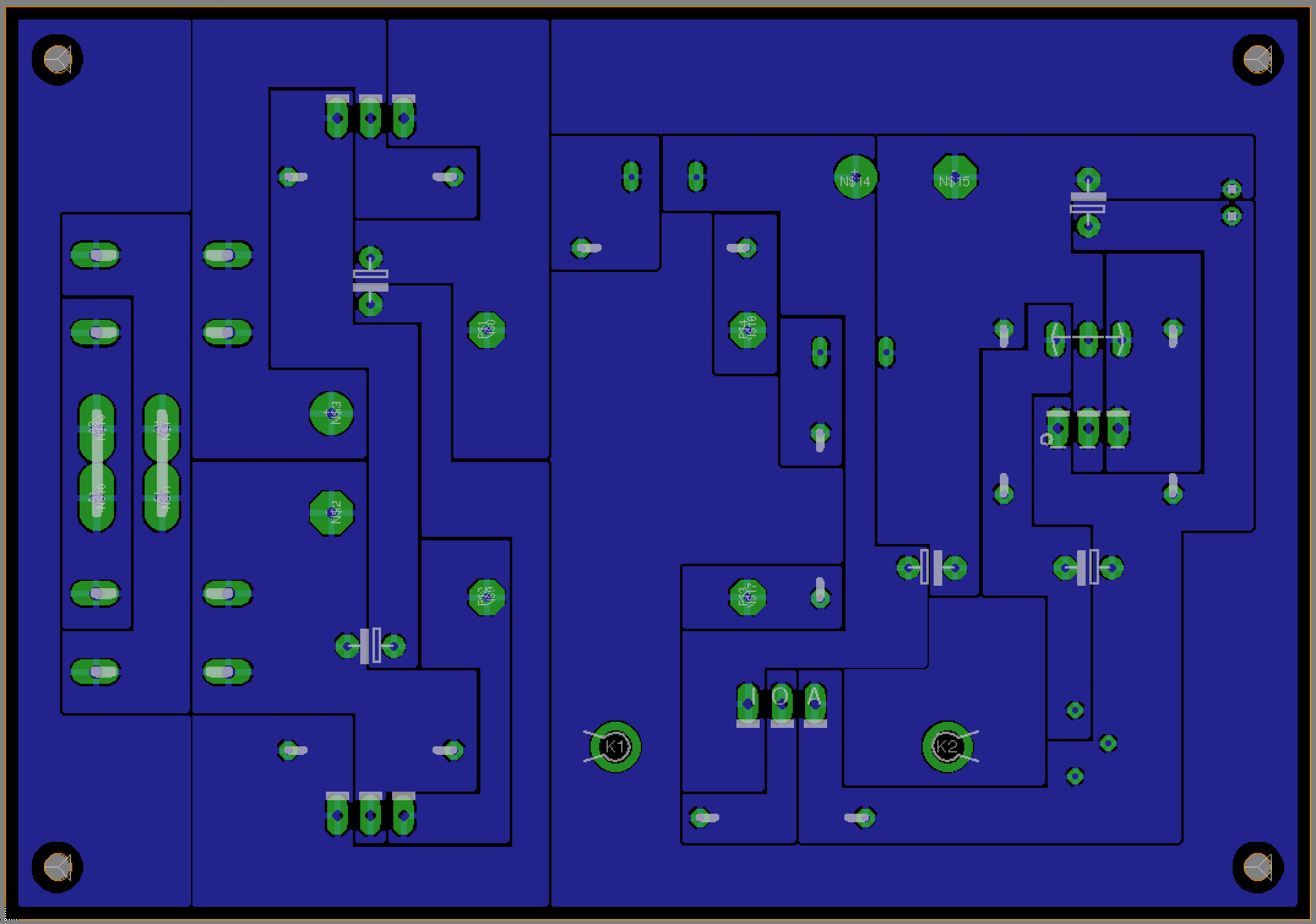

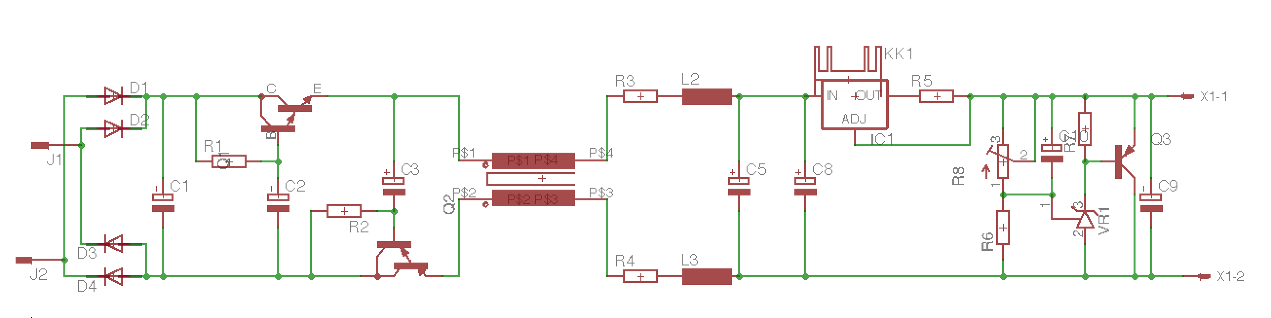

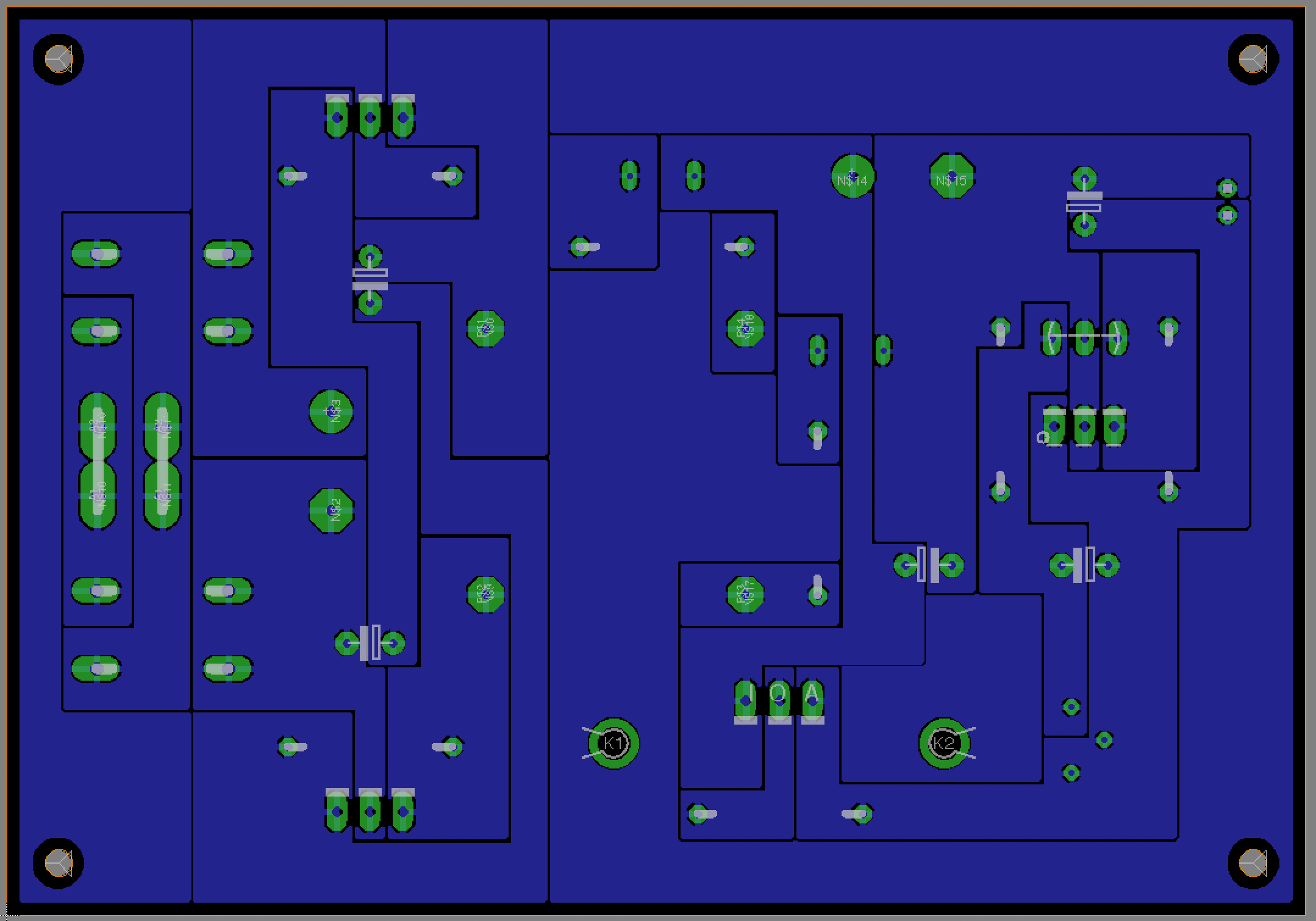

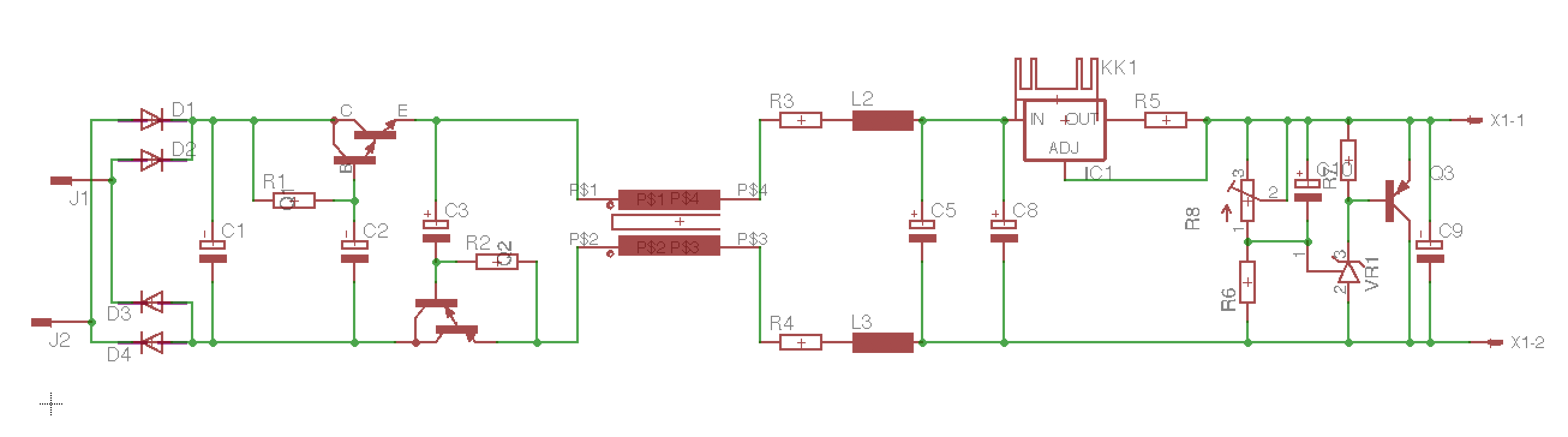

PSU
Following on from setting up PSUs to feed the Distinction board and, for me, a CEN output stage.
For the CEN I will use Ryan's CapMx and some LM317/TL417 regulation. I will make the attached by hand milling the boards, as per a previous post - so have designed a layout that allows for single sided pcb. The CapMx board will be of course much simplified.
Thought I would post these before I set to making them - part selection according to my own BOM of course, leaving no options for different part sizes.

Joined 2016
Doh!
Just noticed R2 on the pnp is on the wrong side - thought I had fixed this earlier
Disregard my last post - Be right back with corrected version
