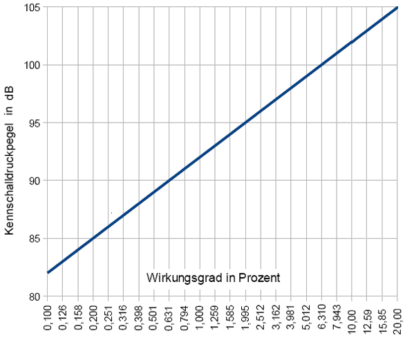

Wirkungsgrad in Prozent?
Efficiency in Percent?
Hi Pano,
yes, your german is excellent.
The x-coordinate is "power efficiency in percent" in that diagram.
Cheers
