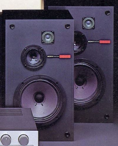

The kind of drivers I very much appreciate for liveliness is the one presented by xrk971 in his recent threads of subjective blind comparison of small drivers. It is a preference, nothing else.
system7, I am also in love with those vintage SEAS alnico drivers.
sony had speakers made in scandinavia with the same drivers too.
the problem was that, at the time of those alnico drivers, crossovers were typically first order with awful capacitors. those cannot handle high spl at all.
later sony switched to the ferrite versions of the same drivers with upgrades to second order crossovers (eg. sony ss-2030). Not bad.
however the older alnico drivers work like magic when updated with high order co or DSP.
Since most everybody else simply doesn't get what this thread is about, zmyrna, we might as well have a private conversation here. I simply don't know how a comment like "nt" advances things. 🙂system7, I am also in love with those vintage SEAS alnico drivers.
