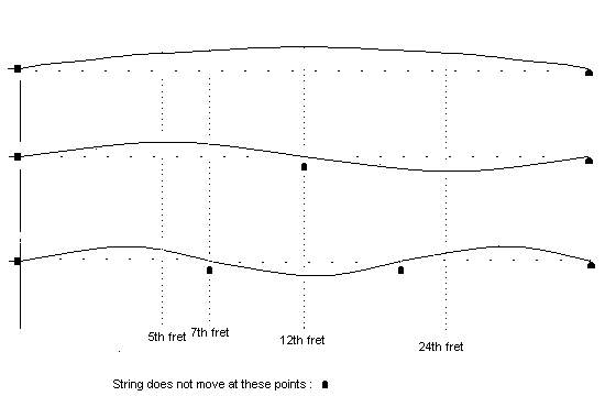

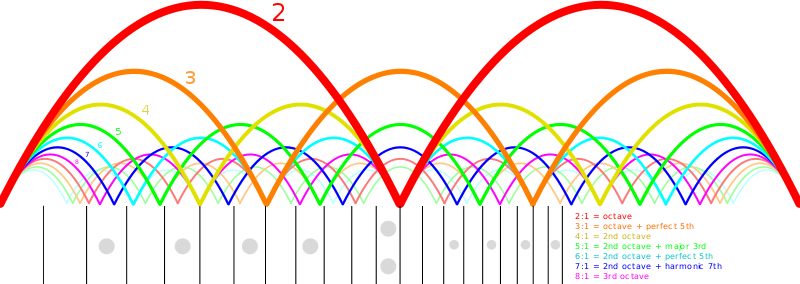

huh... a brace is not really used as a panel stiffener, it does that but that is not why it works, it bisects the surface in the same way your finger does when you press down on a guitar fret board, put your finger half way down the string and you rase the pitch one octave. If the open panel primary resonance is say 500Hz and you bisect it once with a vertical brace you get two panels with primary resonance of 1kHz bisect those vertically and you get four panels with primary resonances of 2kHz.
technically two vertical braces on 3rd's will rase the panel resonance more than an X brace, as an X brace only moves the resonance one octave and the two vertical braces on 3rd's rase the panel resonance one octave + perfect 5th.

revboden: " a brace is not really used as a panel stiffener, it does that but that is not why it works, it bisects the surface in the same way your finger does when you press down on a guitar fret board"
That was interesting. I thought the braces also weakened the vibrations some dB.

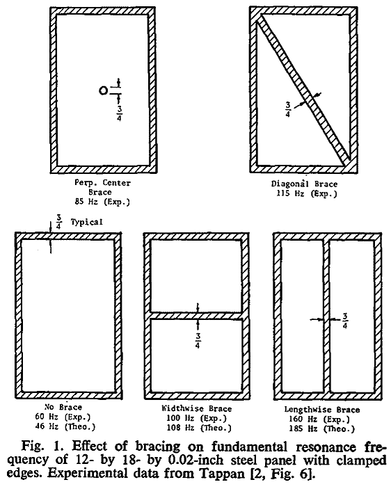

expanding upon this and dividing the panel along the longest width say with 3 braces rather than a single, increases stiffness again. dividing this with horizontal braces will increase it further.
Actually the horizontal brace likely does not improve things significantly.
What bracing does is reduce the span across which the panel can resonant. The short dimension dominates. The relationship here is linear, halve the distance double the frequency. (edit: i see revboden beat me to that)
