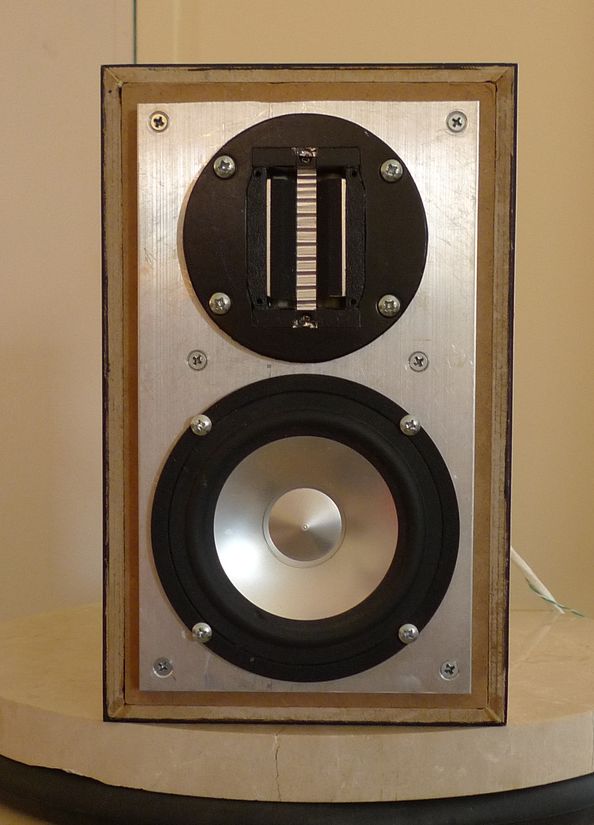

using 4mm aluminium as a baffle, bolted on to the wood underneath. Changing the aluminium front plate would allow for trying out different units if the cutout behind were generous. what effect would this have on sound? It would be stiff, of course.
Something i've wanted to try for sometime. I've got the aluminum, and the shop next to Chris' does waterjet cutting so sometime

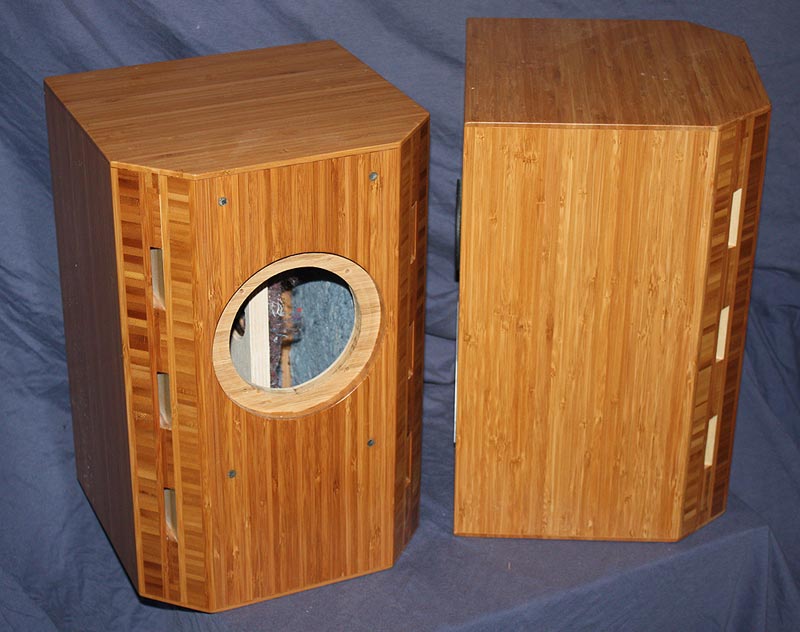

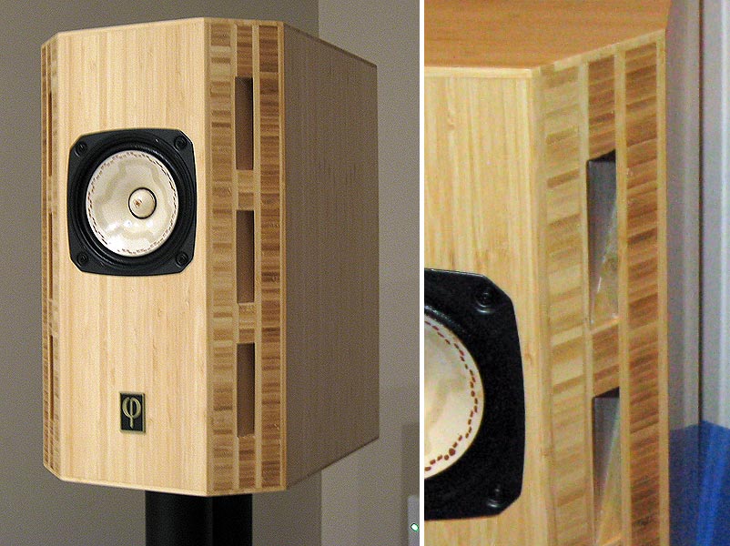

bamboo. Looks nice and available as worktops for instance, as well as flooring
A wonderful material. There are a range of products. The stranded outer, cored plywood is by far the stiffest (and very dense). I've a pair of Fonken & a pair of dMar-Ken7 awaiting drivers in this last. Not cheap stuff, but with care in construction nothing but a clear finish needed.

This is what I was thinking of doing. Did you put any material between the alu front and the MDF or was it just bolted straight on? Did the alu plate cover the whole front or just round the speaker units?
andy
Just bolts so far but I may glue them later. My idea is that the dissimilar materials damp each others natural resonance - and it seems to work well.

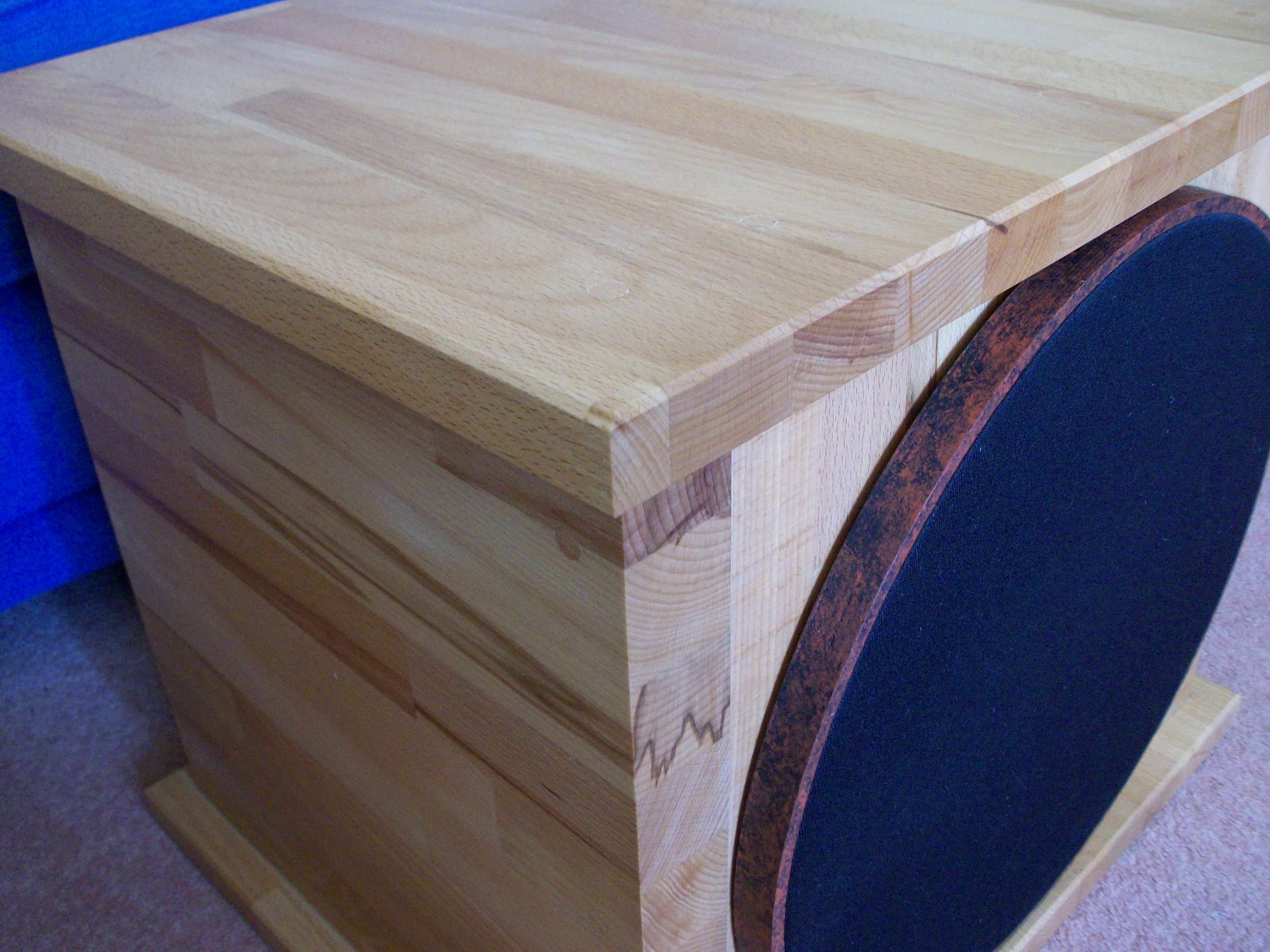

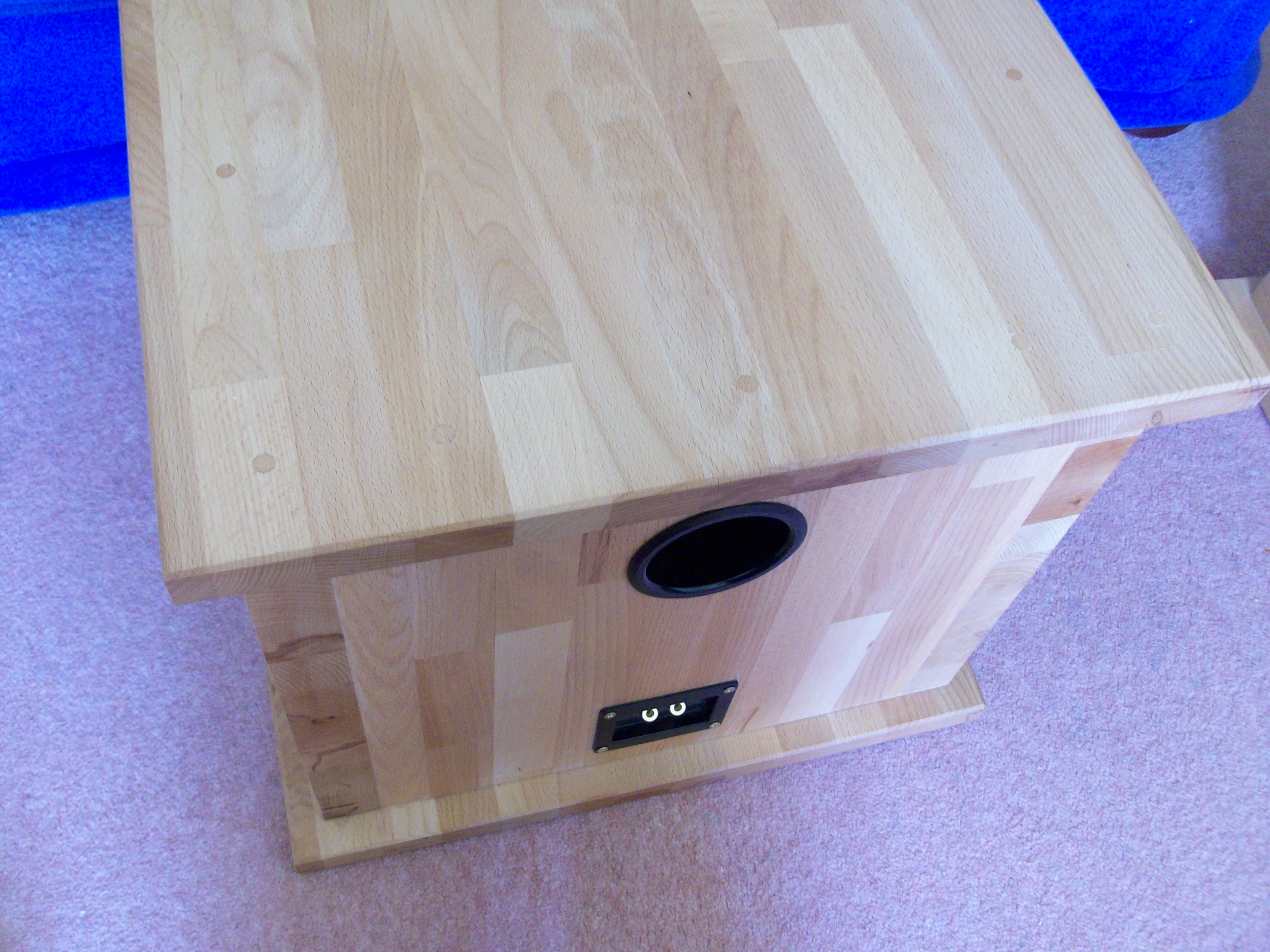

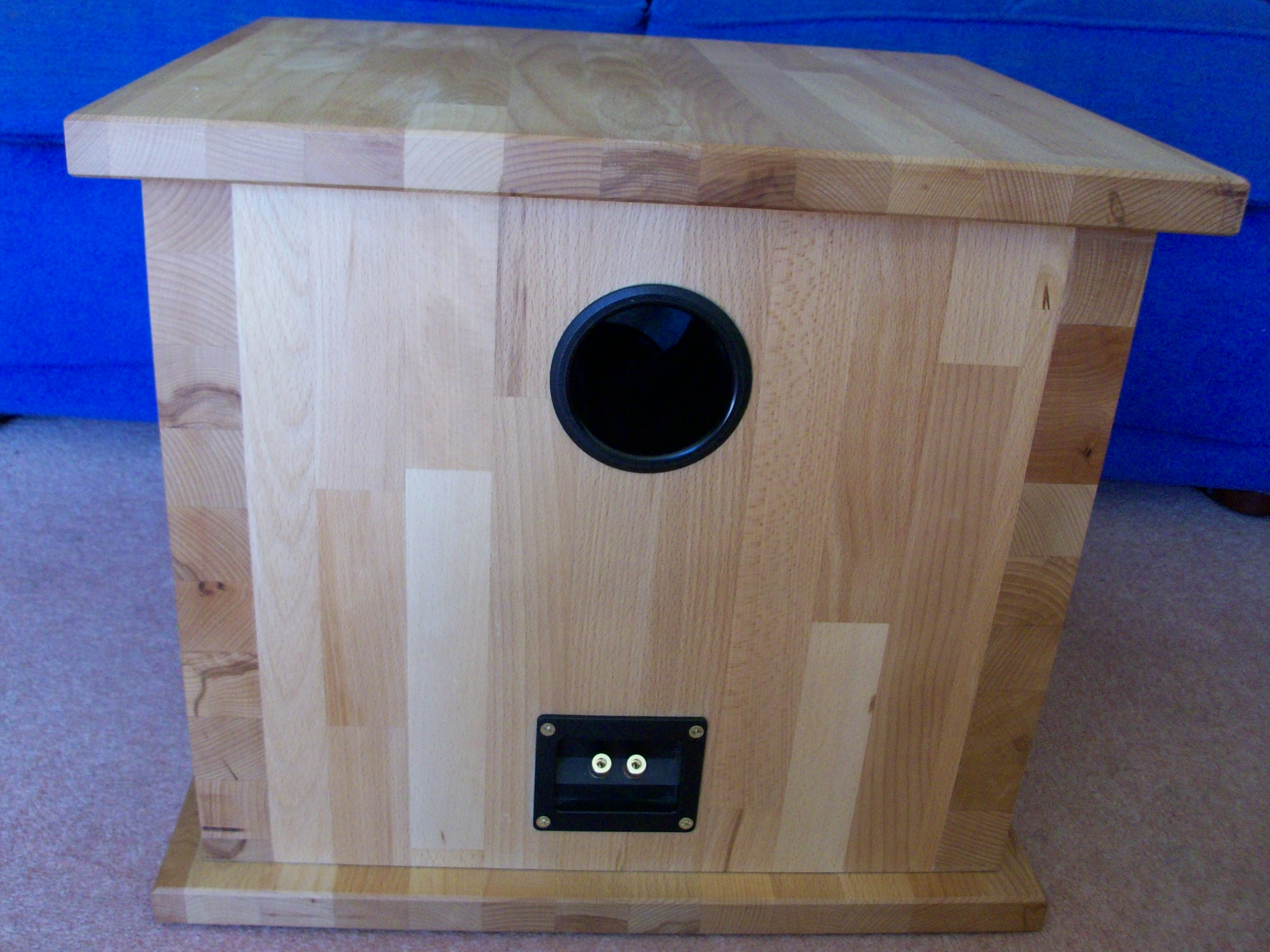

I had a go with solid beech for subwoofers and have been blown away with the stiffness of the material. So much so they're not braced AT ALL!
They look damn great too. Some of you may have seen these images elswhere as I've been trying to sell them and messed around loads with it LOLOL.
Material is 40mm and 29mm thick
This is still work in progress - I'm thinking that I will try a separate cab for each driver - but I attach a pic for progress thus far . . .

Thanks, when they're finished the ali will be covered with cork - I heard cork was a good choice as a outer covering because of the uneven surface.
The difference between these composite baffles and original 1" MDF baffles that came with these cabs is quite significant so I think it's well worth experimenting.
My top two choices would be what I did here with ali & mdf or 6 - 9mm MDF or similar on the outside lined with 12 - 18mm of concrete inside. I tried this latter method with OB and it worked well.
My general take is to simply use two dissimilar heavy materials bonded together to damp resonances - but however much we can reduce cabinet vibration it's very hard to eliminate it completely so next I try a different cab for each driver to stop inter driver interaction.
Village plank - where did you get that solid beech? I'm in the UK too and interested! As far as I gather, strips glued together are more stable and less likely to crack.
Andy
Here you go....
Beech Worktops
I dare you to have a go with Wenge lolol..... super expensive!
Indeed the 40mm x40mm staves are 93 times stronger than MDF and 66 times stronger than birch ply of the same thicknesses in tension testing. People need to listen to this as I will only say this ONCE...... you ready........ Drum roll...... PROPERLY KILN DRIED AND TREATED HARDWOOD WILL NOT MOVE, SPLIT, WARP, CHECK, SHRINK OR EXPAND...... END OF!!!!!
