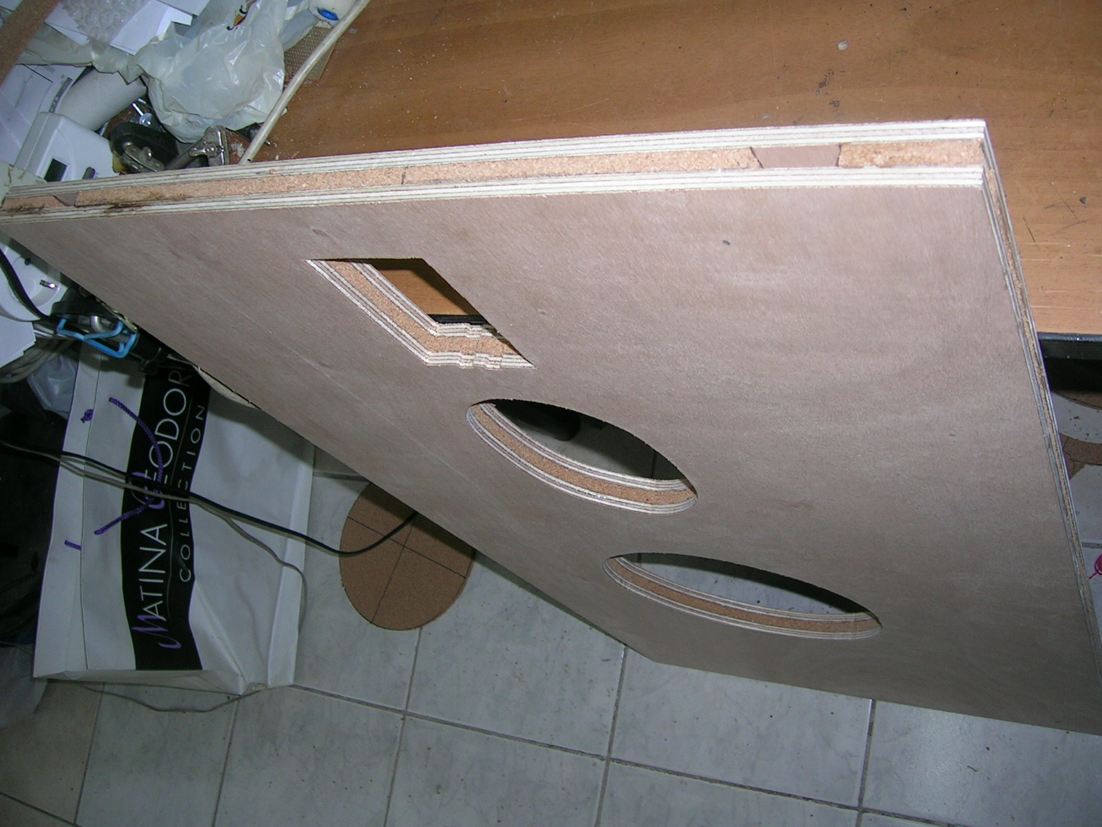

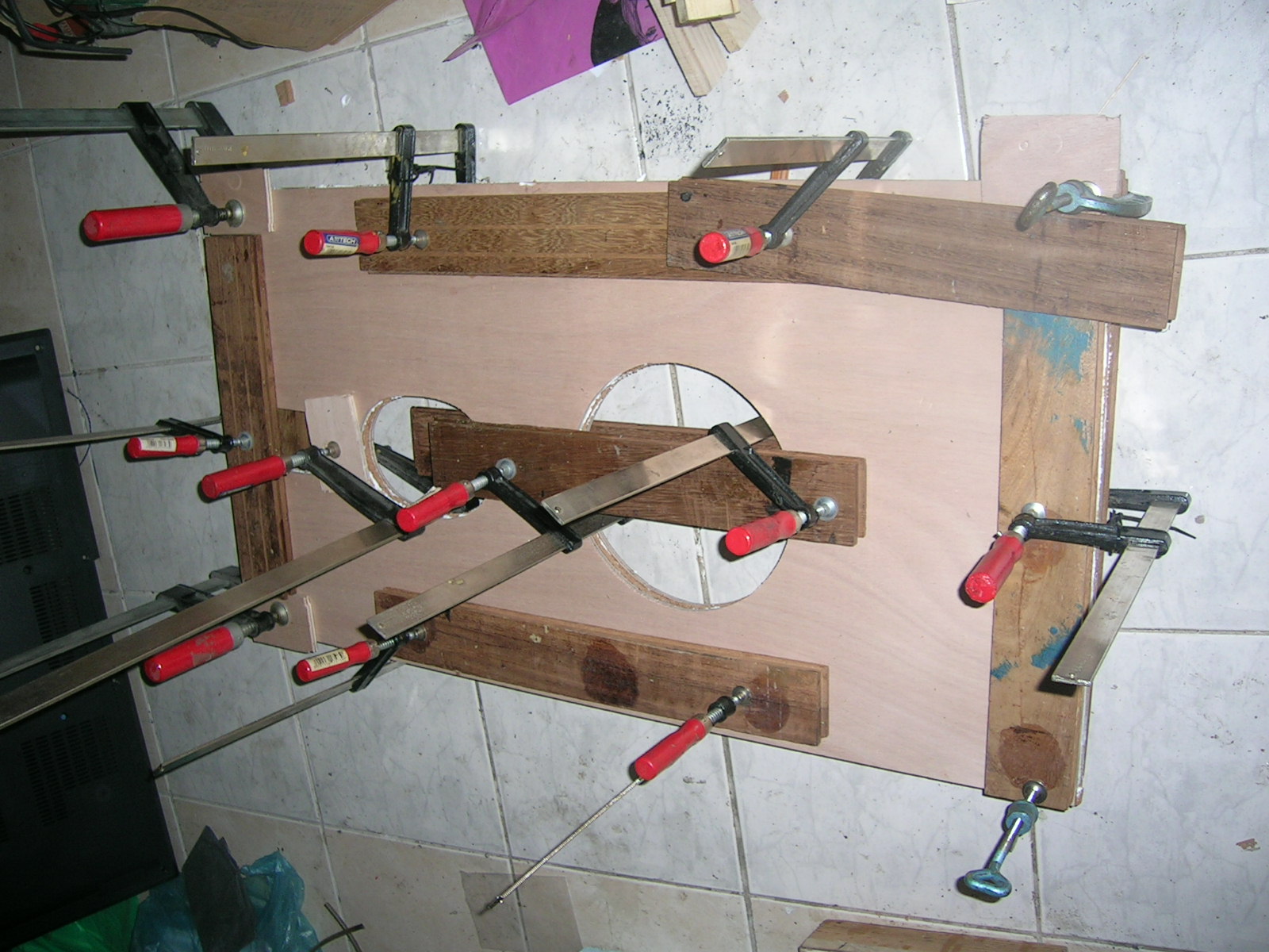

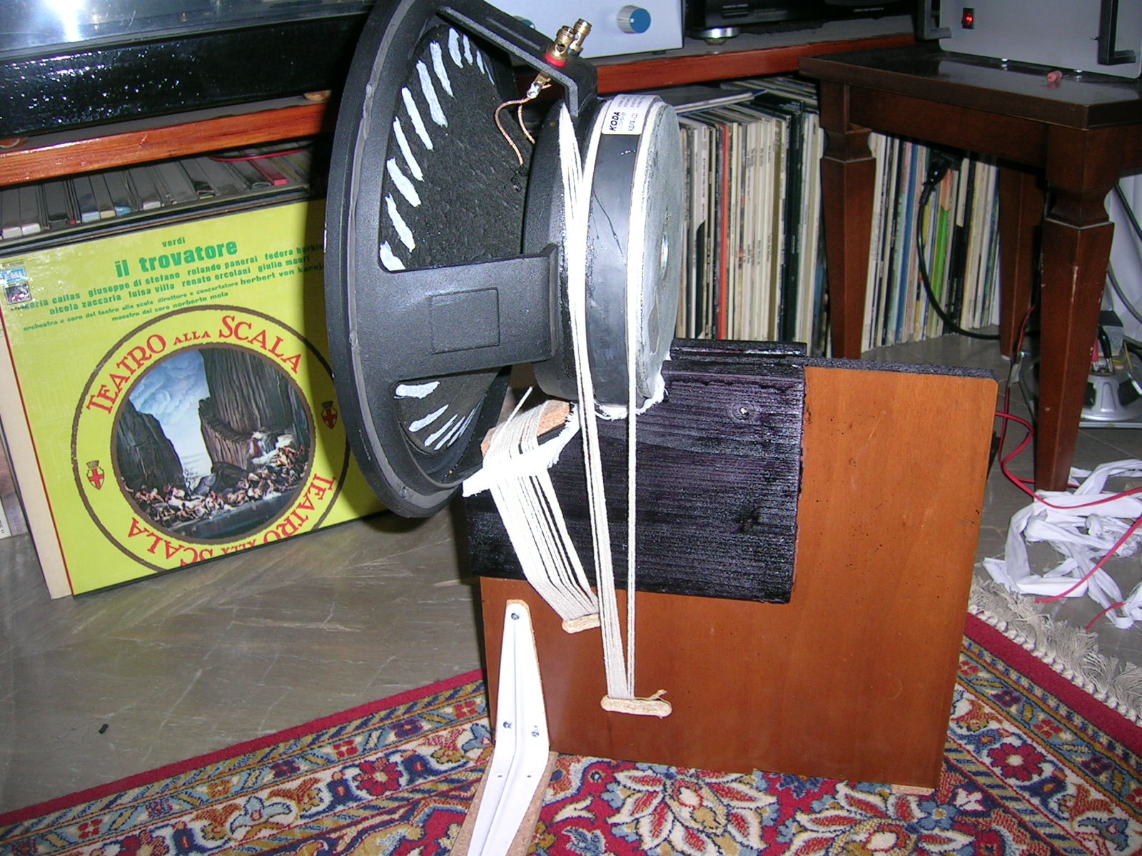

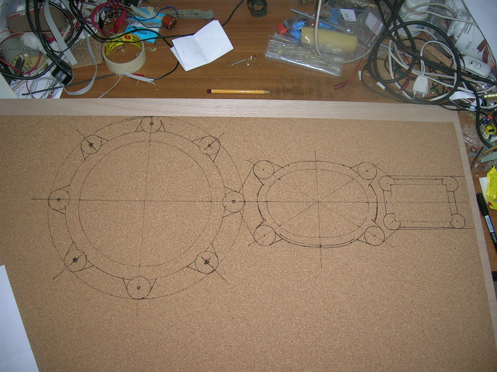

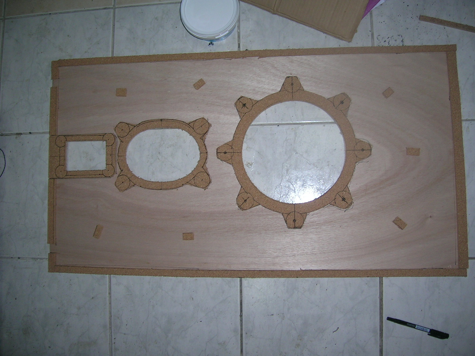

OB panels made out of two 8mm thick plywood panels, spaced 8mm apart with flanges made out of cork, glued with white PVA to the plywood. Empty cavity filled with dry sand.

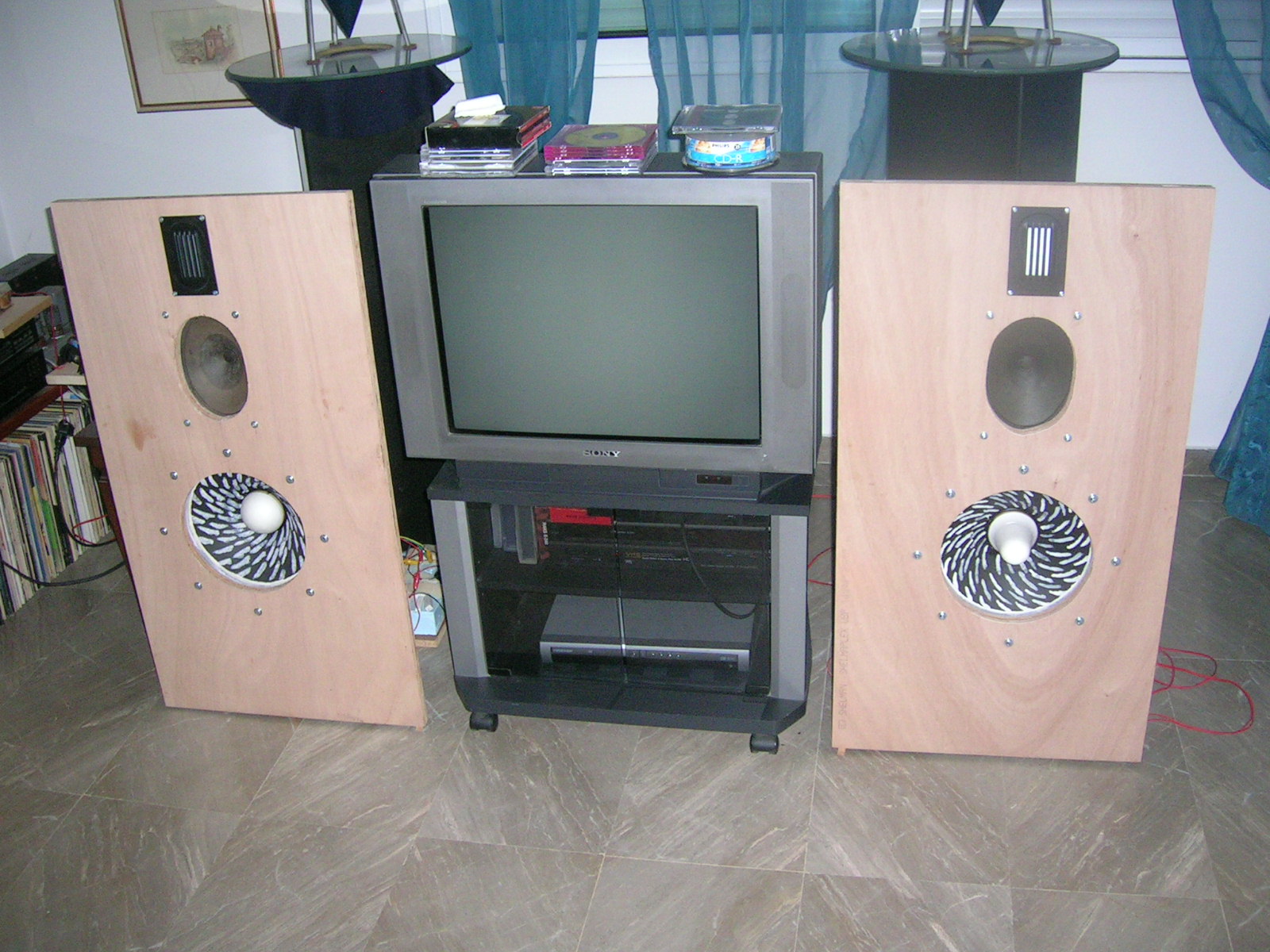

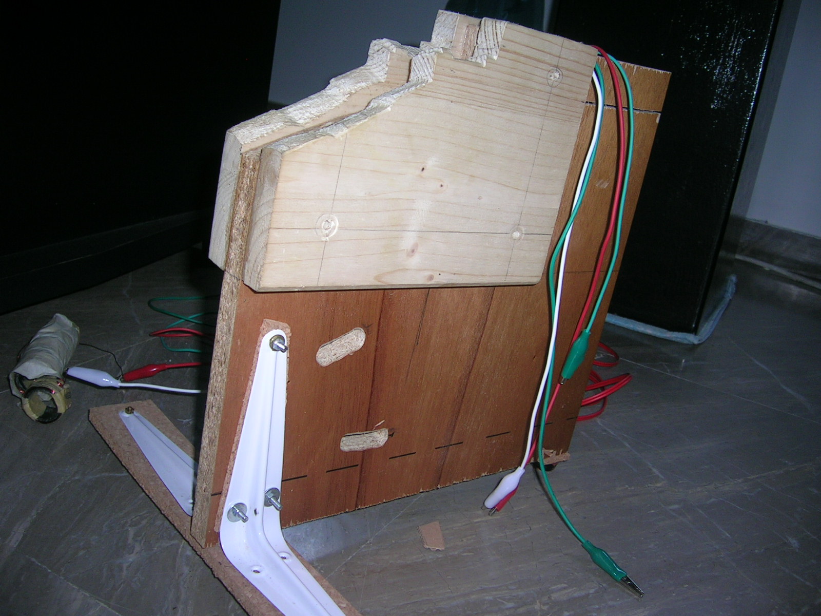

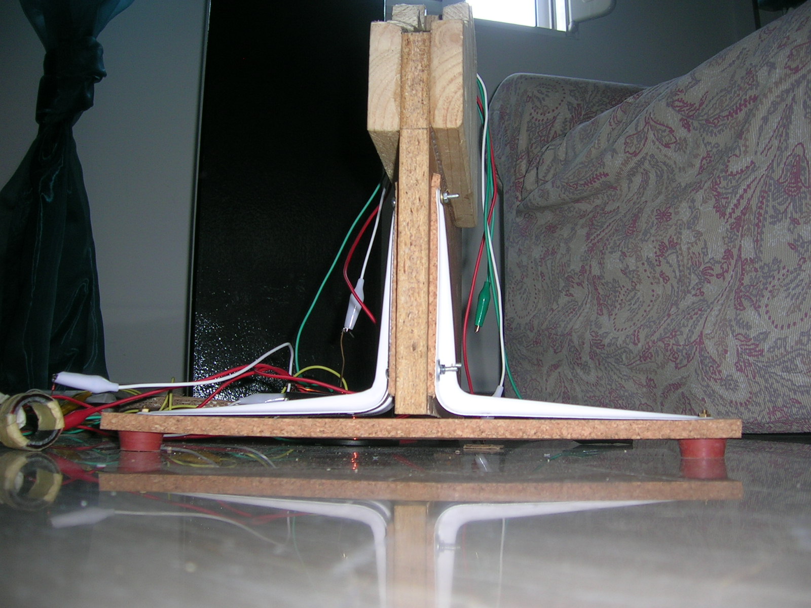

The panel is attached to the woofer rim by 8 bolts and sits lightly (balances) on the floor through a small piece of cork.
The woofer is supported on the floor by it’s own stand.
The full range elliptical unit and the tweeter are bolted on the panel.

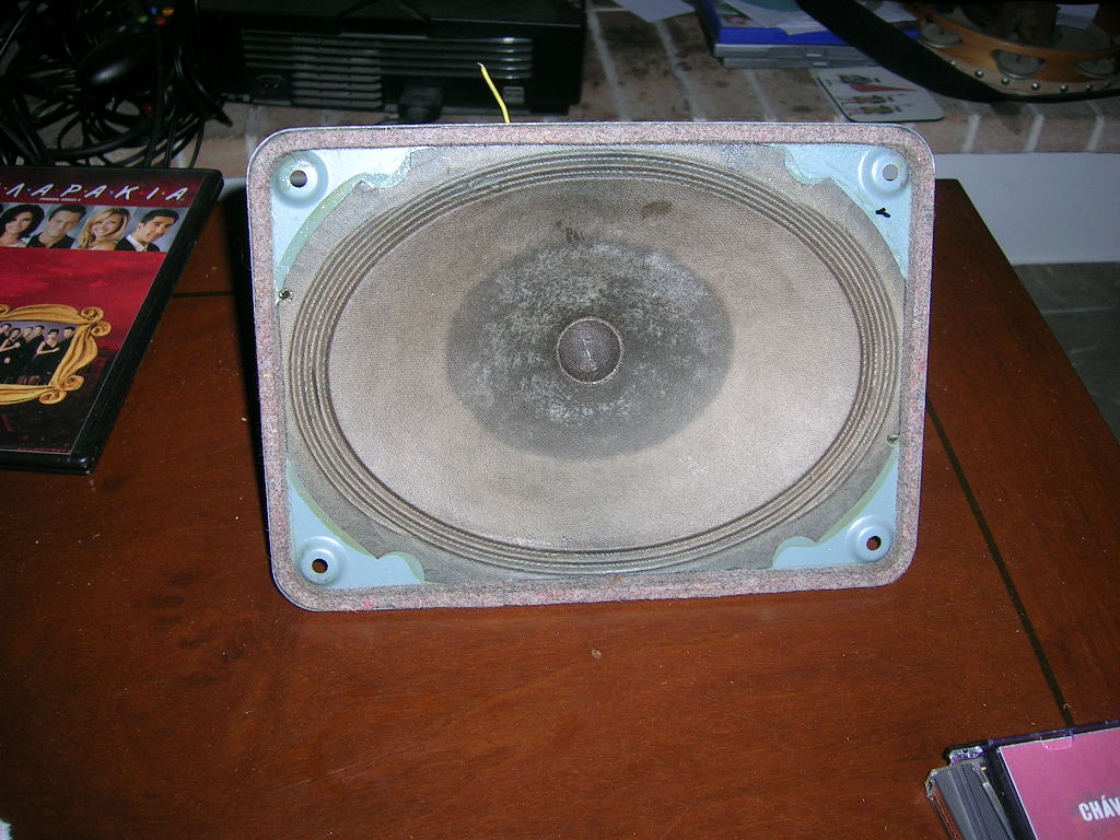

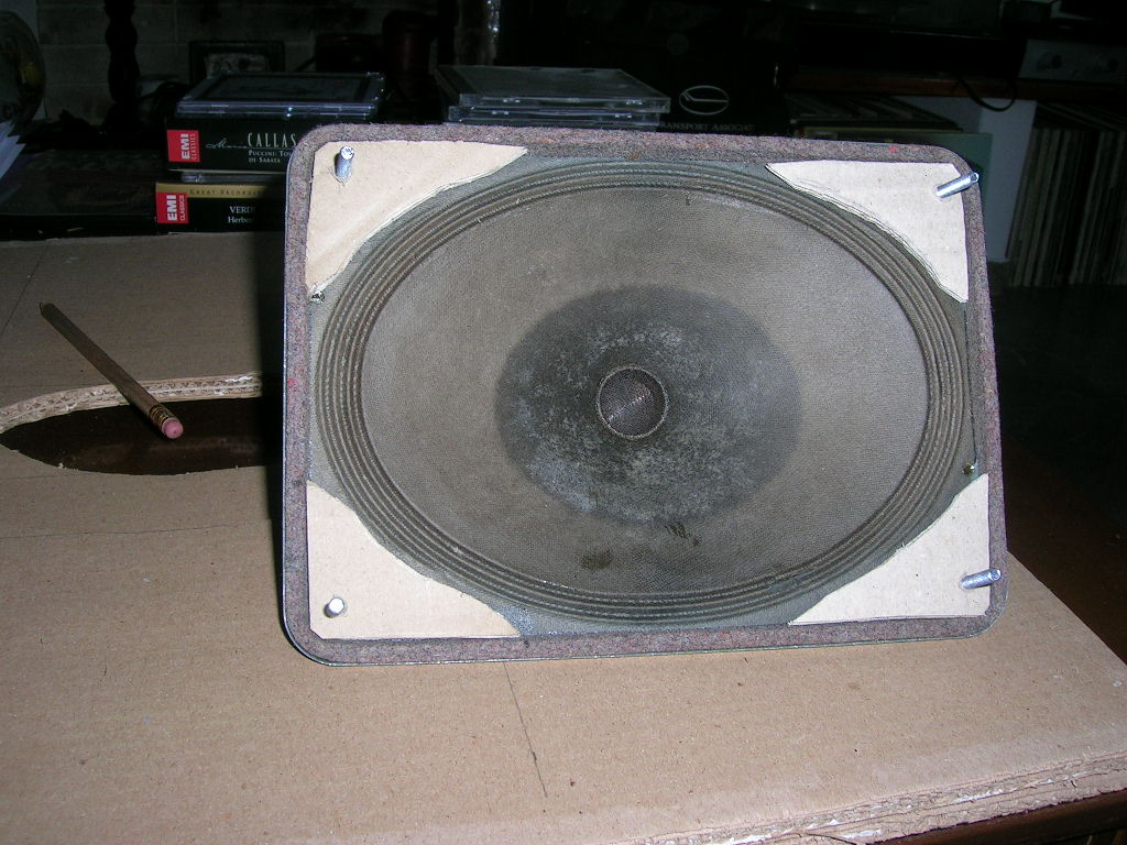

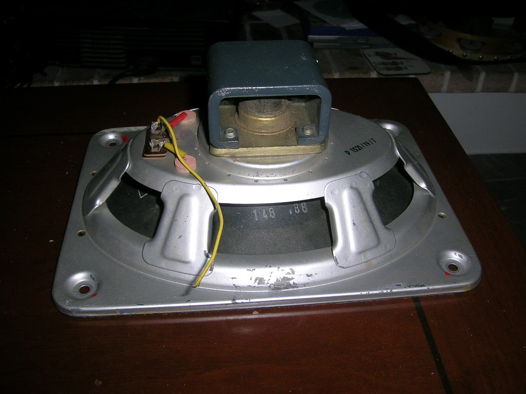

Shoog is particularily enamoured of that isophon. All the ones i've seen (and have) have been in the co-axial form.
dave
Hi Dave
Mine are not coaxial (they used to be fitted in a Blaupunkt radio/turntable console from the 60s) 🙂

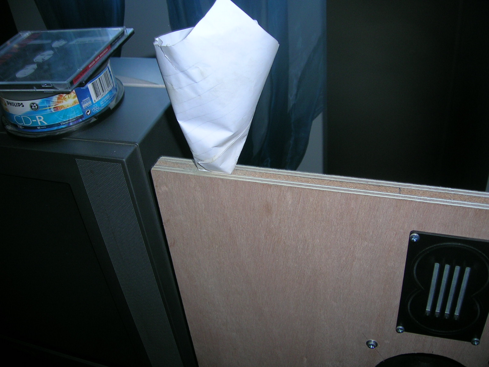

Those baffles should have interesting performance.
They are much more neutral (acoustically) than the pine wood panels (boomy!), but they do not achieve to (acoustically) disappear as much as the panels made out of roll package paper

Great work. This kind of insulation I like. But there is a much more easy way to realize this.
Therefore you need also two 8mm thick plywood panels
The first step is gluing a frame along the outer edges of one plywood panel and some four square cuts in the same thick than the woods for the frame.
The next step is filling dry sand with a grain size of about 0.2-0.5 mm possibly mixed with lead shot. Please note, a bit more than the chamber size.
Now the second plywood panel closes (about gluing) the chamber with the dry sand where the sand is pressed a bit (third step).
The last step is the exact cut into the framing (of course, after the curing of the adhesive).
In this kind you can also create the the footprint parts in a hifi rack for the audio components.
My english is not so good, thus not all details I can explain in great detail - but I hope, the basic principle is to understand.
