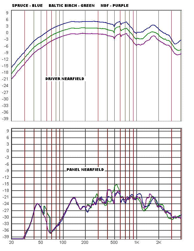

Without further ado... the results:

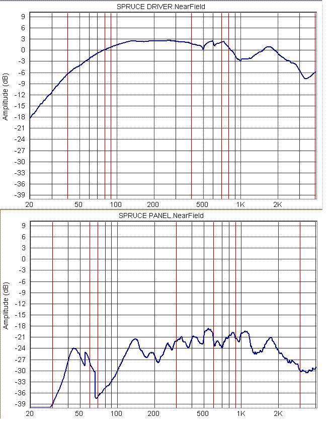

Box #1: Spruce sheating. Probably the least suitable material for speaker construction. Warped, rough, full of voids and knots. Not particularly strong or stiff. I included it here to put things into perspective. How does such an obviously inferior material measure up?
The chart on the top shows driver nearfield mounted in this box. Compare this to the chart posted earlier from Vifa. Not a bad match, considering the driver is mounted in a small sealed box.
The bottom chart is the panel nearfield measurement. Note the dB levels of each chart, the highers peak in the panel measurement coming at 500-600 Hz, not quite reaching -18 dB.

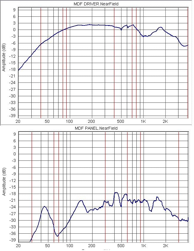

Box #2: MDF. Much maligned by Dave as being a life-sucking material that will bury all of the sweet low level information in the music by emiting a steady stream of noise. Surely the deficiences of this material will immediately apparent?
Once again the charts, top - driver nearfield, bottom - panel nearfield. The strongest peak for this material is actually 2, between 400 and 600 Hz just slightly exceeding -18 dB. Several re-tries of this test yielded the same double hump result. Still, at 21 dB below the peak output of the driver it's debateable whether this will be heard.

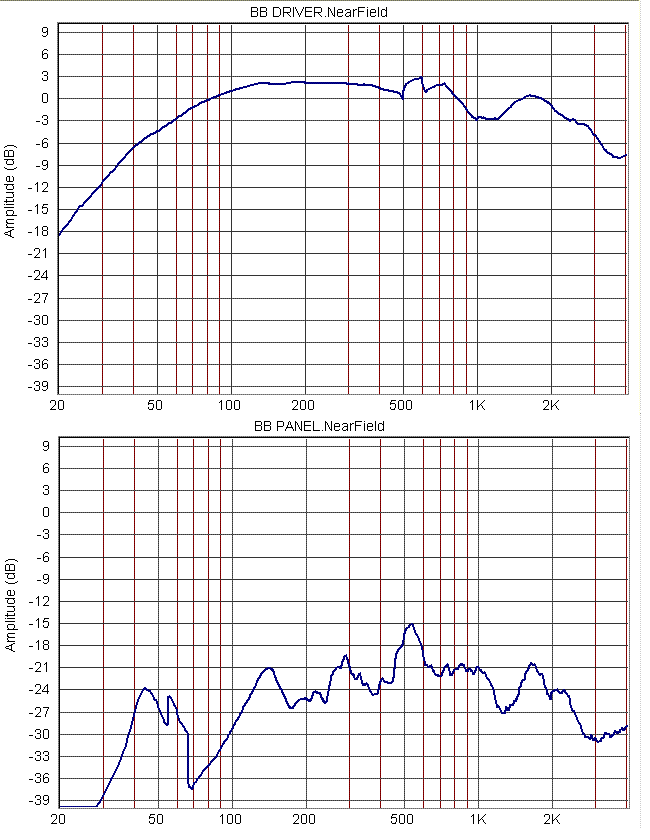

Box #3: Baltic birch plywood. According to some, the ultimate material for speaker construction. Highly regarded by all of us for it's superior strenght, stiffness, and sonic qualities. This will annihilate the other contestants!
Finally, I get to show what a premium material measures like.
The charts, as before, top - driver nearfield, bottom - side panel nearfield.
Disappointed? I was surprised to see that there was not much of a difference between this and the others, and in fact this test worse, consistantly hitting the -15 dB mark. I re-tested several times with the same result.
Conclusion: based on the tests, the difference between materials as far as sound colouration goes, is minimal. If my test equipment cannot detect a significant difference, then how will the human ear? Indeed, based on the results, we should all switch to cheap spruce plywood, as this had on average less noise output.

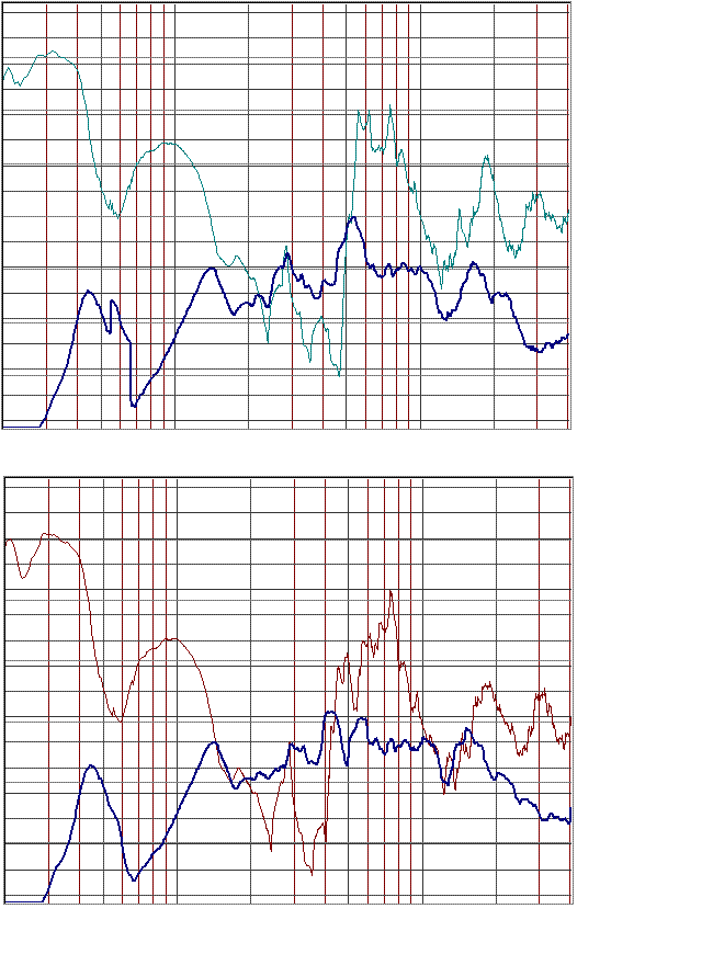

The following chart shows all of the results for each box colour coded and put together for critical comparison.
Remember that during WW2, it was proven that you can hear up to 30db down into noise, and so all those boxes would be audible.
I suspect that the 'suckout' between the two peaks for the MDF, and the Spruce ply are what we hear. This implies a phase issue with the resonance, and most likely an inversion. That inversion will literally 'suck' out the music at that point. The BB doesnt seem to suffer that suck out, and whilst it may have an audible sonic signature, it is in phase, and so doesnt produce an obvious dip.

I agree with Owen, those dB are audible.
Now the measurements showed little variations, that confirms Moriyasu accelerometer measurements.

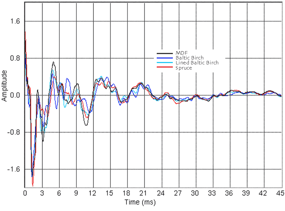

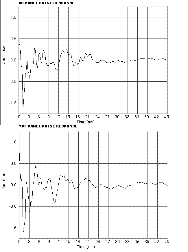

As follows are the impuse charts for baltic birch and MDF. As can be seen, not a wild difference between the two. MDF has slightly higher peak amplitude within the first 12 ms, but quickly settles down. Decay time seems to be the same.
Note: Plot has been 1/6 octave smoothed.
Here is the pulse response for spruce, with an added bonus - pulse for the carpet lined BB box before I had to tear it all out to test the untreated panel.
Once again, spruce is looking pretty good, with overall lower amplitude than MDF, but with a sligtly longer decay time.
As can be seen, lining the panel with my carpet had next to no effect on amplitude or decay time. This was unexpected.

FR doesn't tell us much. The impulse response should tell us more, but the results are hard to interpret.
Instead of smoothing, an average of a number of trials to reduce noise would give results that should remove some of the unknowns.
We also don't know how much of the impluse is panel & how much is speaker radiation wrapping around the panel.

How is that freq. response doesn't tell us much? It tells us what is available to be heard, and at what frequencies. The impulse results are what they are. My equipment, though not professional, is very accurate.
As for smoothing, it's necessary, as I am using a large sample size (132K) and there is in average - I have the repeat count set to 7. That's 7 times the sample rate averaged. I also ran the individual tests 3-4 times in a row to make sure the results are consistant.
Wrap around from the driver could be a possible influence, but as mentioned earlier, attempts to block it's output were of little impact. Mic placement for the panel impulse tests was less than 1/4" from the panel. Similar test for the driver at that distance and sound level would be off the scale of the chart.
