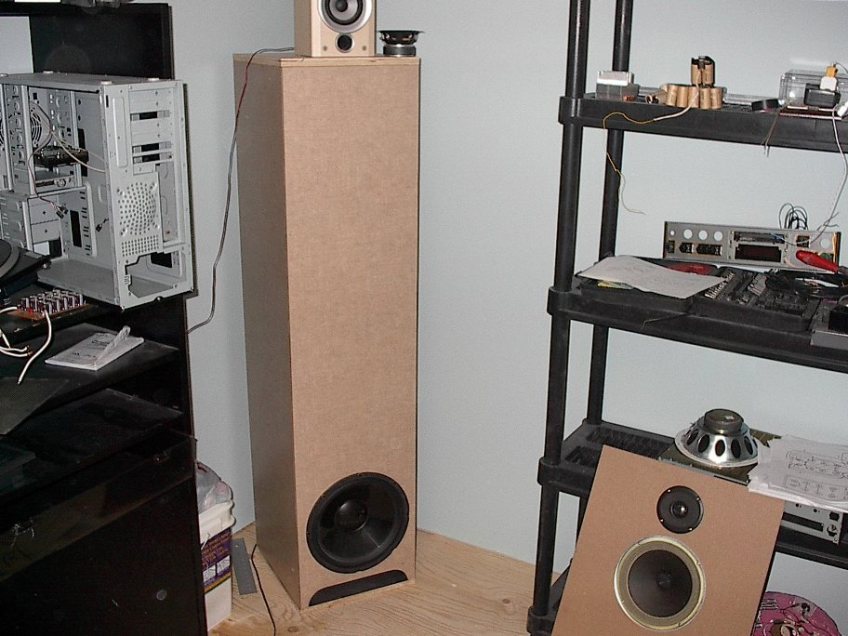

I attempted to block the output using a towel draped over it. It really cut down the output (by at least 60-70% approx) but made next to no difference on the panel FR results. They still hit the -18 dB mark. For this reason, I didn't think the drivers output had a large effect on the panel test. Also, with the towel, I didn't want the added variable of it's random movement against the speaker cone to muddy the results.
Only practical way to completely take forward cone output out of the equation, is to build a large, open ended, heavily stuffed box and mate it to the test box to dissapate to output. For my homebrew tests, I thought this was overkill.
I could fire them into the big thing in the corner. Take out the 12, add a bunch of stuffing:
